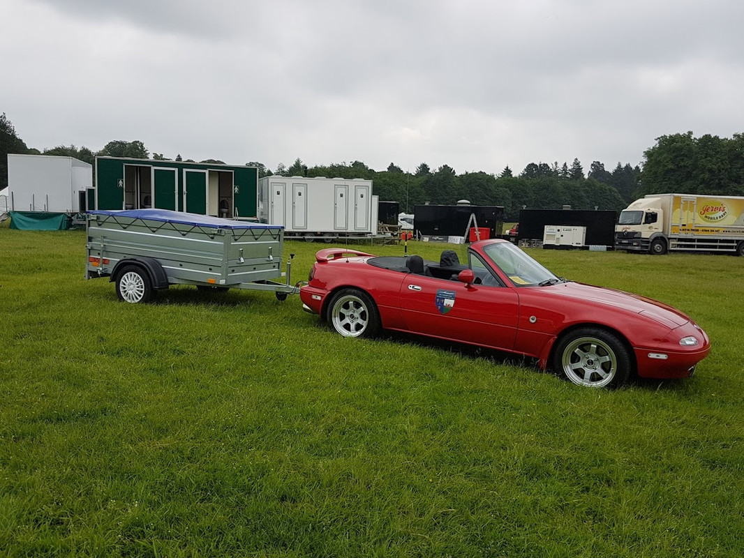

But no need to make your own they can be easily still be found, new or s/hand, I do have a spare but it is spoken for, sorry bud.
Been hitching up a trailer to ours when needed since starting with these little gems, dragging tools to shows ,rallies,meets and tech days.
If your stuck get in touch buddy, we know our stuff.
