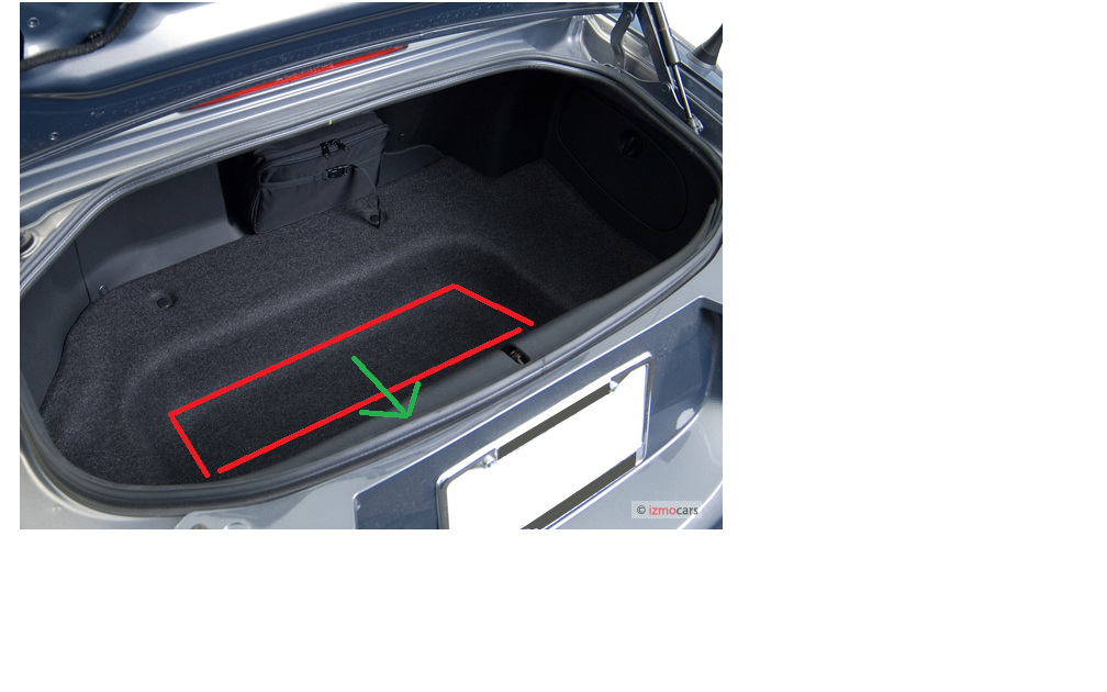

Thanks for the helpful reply all - I think I MAY have found the cause of the ingress (I had a poke around at lunchtime). Without pictures it’s hard to describe, but it looks to me like there is some kind of recess in the boot (in the same position as you might think a number plate fixing would be) that is leaking.
I fail to see how water from the outside is coming in through this hole, so I could be wrong, but that was the only bit that was wet and the clue was a dribble of water coming from this hole.
I will post up photos when I get home and provided there is sufficient light of course.
EDIT - OK, let’s try this. Not my car - a stock photo I nicked off Google. The red rectangle is where the carpet is soaked. The green arrow roughly indicates where I found this ‘hole’ (which looks like it should be there - it’s not corrosion!)
I can probably guide you in someway with my experiences with my PRHT I found mine had a small leak to in a similar area, mine was in fact the extractor chamber behind the light cluster, additionally I noticed a small leak from the boot lock itself so got that sorted.
As others have said there are a fair few places in these that can cause leaks my suggestion strip the boot interior down, dry the boot then test it strategically from left to right or right to left making sure you go over the gaps of the fuel cap in between the gaps of the light cluster and boot itself across to the other side.
It took me weeks to find the extractor chamber leaking on mine, only one day when I had it stripped down for the final time had the hose out and thought sod it, boot apart and just ensured plenty of water went over the light cluster bangs your uncle it leaked. if you are brave and use an open ended hose with no attachments on then keep the boot lid open and carefully guide it over into the boot lid channels specifically where the bumper meets the back of the car with two screws as a water does get channelled down there (the specific point where I found mine leaking.
