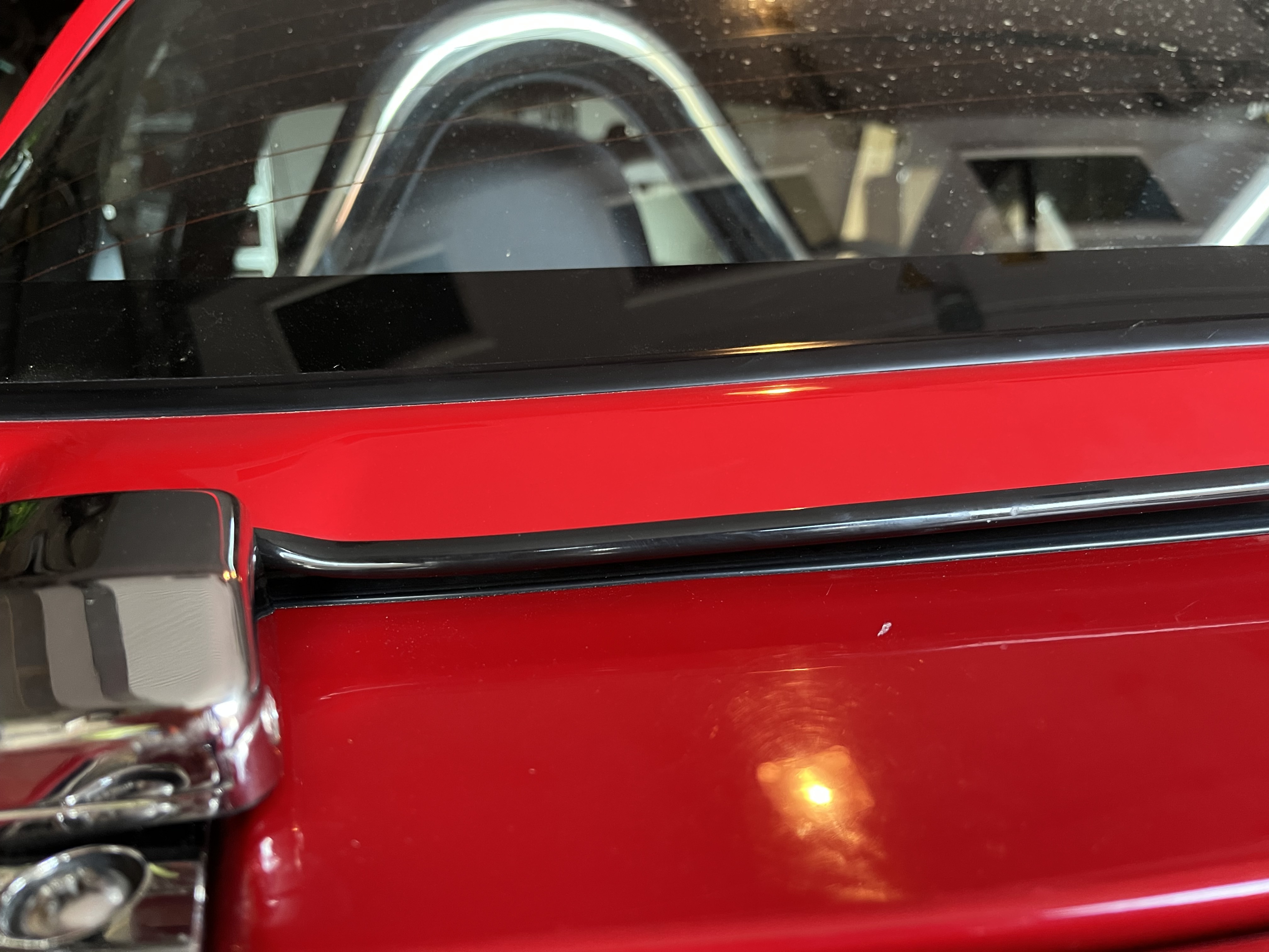

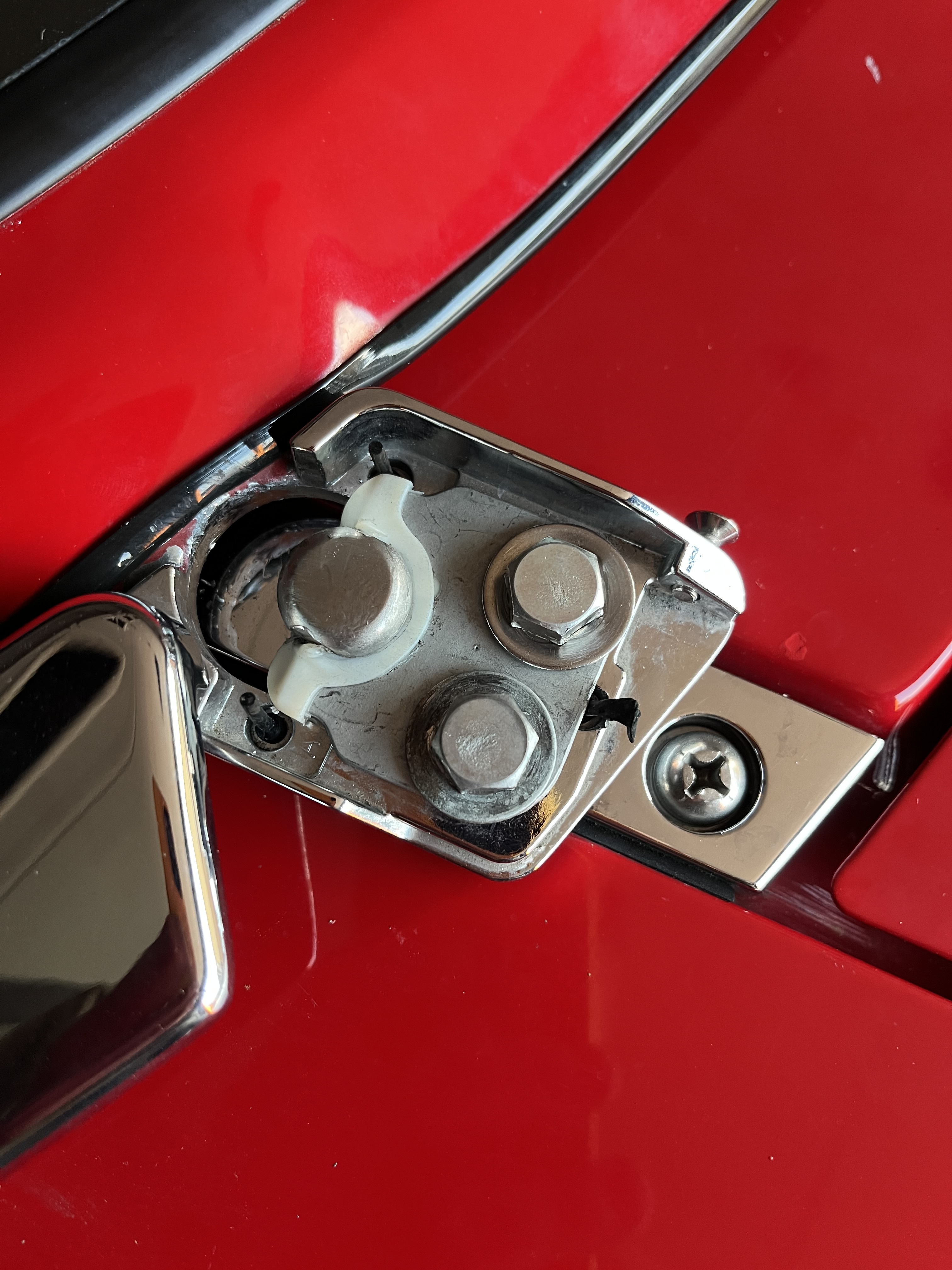

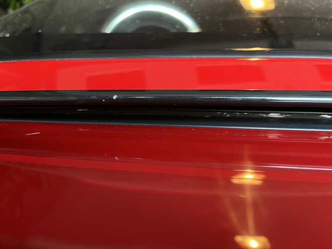

I recently started getting a weird creaking noise in the back of the hard top (see pictures), and after changing the weather strip and adjusting the top it still comes back. I believe it might be the body hard rubber seal rubbing against the new weather strip’s hard lip.
Am I supposed to push the hard top even further forward? Is this common?
It is really annoying cause it sounds like I’m sailing in a wooden boat.

Problem solved! It was those stupid bolts that go to the rear glass. And maybe the seal back there too. I smothered both with silicone spray and left it overnight. So far, no more noises.
