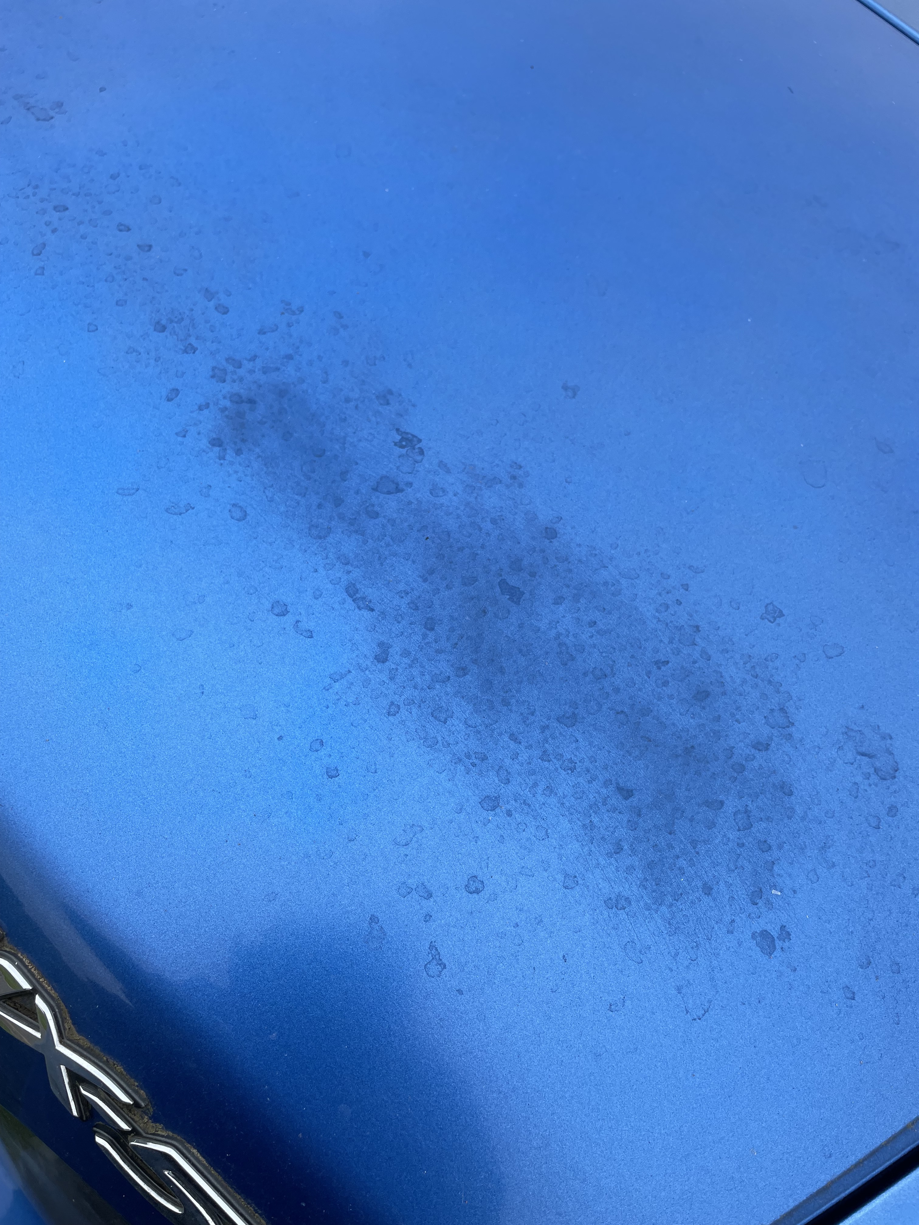

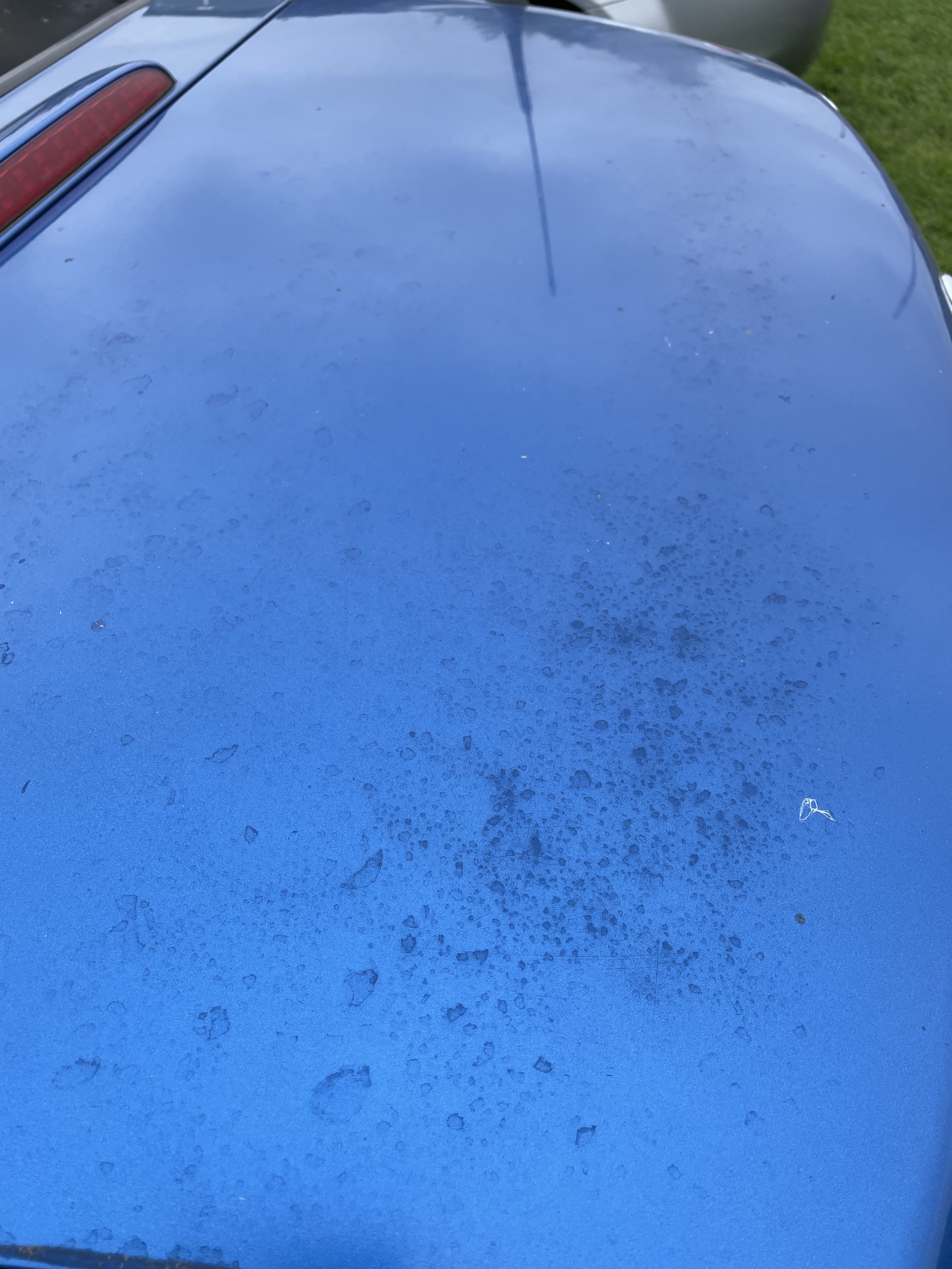

Weird paint marks on boot lid
Does anyone out there know what caused these marks on the paint on my boot lid? And how I can restore the Winning Blue paint here to its former glory?
Thanks
Some of it at least looks like it might be hard water spots with some impurity in it; Saharan dust, extract of volcano, manufacturing factory fall out etc. mixed in with Oxfords notoriously hard water. Maybe.
You could try a water spot remover (Chemical Guys) in the inconspicuous area of choice to see if that helps, if not then maybe a polish/paint correction, if your paint is up to it.
Many thanks. Will try the Chemical Guy stuff, see how it goes
