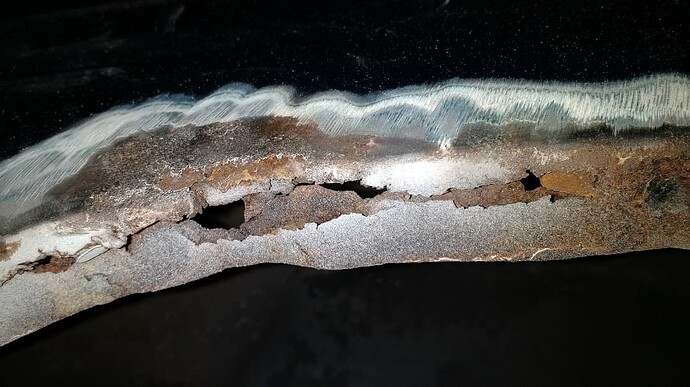

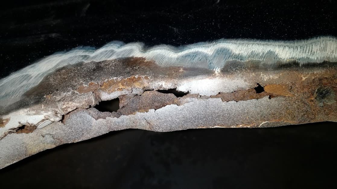

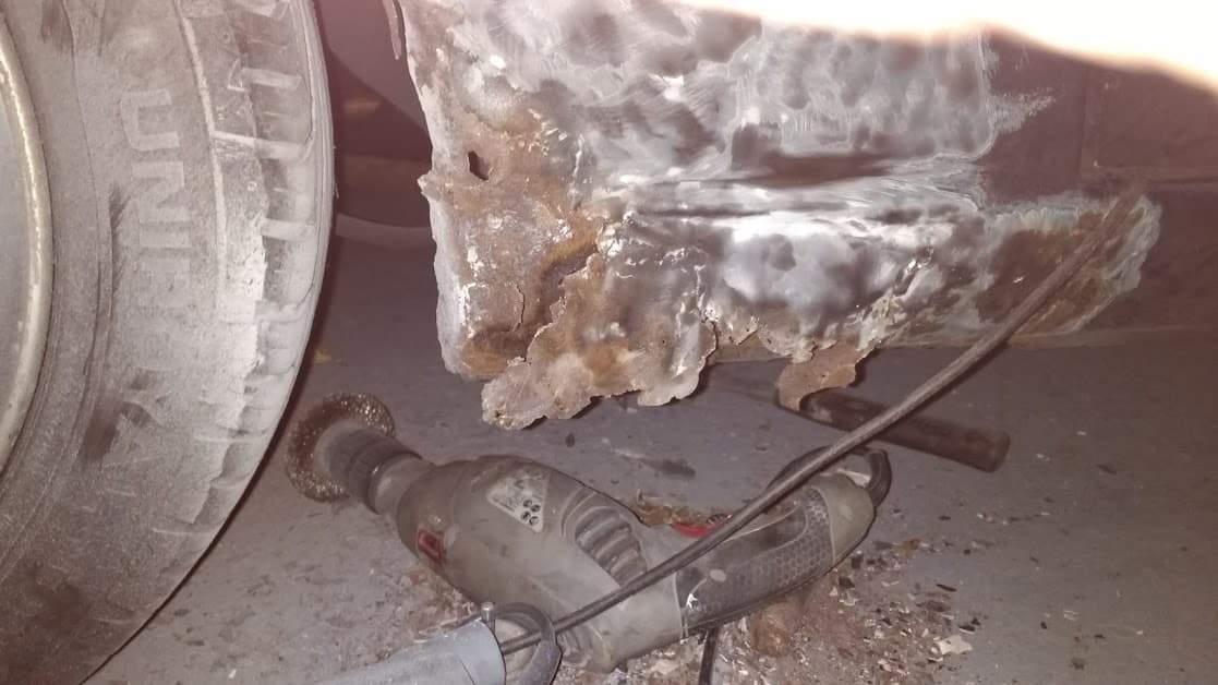

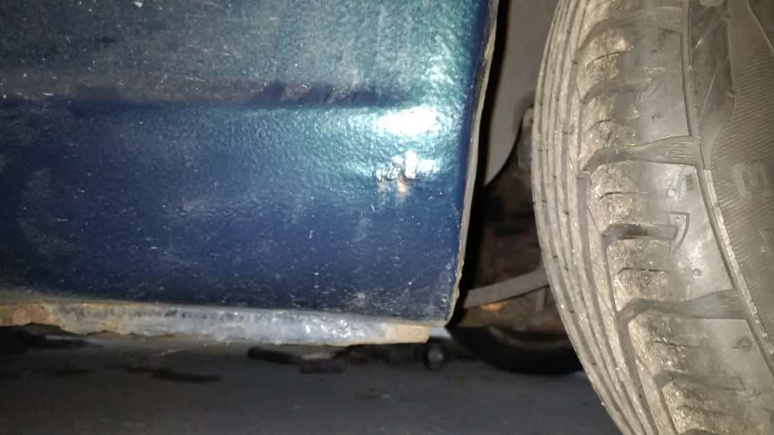

On my 1996 S-Spec, there was bubbling on the drivers side, and I had the car booked in for sill and arch. I kind of new what to expect, as a few years earlier, I had a “cosmetic” repair done. I decided to attack the area with a wire brush to see how much metal was left. It was horrific.
A suspicious looking small (0.5cm long) bubble on the arch was attack. As I expected, this opened up into a hole
On the other side, there was an old plated repair to the sill; to be honest, it all felt very solid, and I thought the small bleb in this case was surface rust on the repair. But once cust back, the repairer remarked he actually had to do more work to that side than the drivers side. I think the old repair made things worse.
