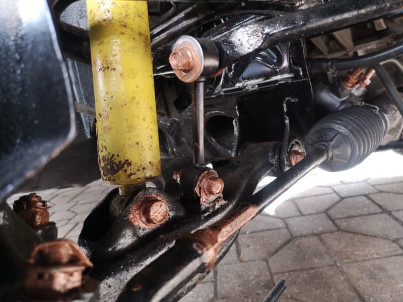

Recently fitted the zeta crd’s and it has made a huge difference in ride at all speeds. Worth every penny. Cheers for the install guidance Mm…
Glad it helped buddy , just out of interest,which one? the vid or walk through.
Get some 32mm penny washers on these drop links, S/S if possible on the top outer on the sway bar, it will keep the bushes in place better front and back of the Roadster.
M-m
Am gratefull you took the time pal, it was this one mostly… Meister R Zeta CRD Suspension installation guide - Mk1 MX-5 - YouTube
Excellent step by step. I struggled with the pins on the castle nut. They were on for 105k though. Everything refitted got smothered in copper grease too. On those drop link washers * have looked them up and believe bolts are M10, i might just pick up a couple of sizes in case. Cheers again M-m
Washers ordered! Your very detailed reply is most welcome… Also ordered some more copper grease, it appears i have been largely unapplying that lovely stuff :rofl: Nice one M-m :+1:
