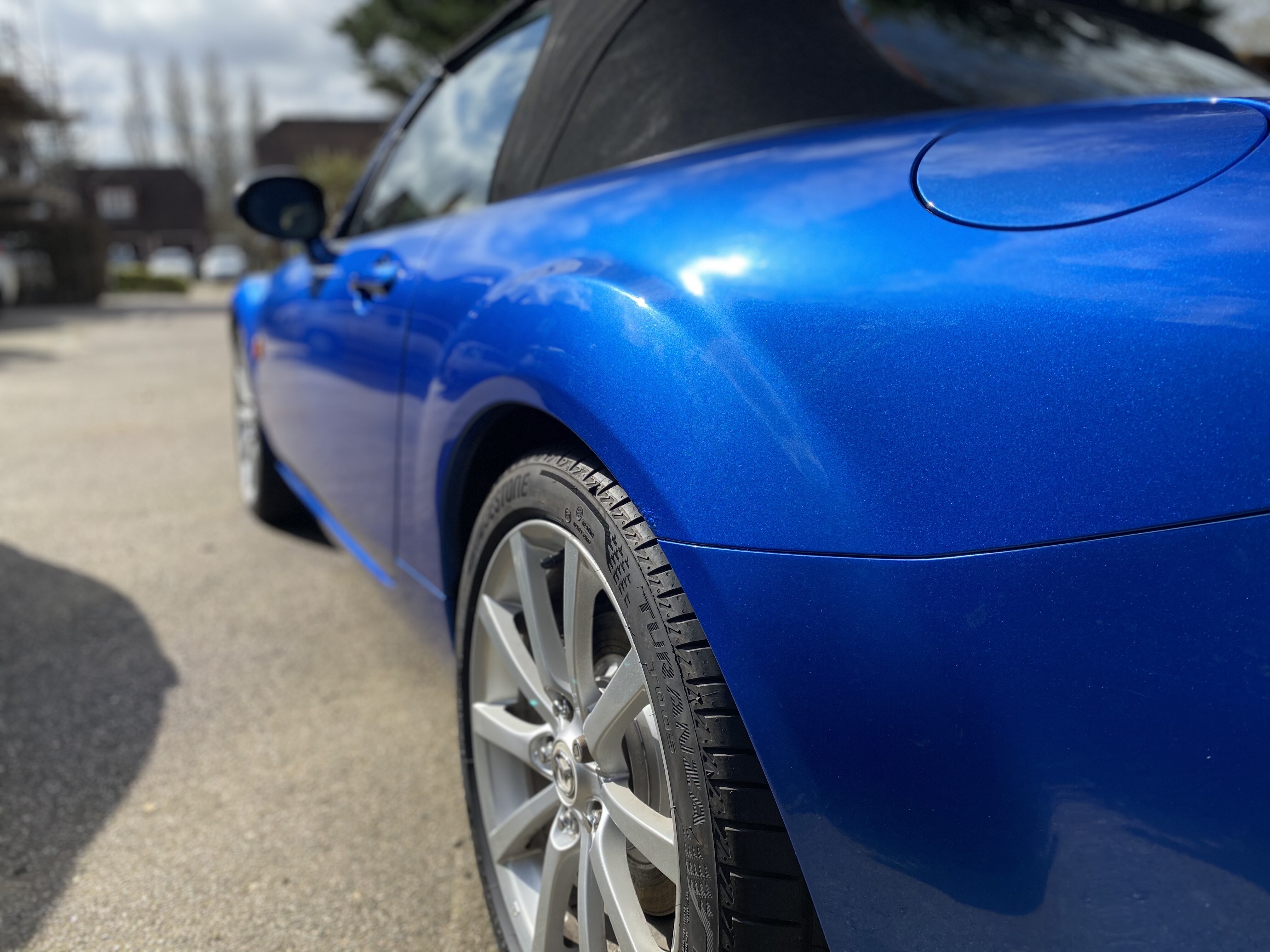

I run 215’s on my mk3 Sport. Bridgestone Turanz T005. Really good tyre in both wet and dry. Cheaper than the 205 equivalent and been a bit wider looks nice :grin:
Here you go.
