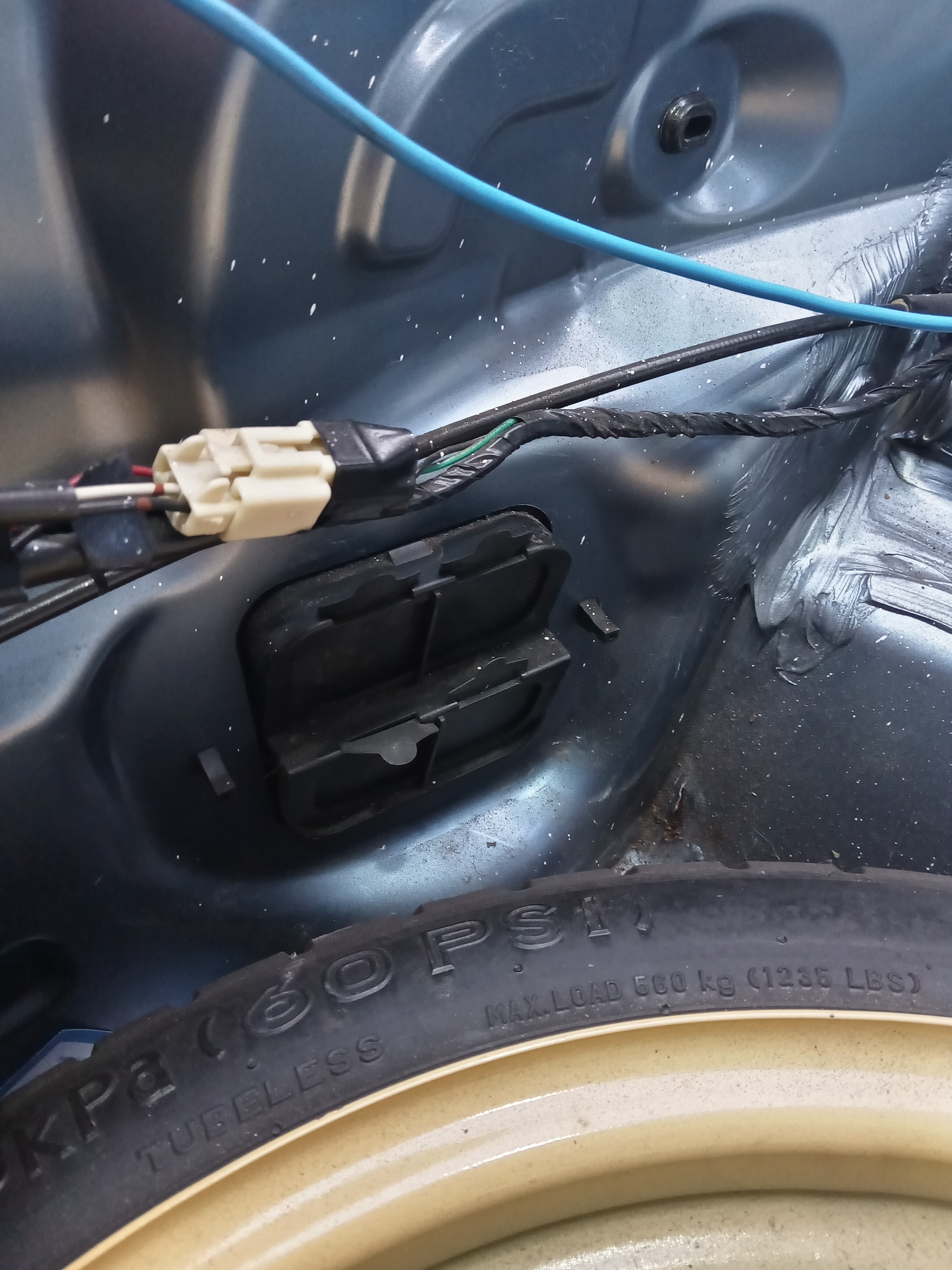

What are these little flaps for?

Just curious as to what these little flaps are for to the rear of the spare wheel well. Look like a cat flap for a very small cat. Presumably to let air out but not back in again when the heater blower is on? But why in the boot & how does it get from the cabin into the boot or am I missing something obvious?
They’re a very common feature on most cars, hidden so you won’t notice them and behind panels so you won’t block them.
They help to keep the car dry by guaranteeing an air flow through it.
The openings are intended to be at low-pressure points and also clear of mud from the wheels.
No2 Son has theses in his Golf boot and were stuck open allowing water/road spray into the boot.
The key word I used was “intended”.

Allegedly introduced by Ford in the Cortina as the airoflow system.
If the air can’t get out, it can’t flow.
If these can and do get stuck, maybe they are contributing to the road noise from the drains/noise ducts?
I’m pretty sure they are to let the air out when you close a door, and when you have fans in high but windows closed, somewhere for the air to go.
Good point about how does the air get from the cabin to the boot?
Maybe they are to reliever pressure when shutting the boot lid?
They are also useful for enduring your boot never gets more than half full of water which would upset the handling :grin:

Air escape for inside of car and don’t forget your fuel tank is in the boot, so helps dispel any fumes.
Could this be the answer to why the road noise is sooooo much worse with the lid up?
If the lid is down, the ventilation air is escaping to atmosphere and the flaps perhaps remaining closed,
With lid up, the air can only escape through the flaps, allowing the road noise through…
