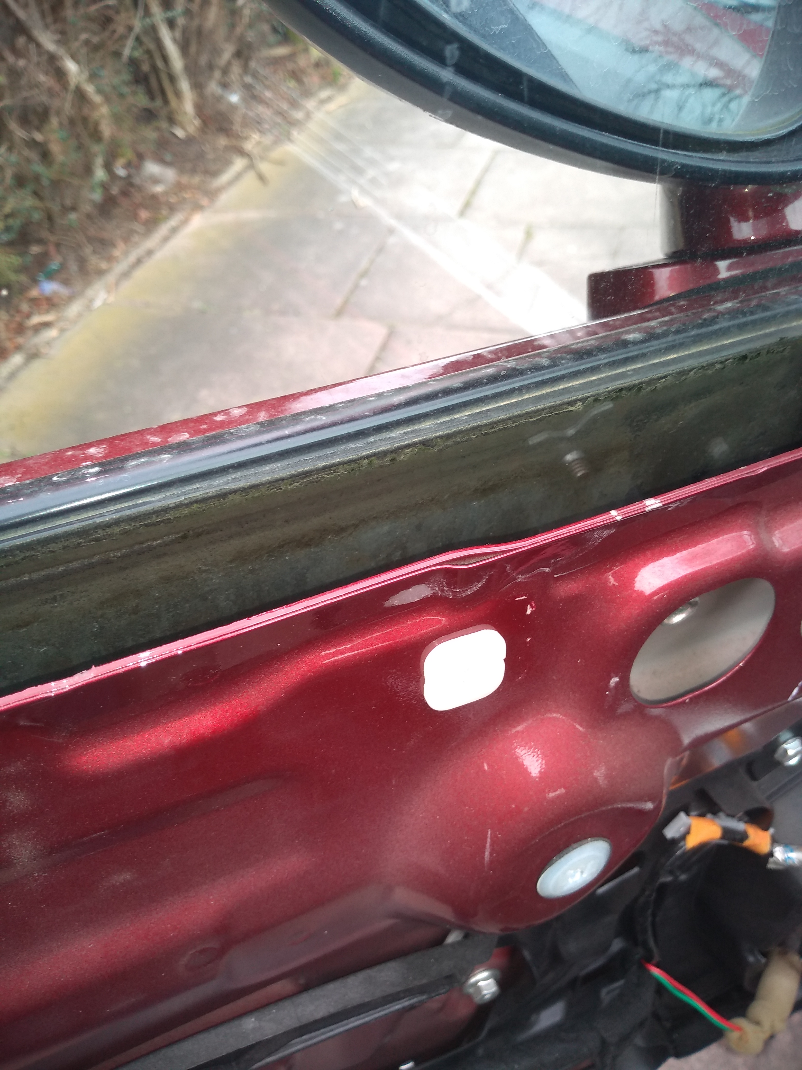

Just fitted these myself, a little fettling with emery cloth for perfect fit.
The door feels and sounds a lot more solid now when shutting, great value for money !

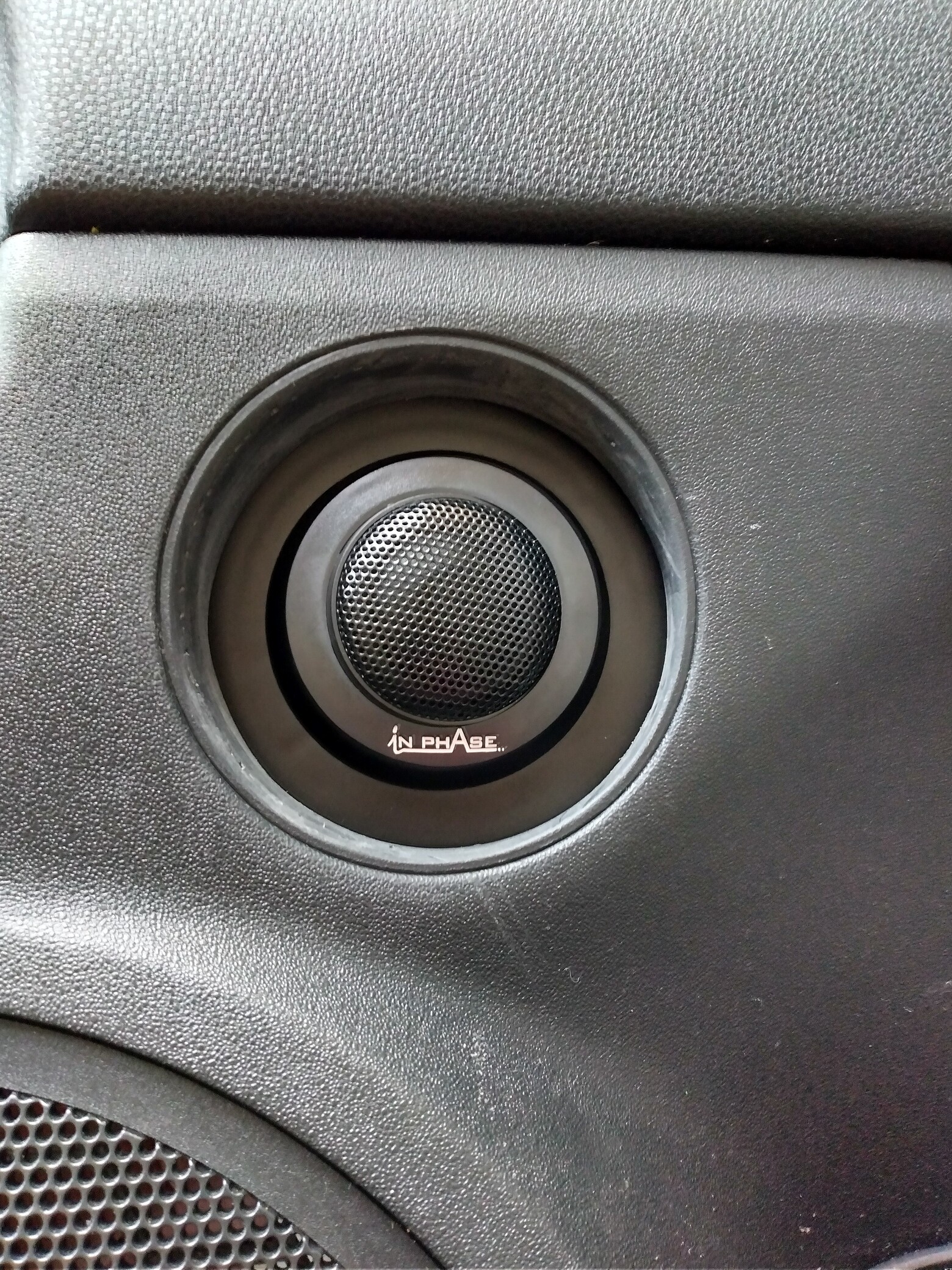

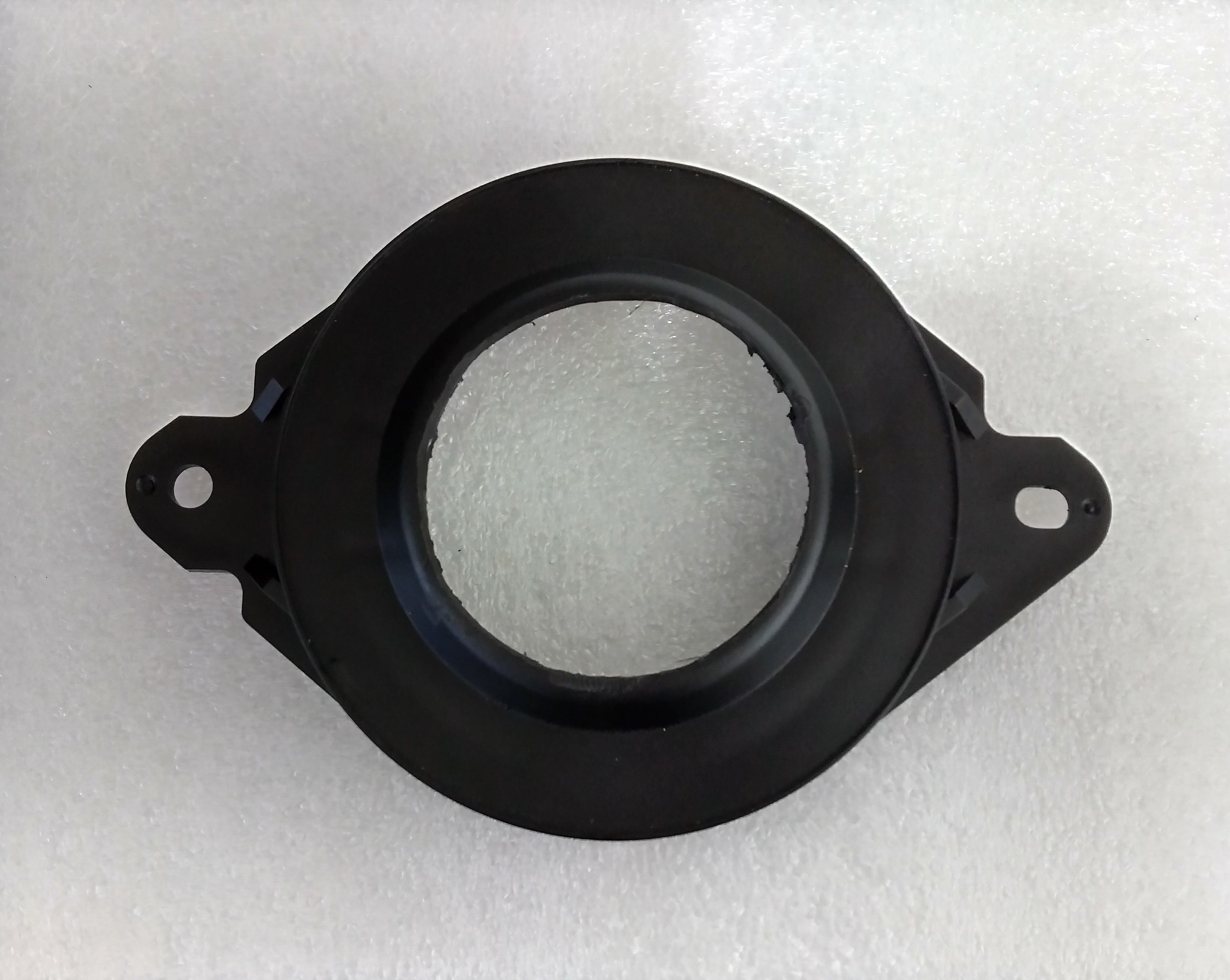

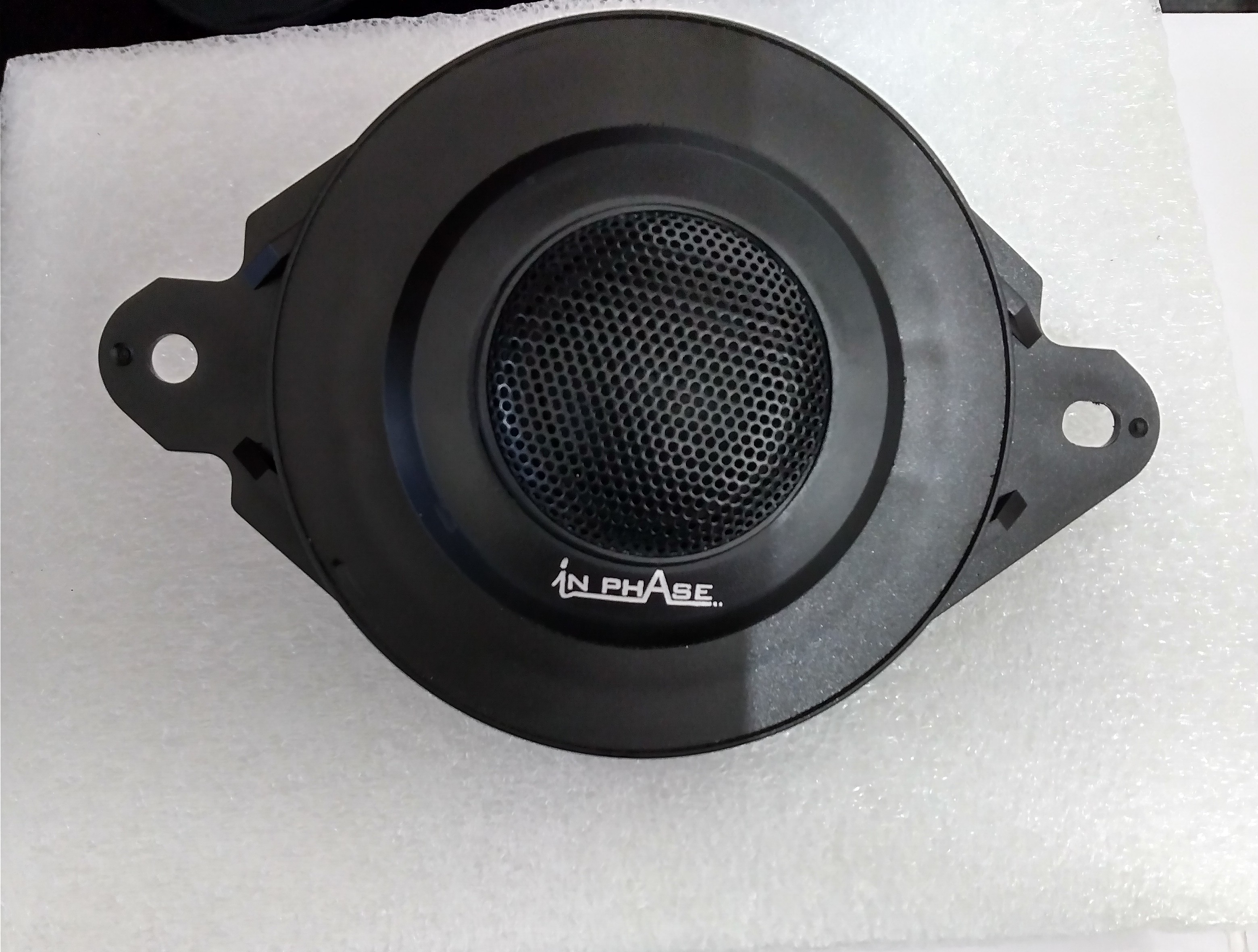

Removed original door tweeters, modified the housing to accept larger tweeter.
Cut mesh away from door card tweeter , sanded and trial fitted.
Still needs a little fettling with 320 grit to smooth out .
Yes, I did quite a bit of sanding to get the bushes to be a nice sliding fit in the cups.
I also had to make the slots for the bolts a little looser to allow the fit to be adjusted satisfactorily.
I don’t know how consistently manufactured the cups are and if the bushes could be manufactured to be a better fit in the first place but at least being oversize means you can sand them to a pretty much perfect fit.
These bushes appear to be 3d printed and are not beautifully made but they do seem to do the job.
Its a shame they came with no instructions but at least instructions for other makes can be found on tinternet.
One tip I would pass on is to leave a window open when test shutting the doors. That way you are not pushing against the air pressure you are creating in the cabin when pushing the door shut, so you get a better feel for bush in cup fit.
Once you have sanded etc for a good fit I reckon these are amazing value for what is achieved but I can’t help wondering if some more expensive cnc machined ones might be worth a try if they fit well from scratch.

Yep I needed to open the slots a little also

I was fully prepared for my 14.99 to be a total waste of money but I’m amazed by how well they work.
You do have to make them fit though.
I’m not sure how long it took in total, maybe half an hour per side but I was in no great hurry.

I agree that on an older car with body flex these bushes could stop some of the squeaks and rattles and possibly add to the structure stiffness. I think however, that I would be very careful about making them too tight a fit. As somebody has already stated the door bushes are there to ensure alignment of the door lock system in the event of a shunt and also ensuring that the forces are transmitted correctly through the structure. If the door bushes are too tight there is the possibility that any slight distortion due to a shunt will cause the bushes to bind in the receiver cup to the extent that it could make the door very difficult to open if needed in an emergency.
Indeed, which is why I went for a nice, sliding fit rather than an interference fit but I take your point.
I fitted some to mine & ended up with a load of rattles inside the door that weren’t there before so took them off again.
Did you sand to fit, make sure the bolts could move in the slots for adjustment and progressively tighten the bolts with opening and shutting the doors in order to align??

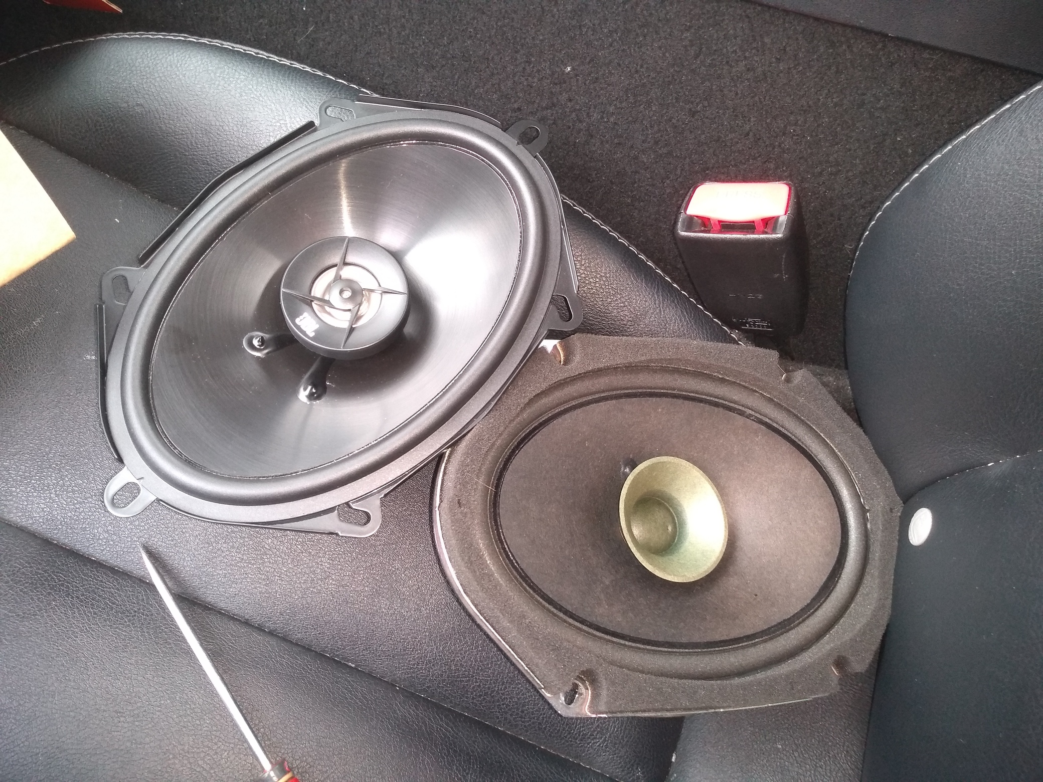

I fitted some JBL 6x9s They are rated for 60w rms.
Very easy to get the door cards off on the MX5 NC but the OEM speakers have 2 pin plug that doesn’t fit aftermarket speakers so got the wire strippers out and the soldering iron.
