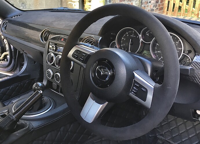

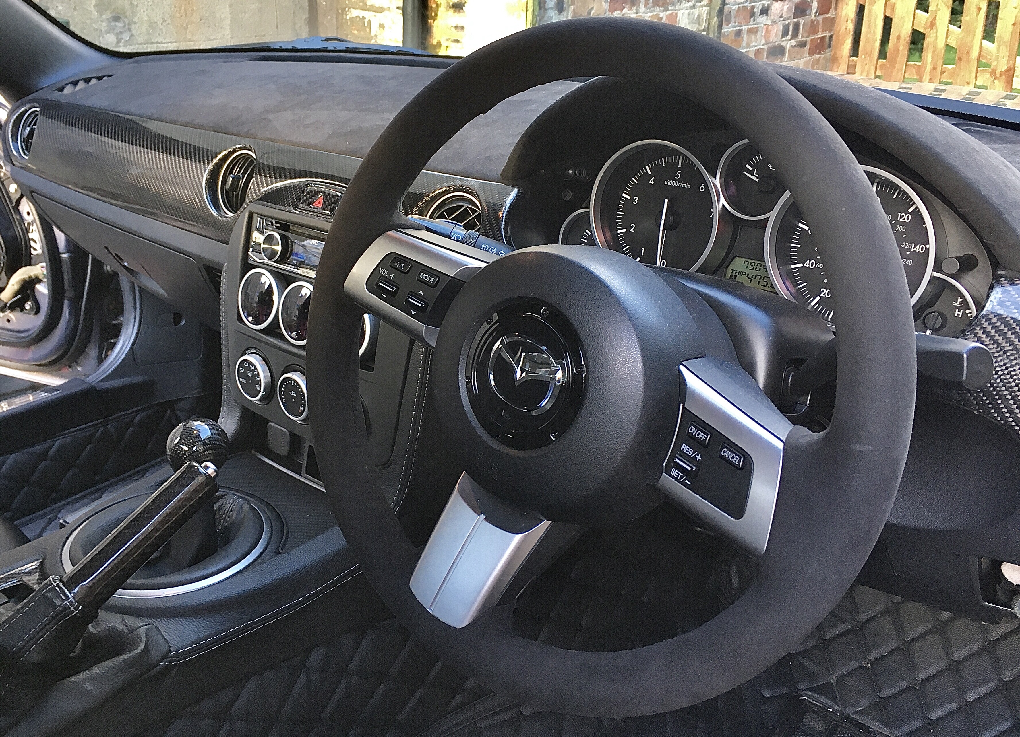

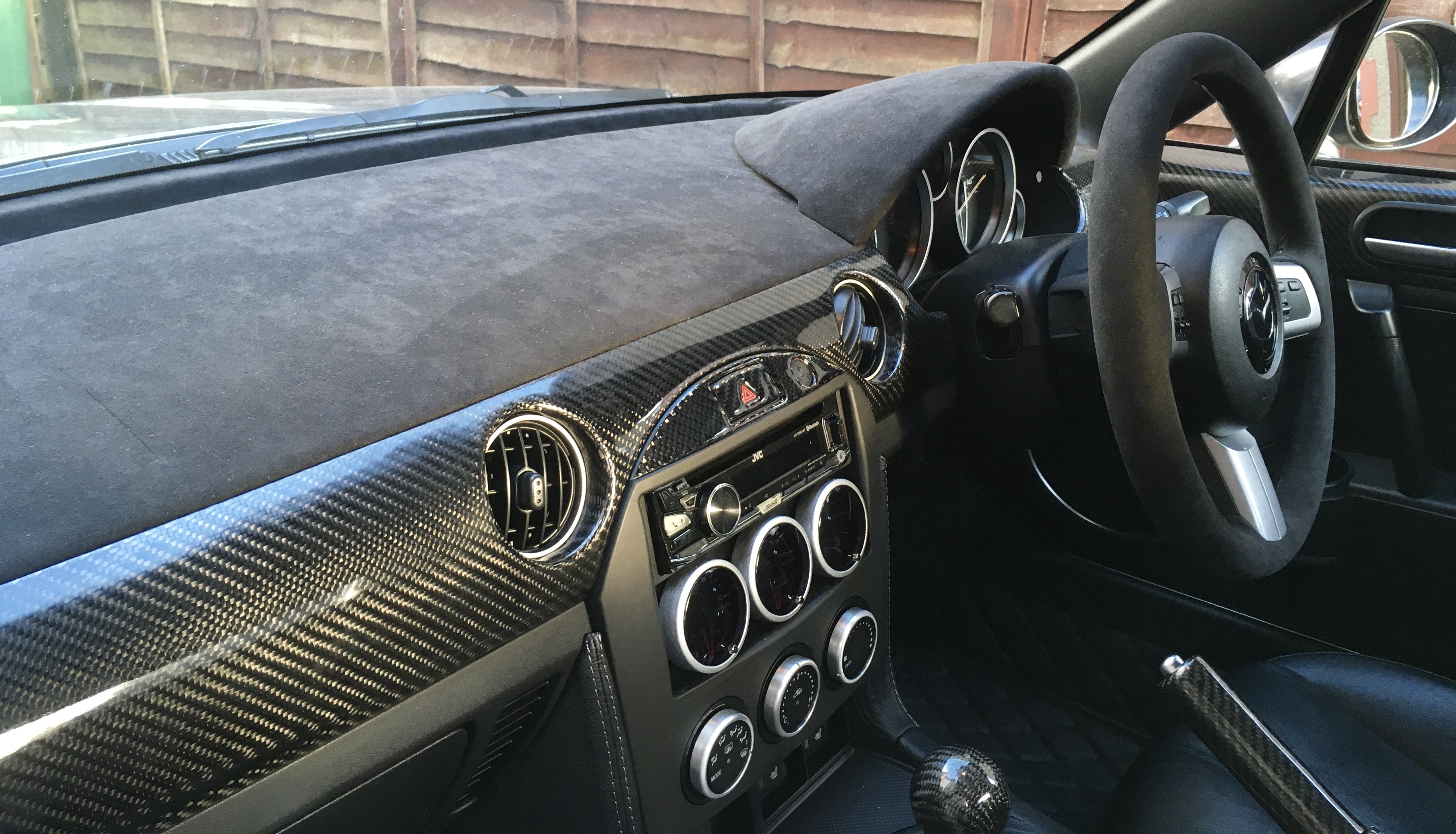

Covered the upper dash panel, meter hood and steering wheel in Alcantara, and the decoration panels in carbon fibre. Also fitted a carbon fibre sticker over the hazard light switch panel. While the steering wheel was off, I fitted cruise control buttons, ready for the aftermarket cruise control unit I bought last year. Hopefully fit that next.

Installed aftermarket cruise control. Fairly easy to do and works with OEM steering wheel controls.
