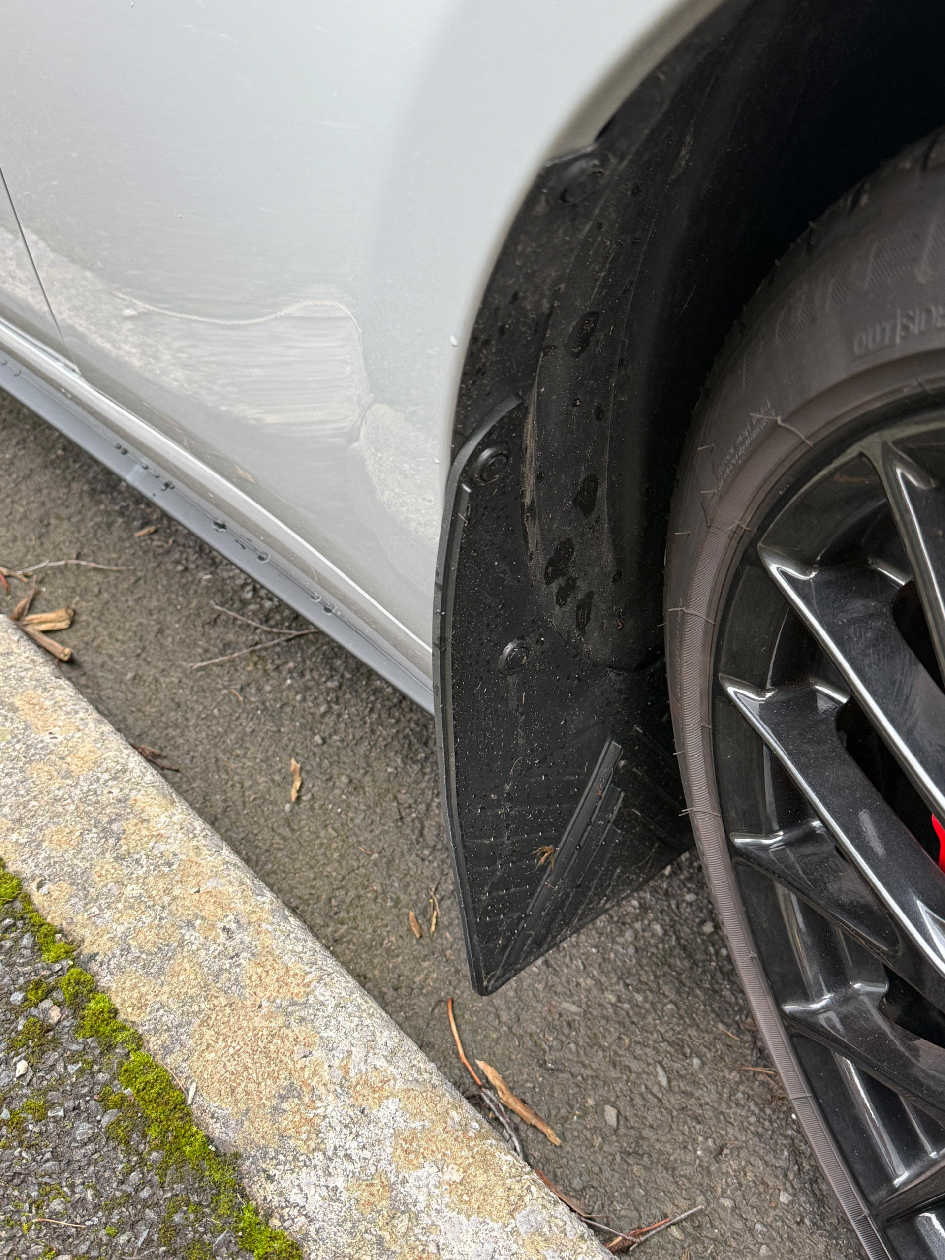

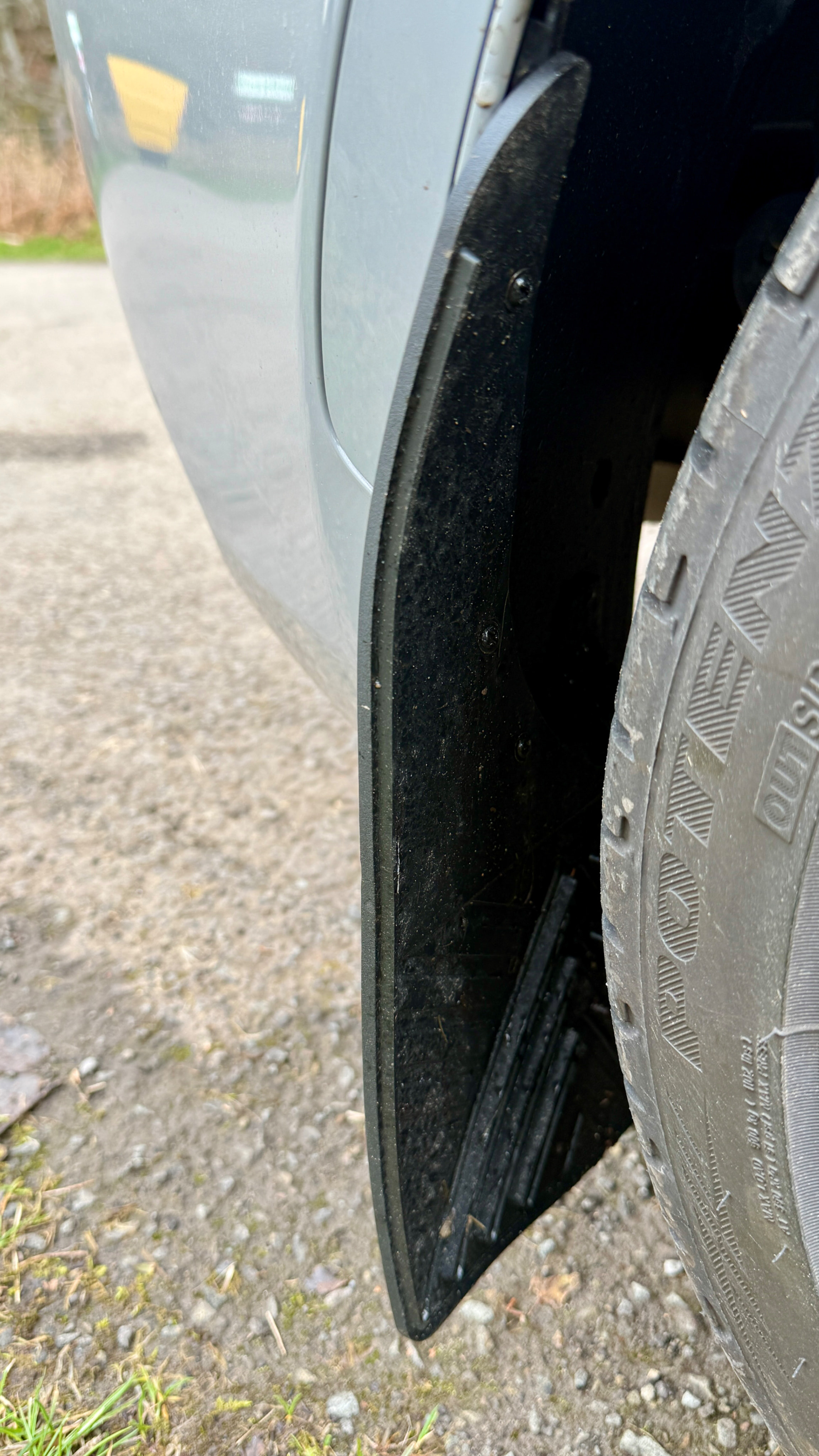

Fronts were easy enough. The rears I did the inner and outermost holes using some paperback books to get them both level then jacked the car up and took the wheels off.
Start with the drivers front as the tub is narrower than the passenger side once that’s lined up use the first flap as a template to drill the second one. I made pilot holes in the flaps and then pilots into the tubs.

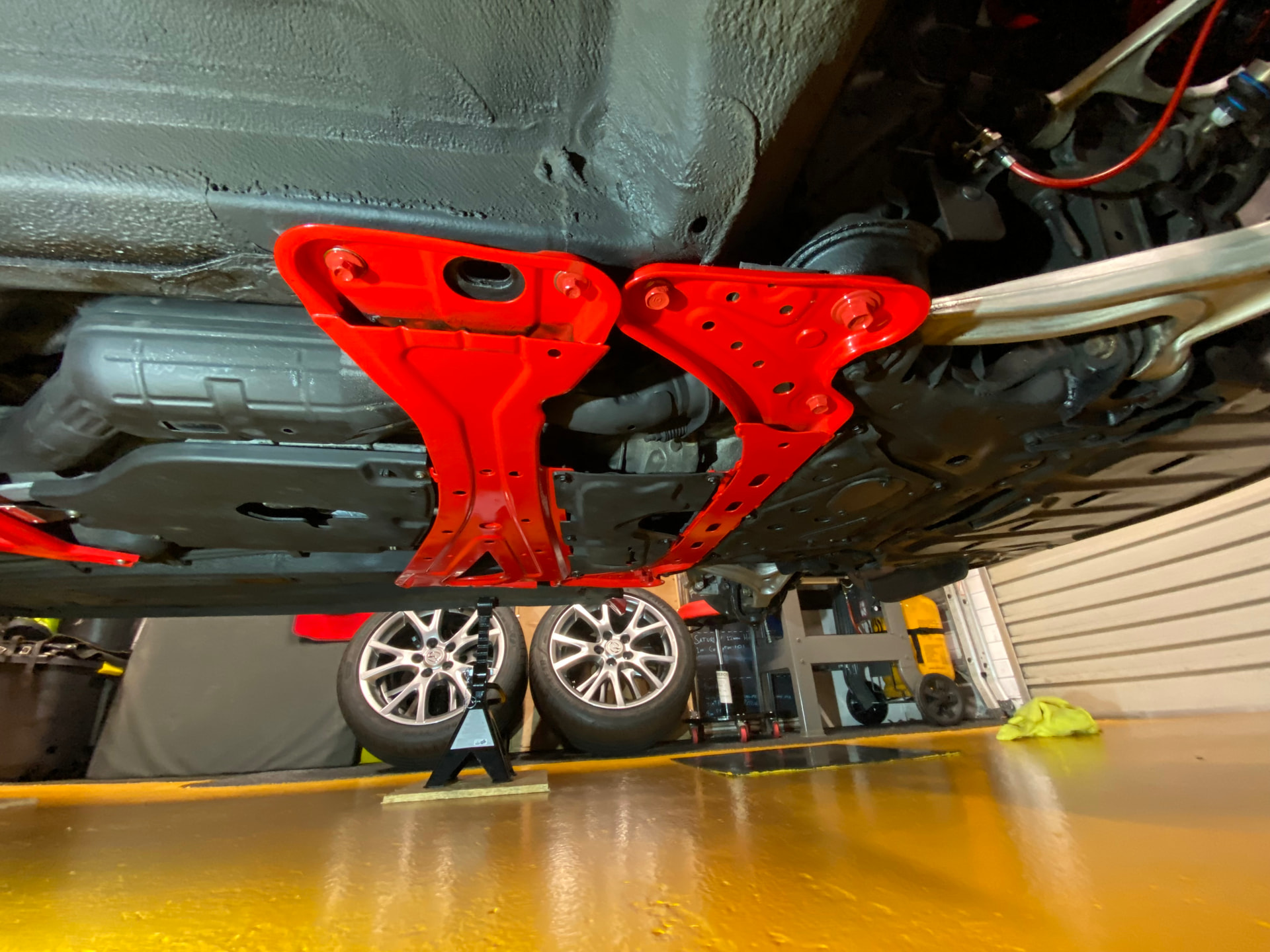

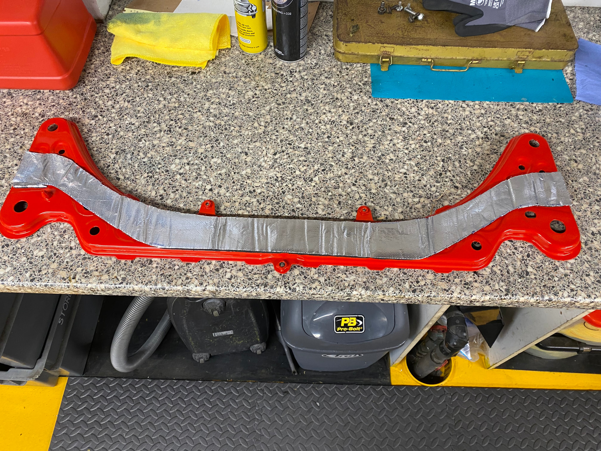

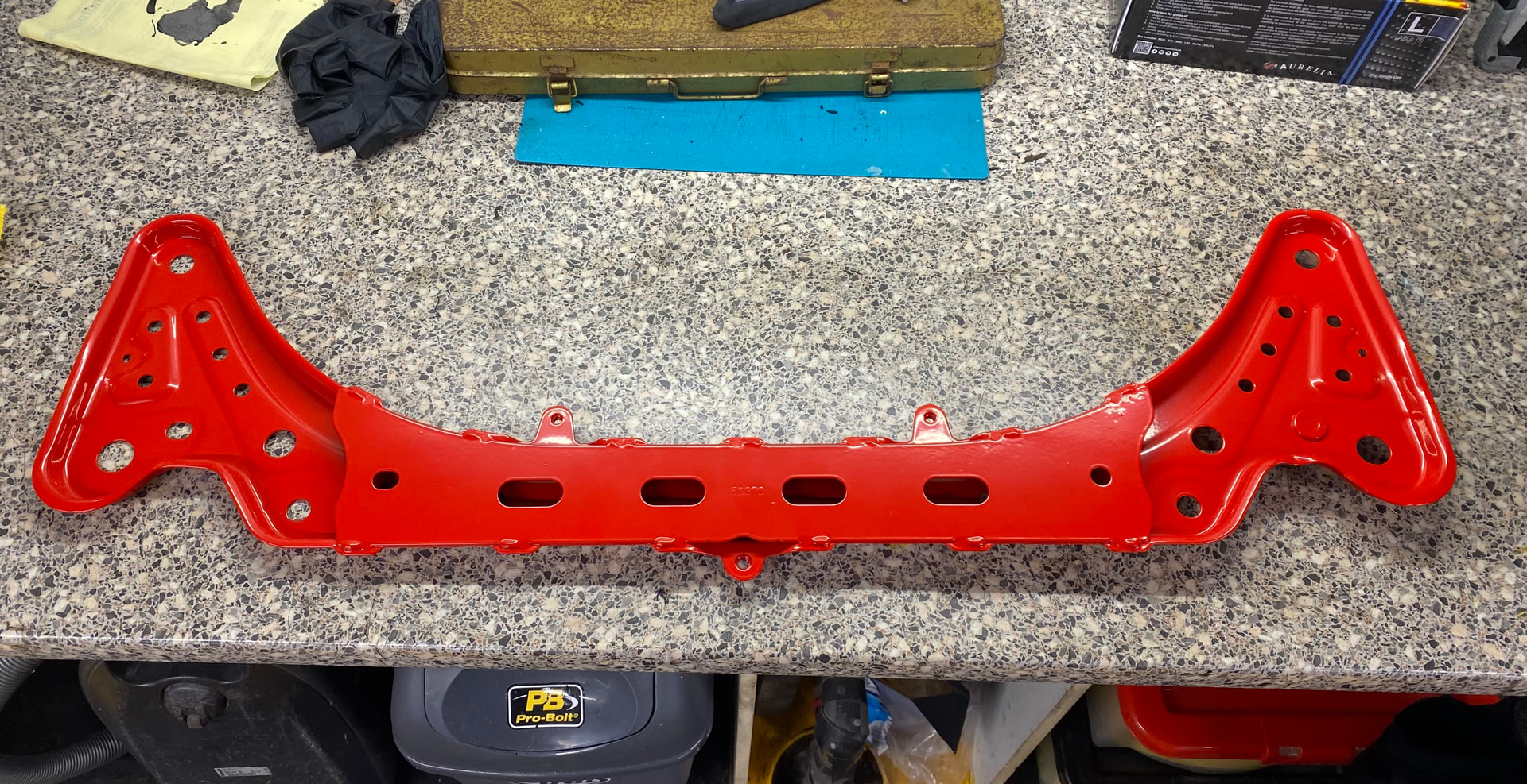

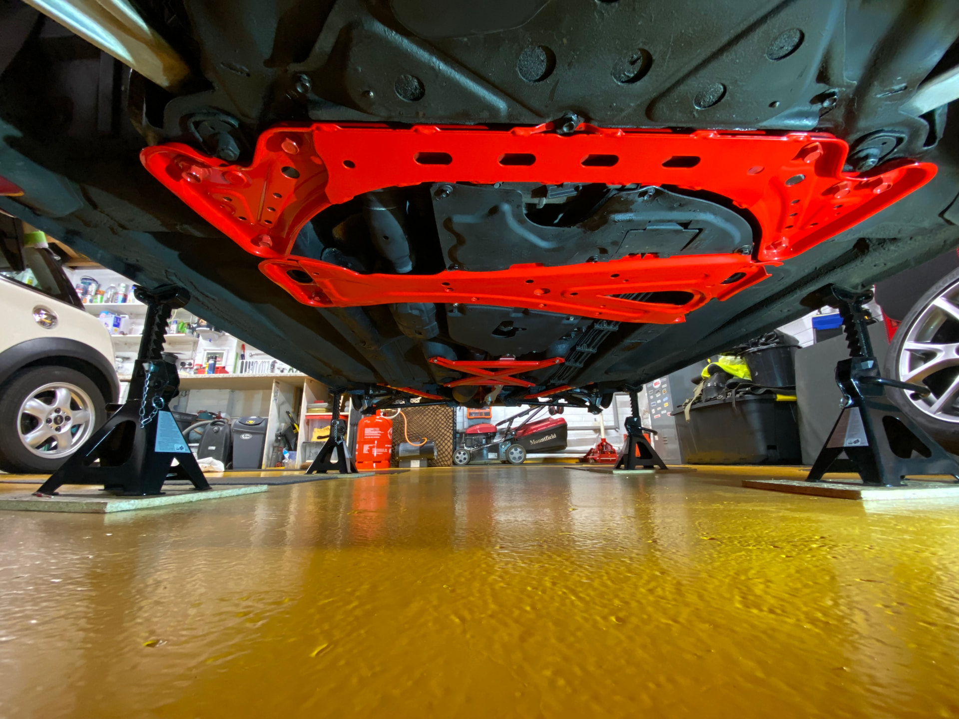

Final chassis brace removed, powder coated and refitted. Think I’ve done enough to the underside now.

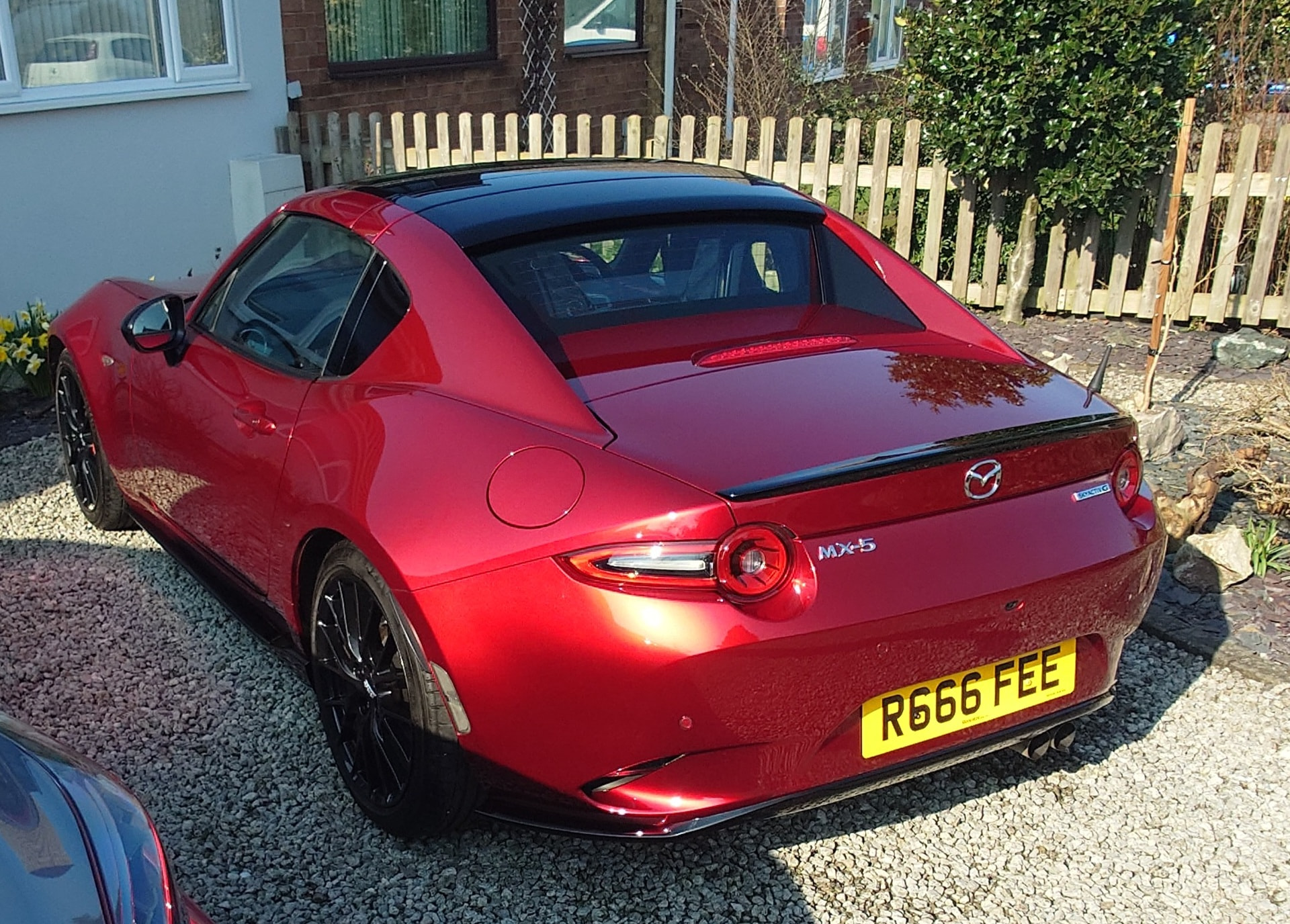

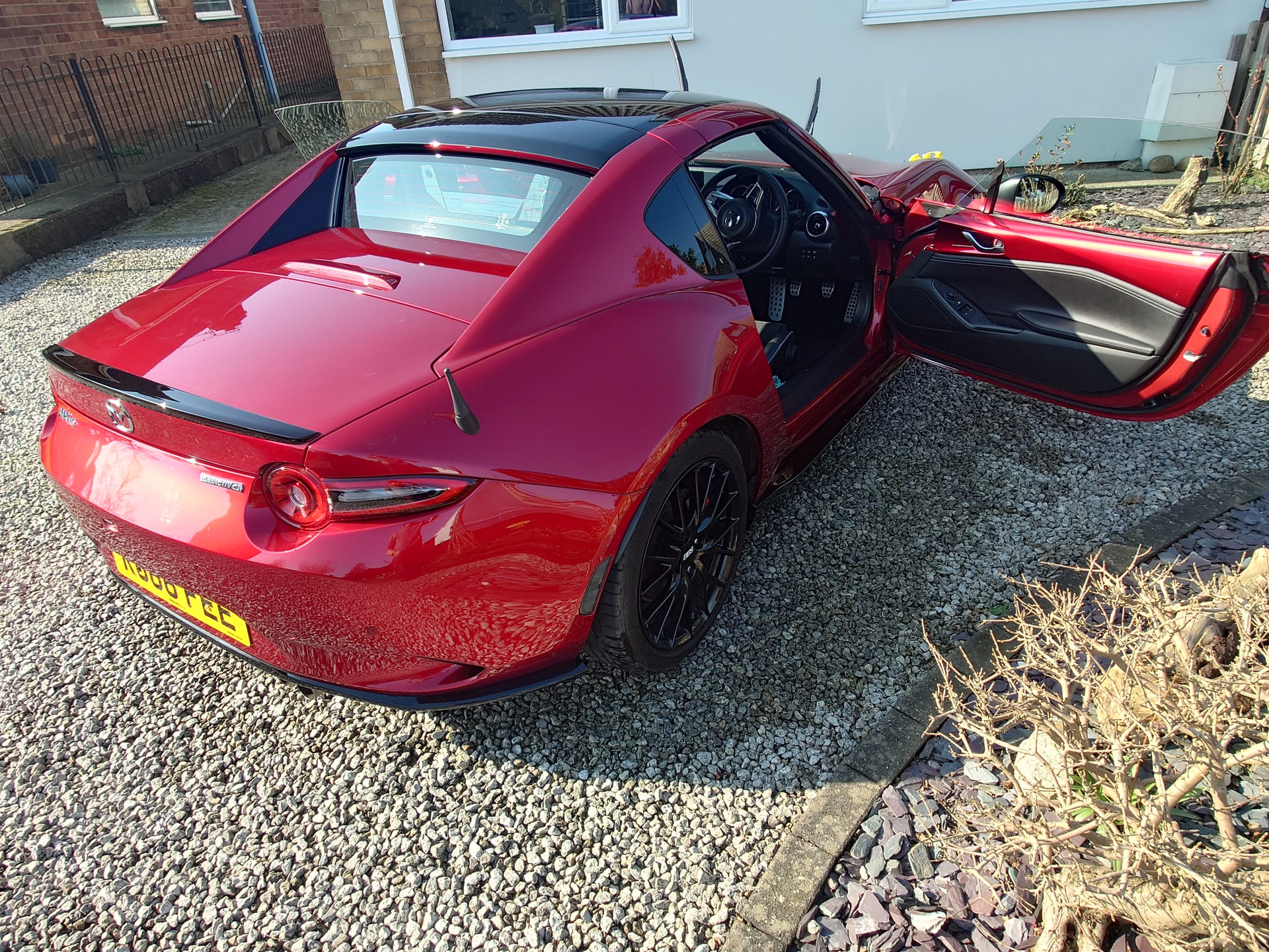

Washed it, again.
Saharan dust rain be gone! :two_hump_camel:

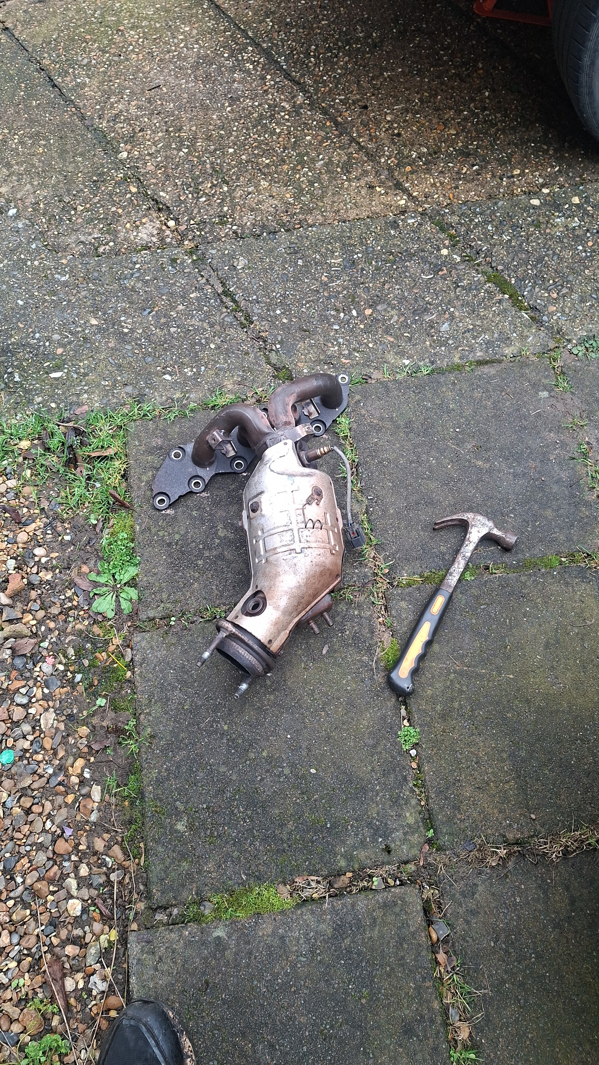

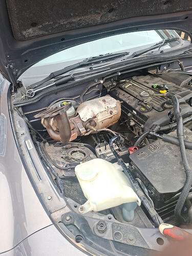

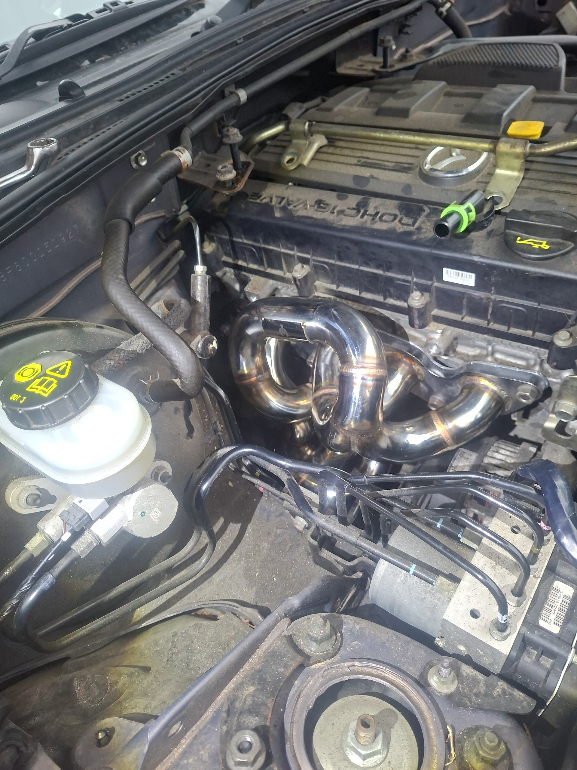

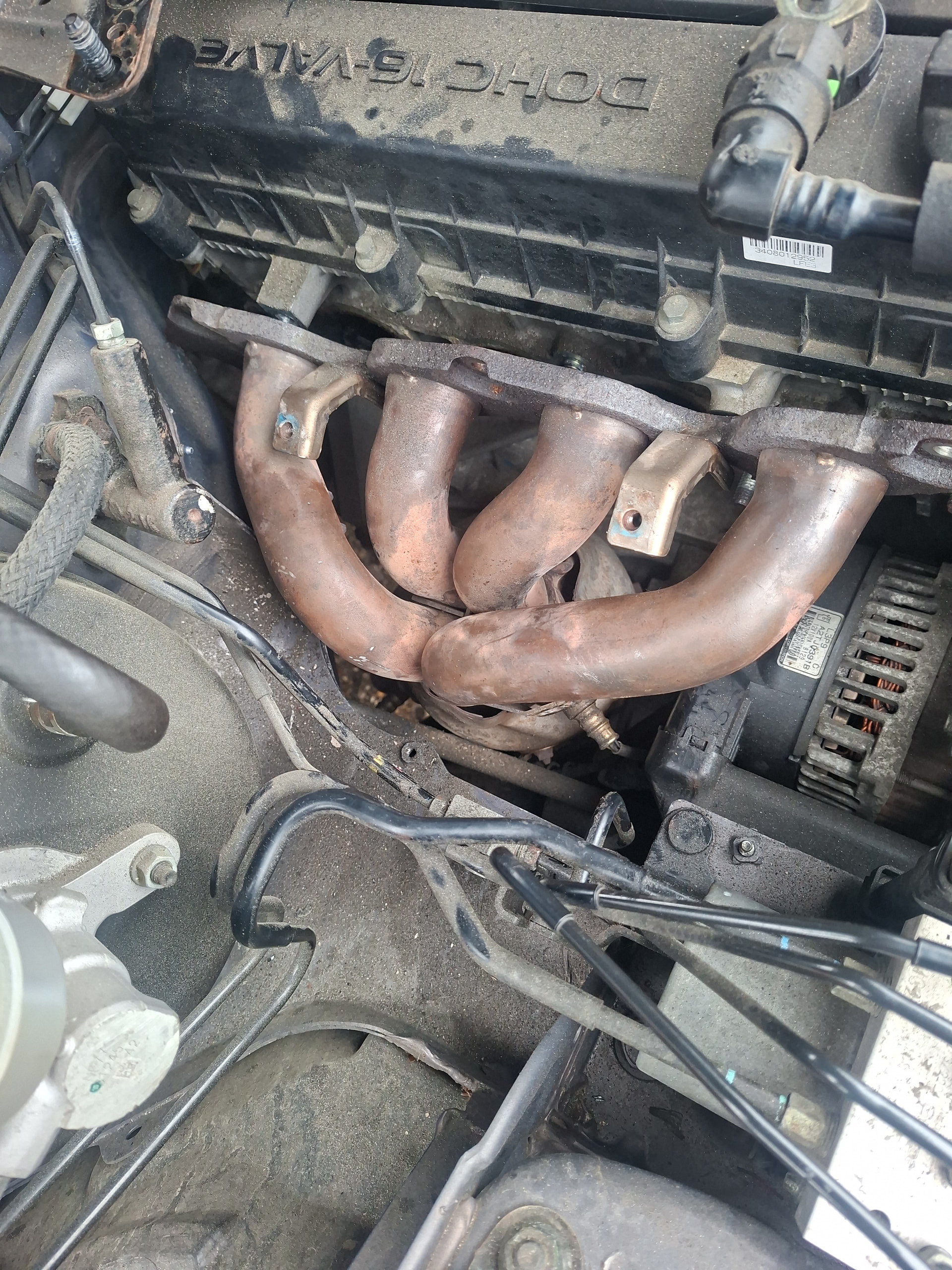

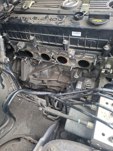

Well I’ve got it fitted, the full malian uel manifold, sports cat and race back box (already had the cat back fitted)…
Now it sounds bloody nice, got that subaru imprezza sound to it now, have to say the removal of the old standard manifold was a complete ball ache but once that was out it was all back together and running again inside 2 hours .
Must say im a happy chap
