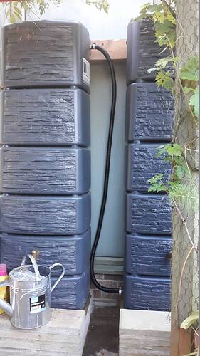

We have two rain water butts with filters on these brown butts in front of the car are what we use there is a 12 volt pump that hooks to a spray gun for washing then just spray on the carbon collective and wipe off the jobs done…

We have a few as well, here are the most recent pair. Each holds 330 litres, but only 300 litres is usable, the bottom segment is for ballast and sediment.
