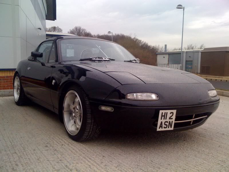

This is how my car is sat outside at the moment …

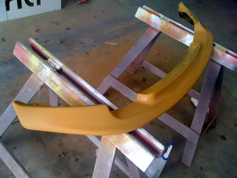

This is the spoiler primered up and ready for it’s first coat of black …

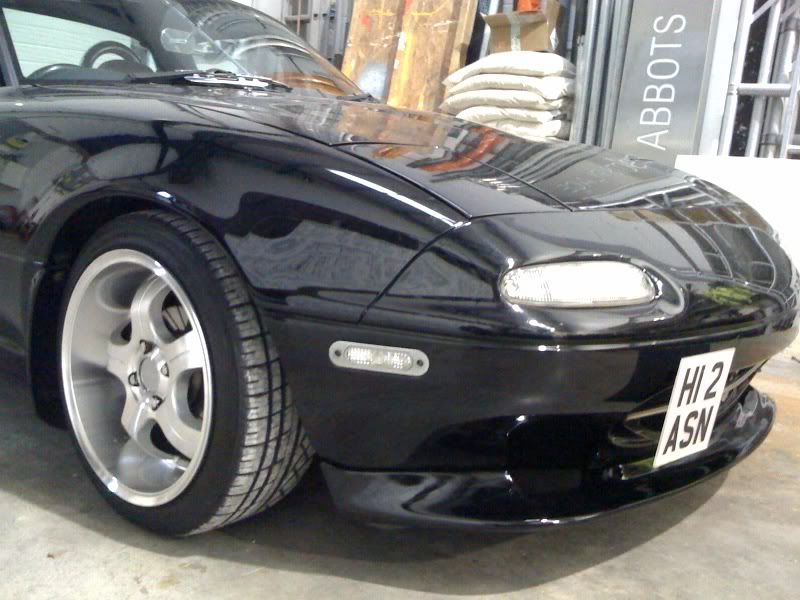

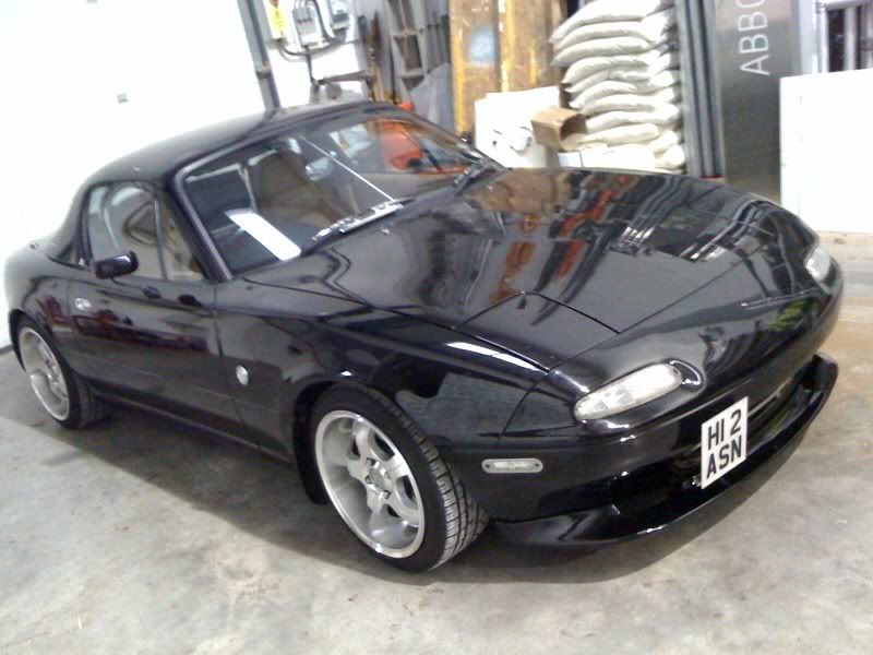

Woohoo !! It’s fitted. Doesn’t look too bad for an amatuer. I’m glad it’s back to normal …
Excuse the rubbish photos, they were taken on my iPhone.
