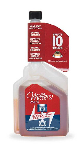

E5 only in my 1993 Eunos
Millers Additive
A capful now and again. Also, if you get “caught short” and have to fill up with E10, then add a measure before filling.
You will definitely know when you’ve added it.
