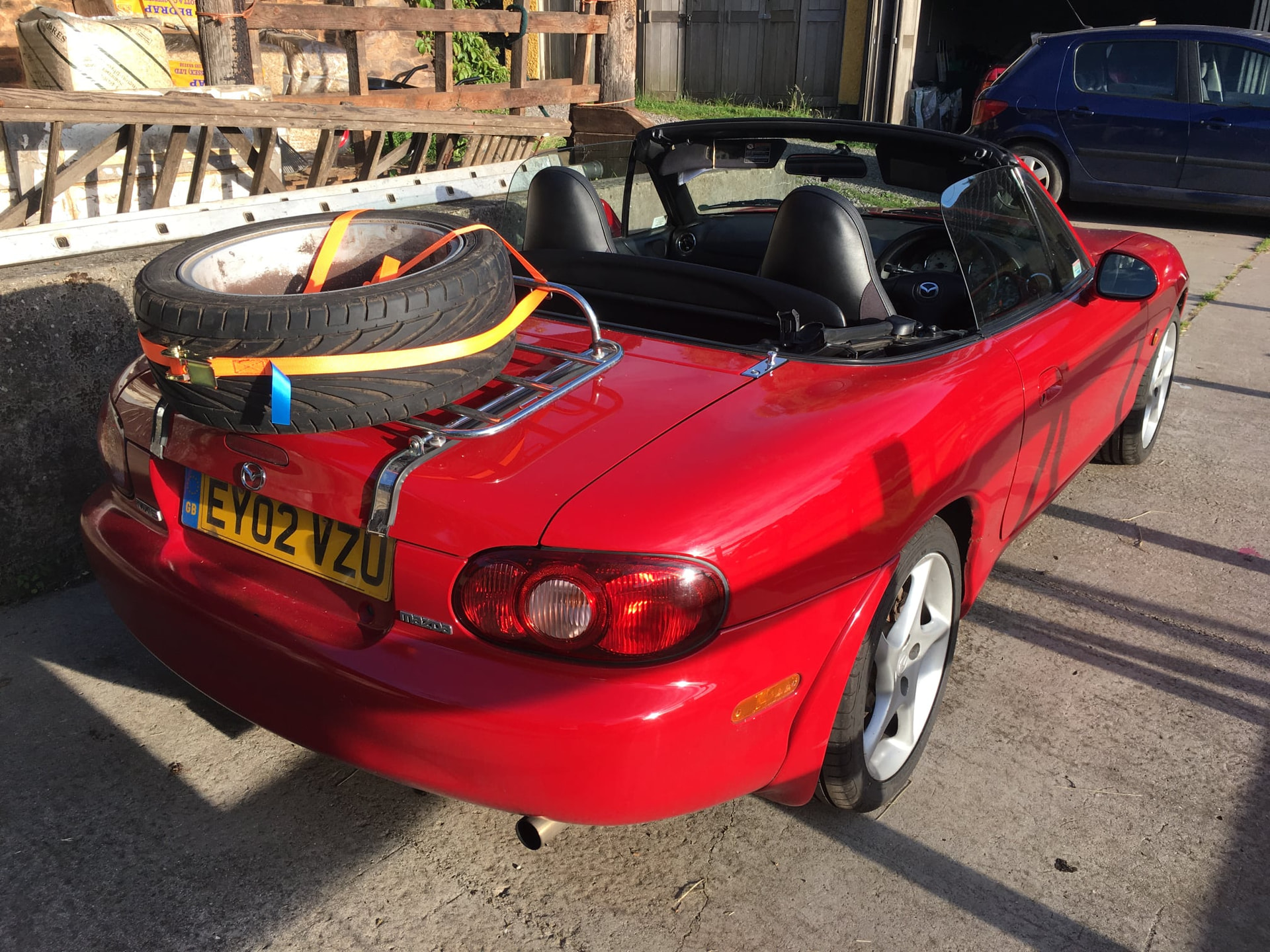

Unfortunately 16’’ full size will not fit in the boot. This is a good reason to always have a boot rack fitted, because if you do have to fit the space saver in the middle of nowhere you’ll have no way to get the flat home.

I dont carry bulbs because I can buy fresh ones easily enough along the route but amongst the other stuff are insulation tape and some lengths of wire, large zip ties and four flat bungees in case I need to strap down a loose load in the boot or even on the boot. They can be joined together to secure bulky stuff in the passenger side if needs be and some gaffer tape in case the passenger moans about it ![]()
