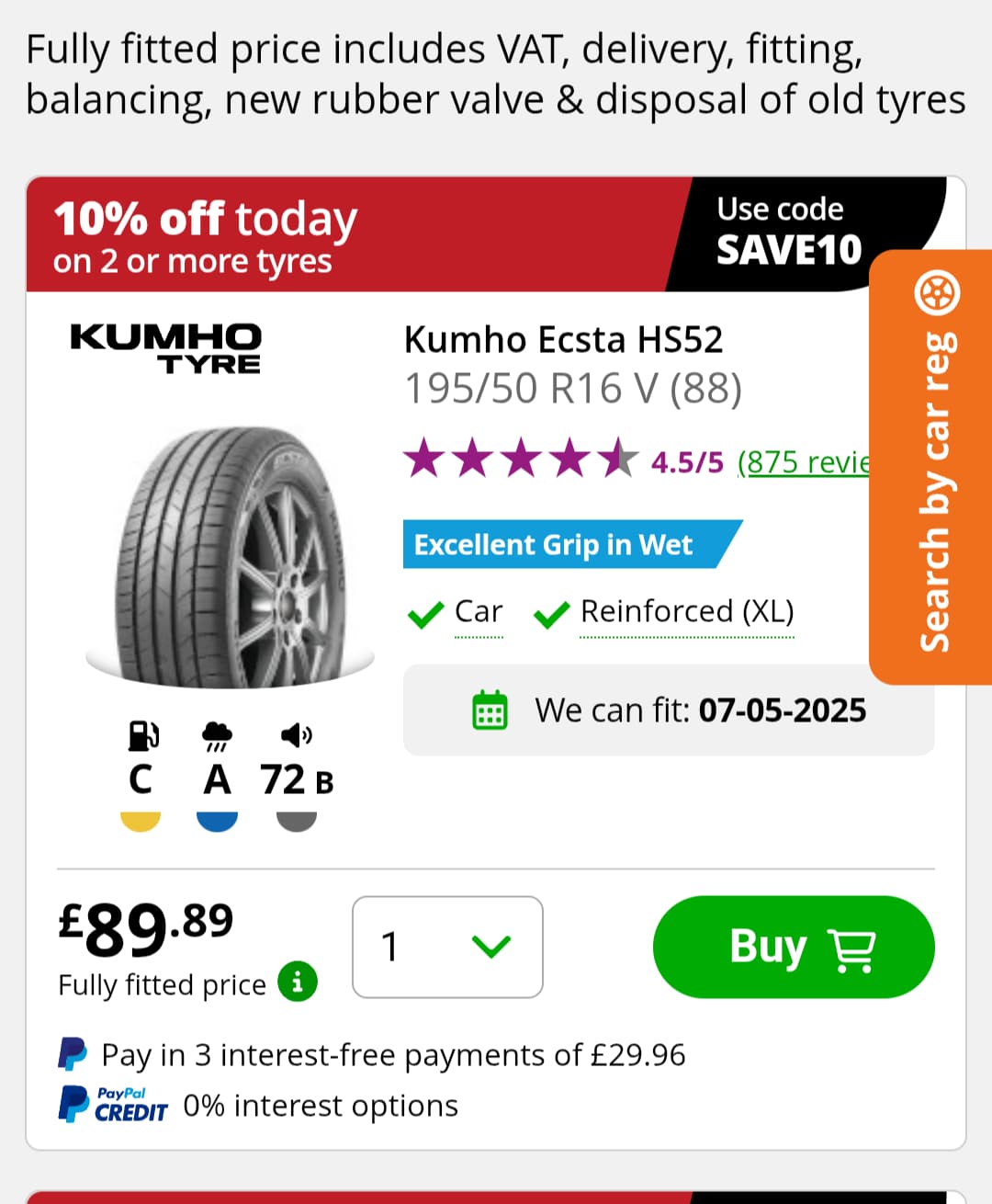

Just an example below, get 10% off 2 or more tyres at Blackcircles.

Bought those Kumho’s. They have been an excellent replacement for the Goodyear Eagle F1 they replaced.
These are currently offered in 84W by Camskill for £83 (not fitted of course). I bought a set of these from Tyreleader a couple of years ago and was surprised to see they were marked “OE”. They were probably made for the Lotus Elise. Initially I felt they were slightly different to the 84V’s they replaced, but maybe that was just the newness. Whatever, they are just as good as the 84V and there’s obvs no harm in a higher speed rating.

In terms of replacement, I’ll probably also put another set of Yokos on when the time comes. I often use Kumho and like what they produce, although annoyingly the version mentioned above is XL rated which there’s really no need for on the MX-5.
