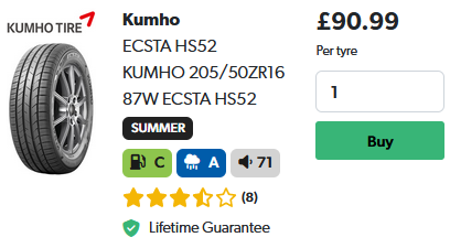

Have you got a link to each option? Sometimes there’s a bit of a price difference between speed ratings.
Sorry wardy I’m a bit of a technophobe. One site is etyres. The other is black circles.com. Any help would be appreciated. Thank you
One is speed rated at W (168mph) the other is ZR (149mph). The ZR is cheaper as is not capable of taking a 20mph increase in ‘punishment’ that the W rated one will.

I think there might be typos here.
I would expect to see
Ecsta hs52, 205/50/r16 87w
Ecsta hs52, 205/50/r16 87z

I can’t currently see the HS52 listed on Blackcircles in 205/50/16.
This is ETyres:
As said, essentially this will come down to the speed rating. Both have the same load rating of 87 which is fine.
The mention of ‘ZR’ is just confusing now, and should have disappeared long ago! ZR basically means the tyre is adapted for speeds above 149 mph. So it includes the speed ratings V(149mph), W(168mph) and Y(186mph). Before 1990, tyre manufacturers used “ZR” to mean high performance tyres before the ratings got refined. Nowadays, the marking ZR is not relevant anymore but it is still used in the catalogues of manufacturers and tyre retailers.
V speed rating is upto 149mph. W is upto 168mph. So clearly either is perfectly acceptable for usage on an MX-5 :+1:
