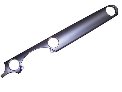

The car I just bought (NC 2010) has a wood effect dash panel and handbrake which I’m keen to get rid of. I already have an original leather handbrake sleeve, and ordered a silver dash panel from eBay but it has a very noticeable scratch on it which id through to the black plastic below.
So I was thinking of either trying to spray paint it after sanding scratch, or even wrap it in alcantara. Has anyone done something different with this panel? I was wondering what it would look like painted the same colour as the car body (in my case dark blue). It is called a “decoration panel” after all…

Wrapping film is so cheap and pretty easy to do. Did the gear lever surround on my ND. Cost me under a tenner for the wrap and I’ve got enough left to do at least half a dozen more.

Wrapped mine in ‘alcantara’ after I scratched the gloss black. Ouch!

I was thinking of either this or having it sprayed body colour, but that does blend in well and looks classy. Did you use the self adhesive alcantara? Wasn’t it difficult getting it to bend around inside the vent holes without creasing?
Yes, I bought a roll of self-adhesive ‘alcantara’ online which meant the general installation was quite straightforward. There was a little give in it too so it could be stretched to fit over the ends and sides etc…
However, the hardest part was the vents. I didn’t find an easy way to do them so it was a little bit messy/fiddly. Luckily, the vents pop out so they can hide some of the untidiness when you put them back in.
How did you do the inner circle bit? I’m trying to do this and struggling like crazy!!
