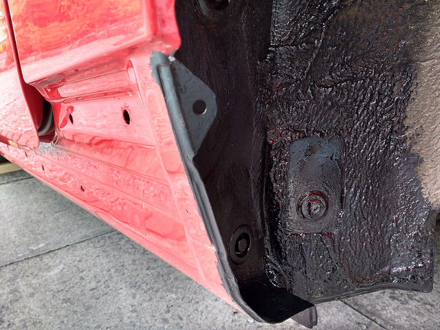

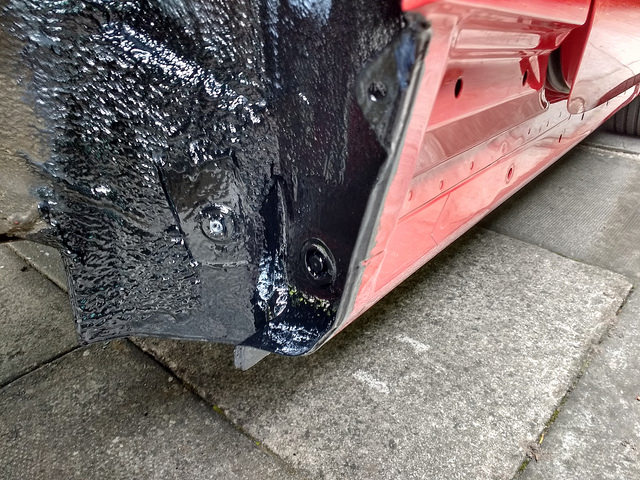

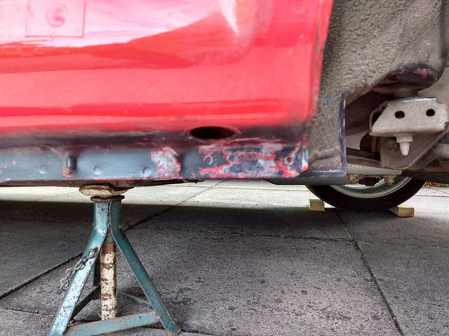

Certain areas on the Mk3 were never protected fully from new, I found them to be around the rear wheel arches in front of the wheel and also going underneath the car along the rear part of the sill. Other areas I’ve found or course prone to catching the road muck and then rusting, it would of course apply to any model you have just treat and protect.
The products I used were Hydrate 80 and black epoxy mastic from Bilt Hamber. I’d been through a number of car resto projects, various websites and recommendations and they all seem to have their favourites, I settled with the above.
First pic I treated the areas with the Hydrate 80 after removing the rust. 2nd pic applied the epoxy mastic. 3rd pic overpainted with black hammerite for good measure.
I did other areas too but you get the idea with what’s shown.
Just to add to the above post, the epoxy mastic is potent stuff, wear a mask, eye cover and gloves as recommended.
I had previouly treated the undersides with Kurust and Dinitrol but I could see evidence of rust creeping through again after 2 years. It was nothing drastic ceratinly not crusty stuff just surface, maybe my previous pre prep wasn’t good enough. The latest treatment involved prep with flap and grinding wheels to really get into the metal and remove as much rust as I could.
