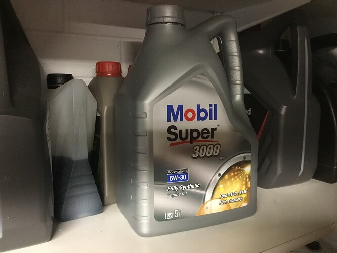

For what it’s worth I use Mobil super 3000 in the NC.
