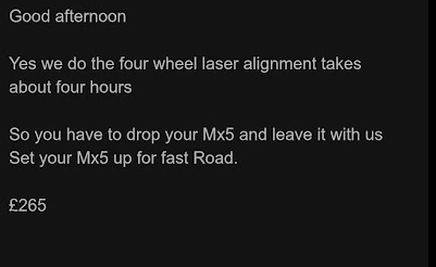

£265 for 4 hours

I will point out that the £265 quote does state ‘fast road’ so it is reasonable to assume that this is what you discussed with this garage.
