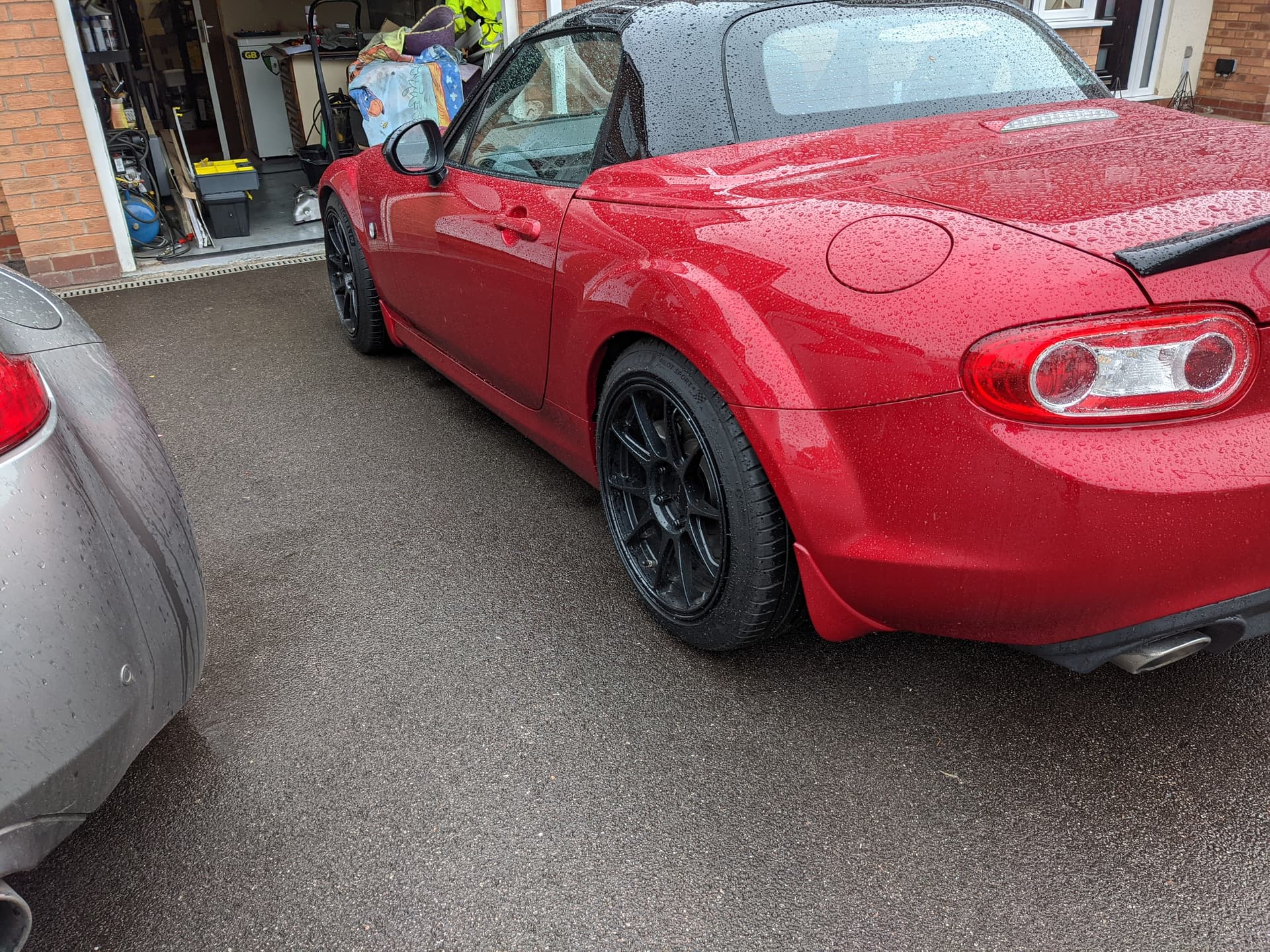

I currently run 17 x 8" Rota Titan flat blacks with 215/45/17 Pilot Sport 4’s. Spot on for me.

Thanks MXican. They look really good. What offset are they. Thanks
