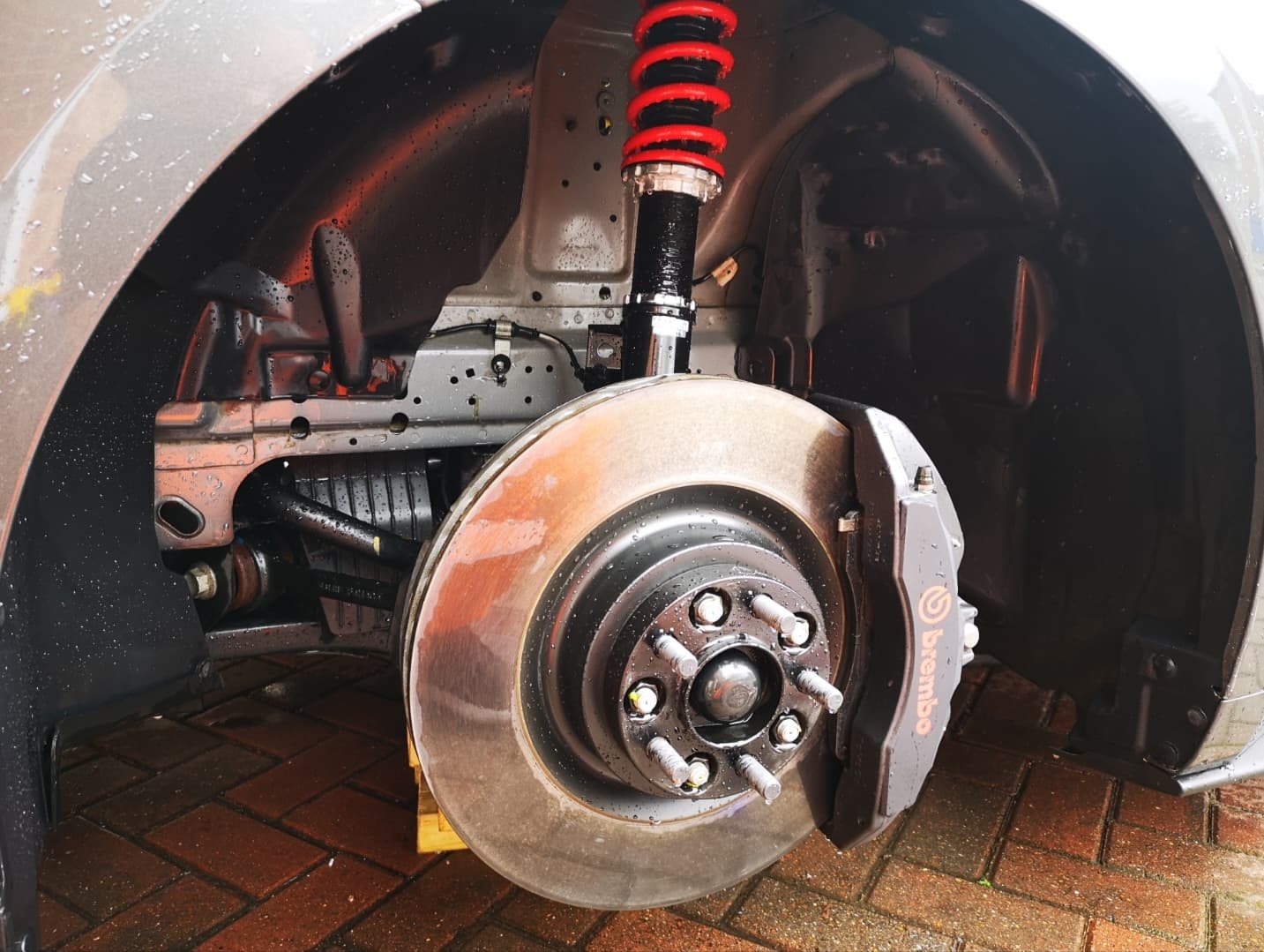

Edit: I would however add a cross check seal/mark to each of the nuts on a hubcentric spacer once they’re fully torque to spec so that you can ensure they haven’t come loose at all quick reference whenever the wheels are off. This was mine.
