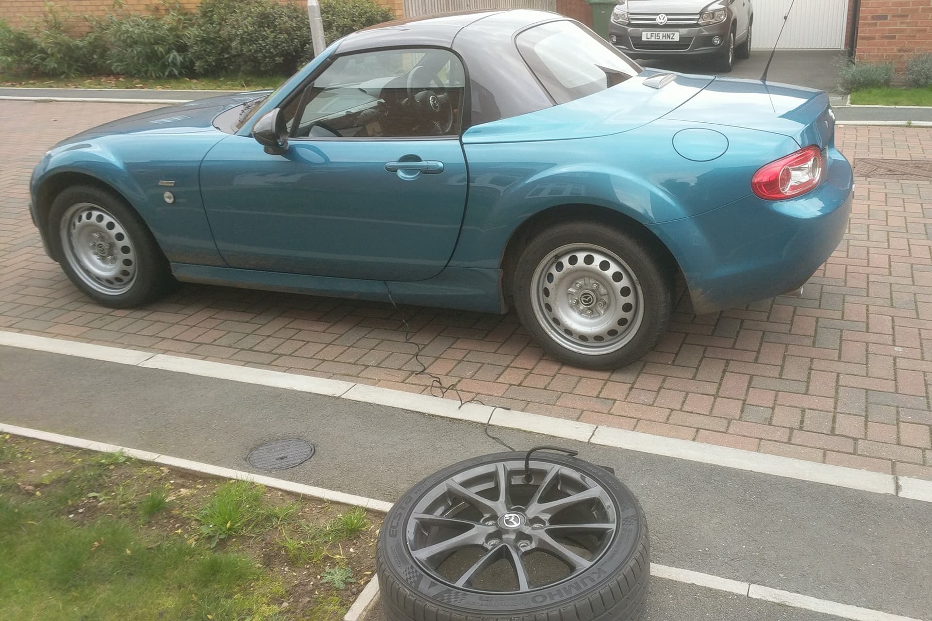

Mazda sold a steel wheel for the NC MX5:
It was originally fitted to base 1.8 cars in the UK, but quickly deleted. However, in Japan, it continued as standard fitment to the clubman special 2.0 NRA version, so I assume adequate ventilation.

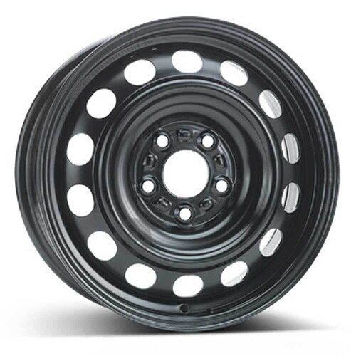

It looks like they are ‘no longer available’ according to their website but always worth a call to check.
Cross reference against other Mazda models.
Specs are 6.5Jx16 ET55, Center Bore / Hub Bore: 67.1 mm, Bolt Pattern (PCD): 5x114.3 (5x4.5) .
Same wheel fitment on Mk1 Mazda6 with 16" wheel, but the calipers will kiss the wheel if the pads are new, so tight fit. Tighter on NC2 compared to NC1.
Alcar 6.5Jx16 ET50 5x114.3 for Mazda 3. 5mm less offset, so will stick out 5mm more.
But this will mean no chance of rubbing important bits.
£120 off popular shopping site.
