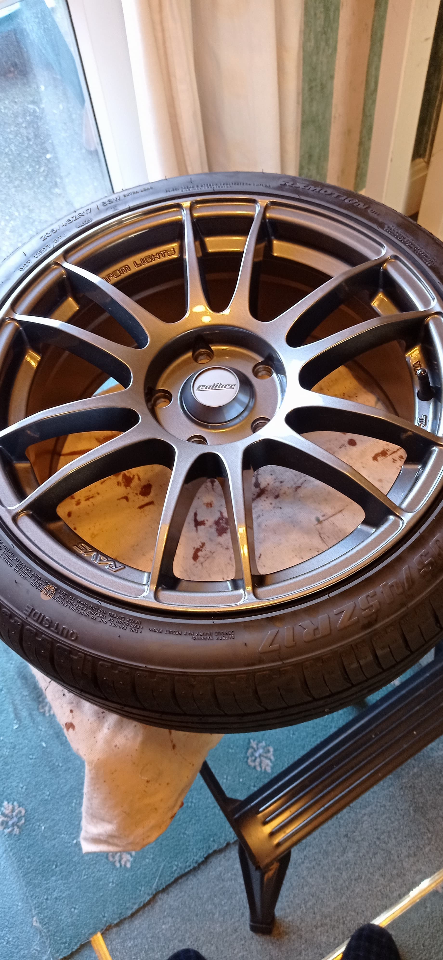

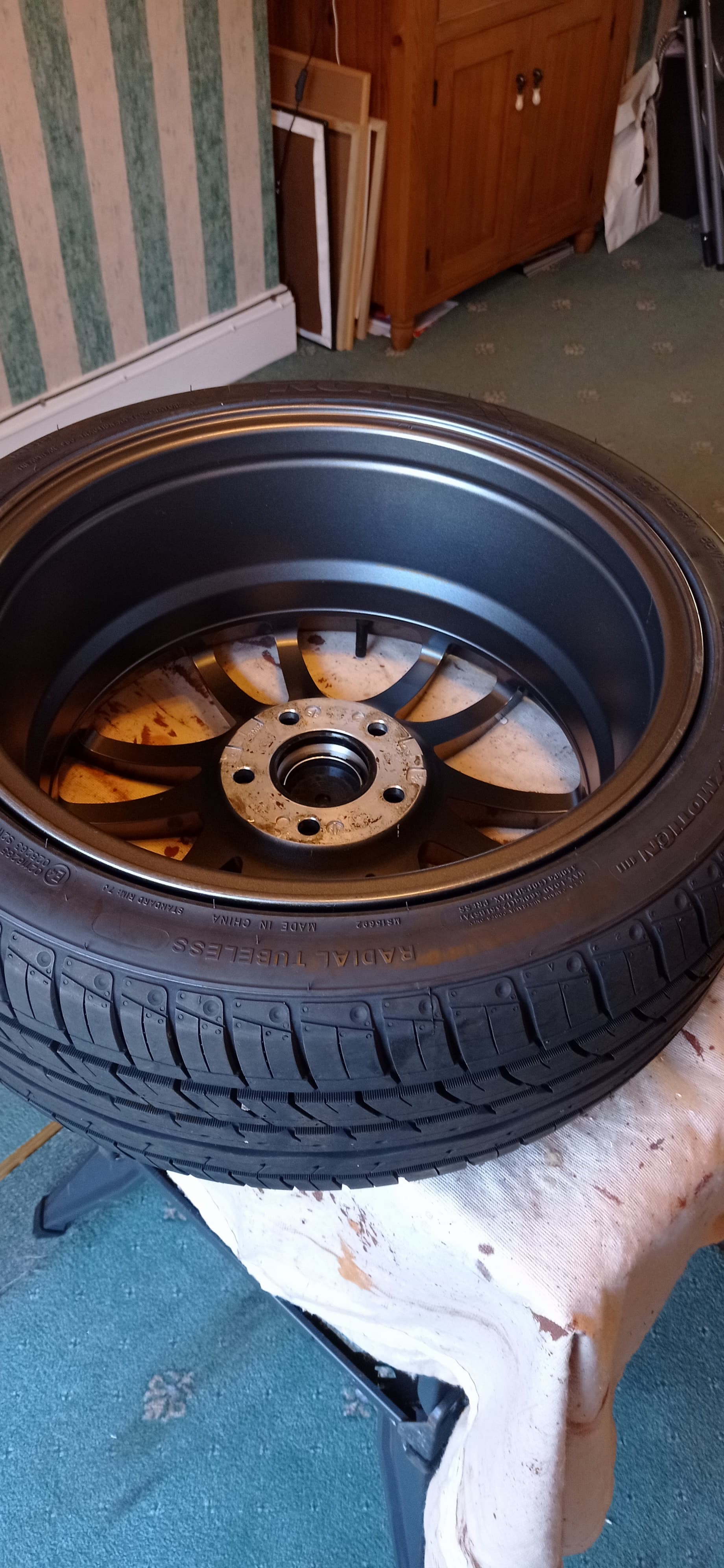

I should have some almost new, with almost new tyres fitted 215/45/17 Calibre Suzuka Rays Gram Lites in a light gunmetal shade for sale very soon. These were fitted to a MK3 NC if you might be interested? Here’s a pic of one.
