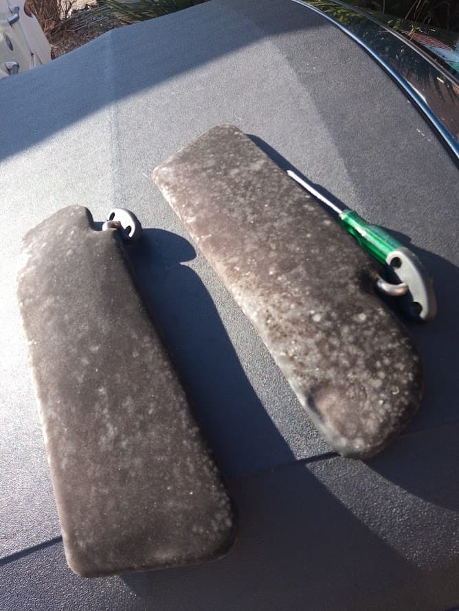

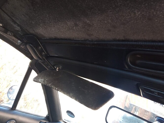

The flatroof on my garage is knackered, and I’m in dispute with the builder who is supposed to fix it. Anyhow a tarp was put on to stop the worst of the leaks, and the car has been stashed away for 2 months, largely unseen.
This is what greeted me today, proper furry mould and a car that is now a Petri dish.
Garages, if damp and poorly ventilated, can cause more harm than good. The boot lid had been left open, and the carpet was perfect.

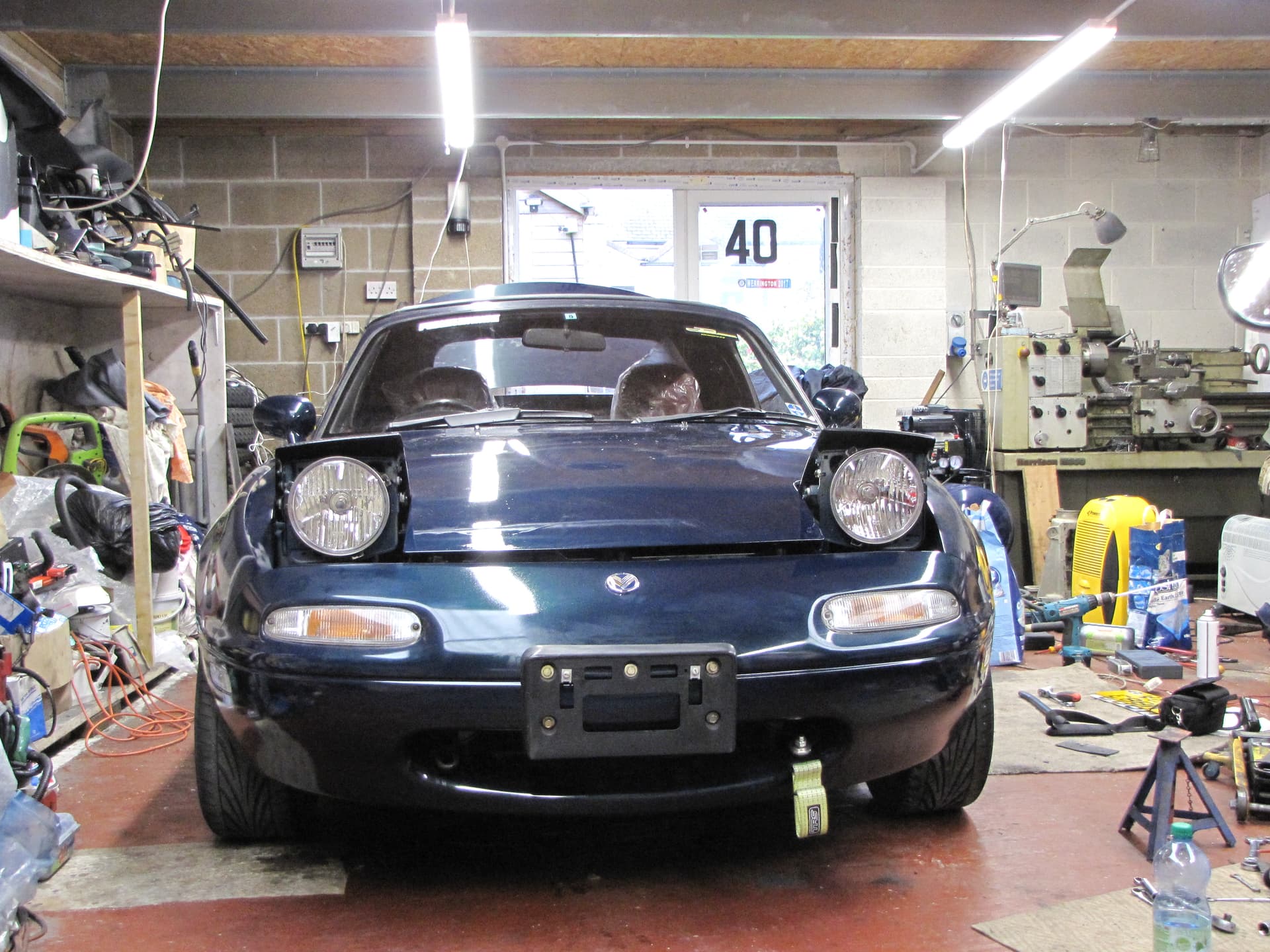

Car in picture was still unregistered at the time of the photo so never driven in the UK hence no numberplate.
