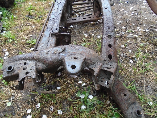

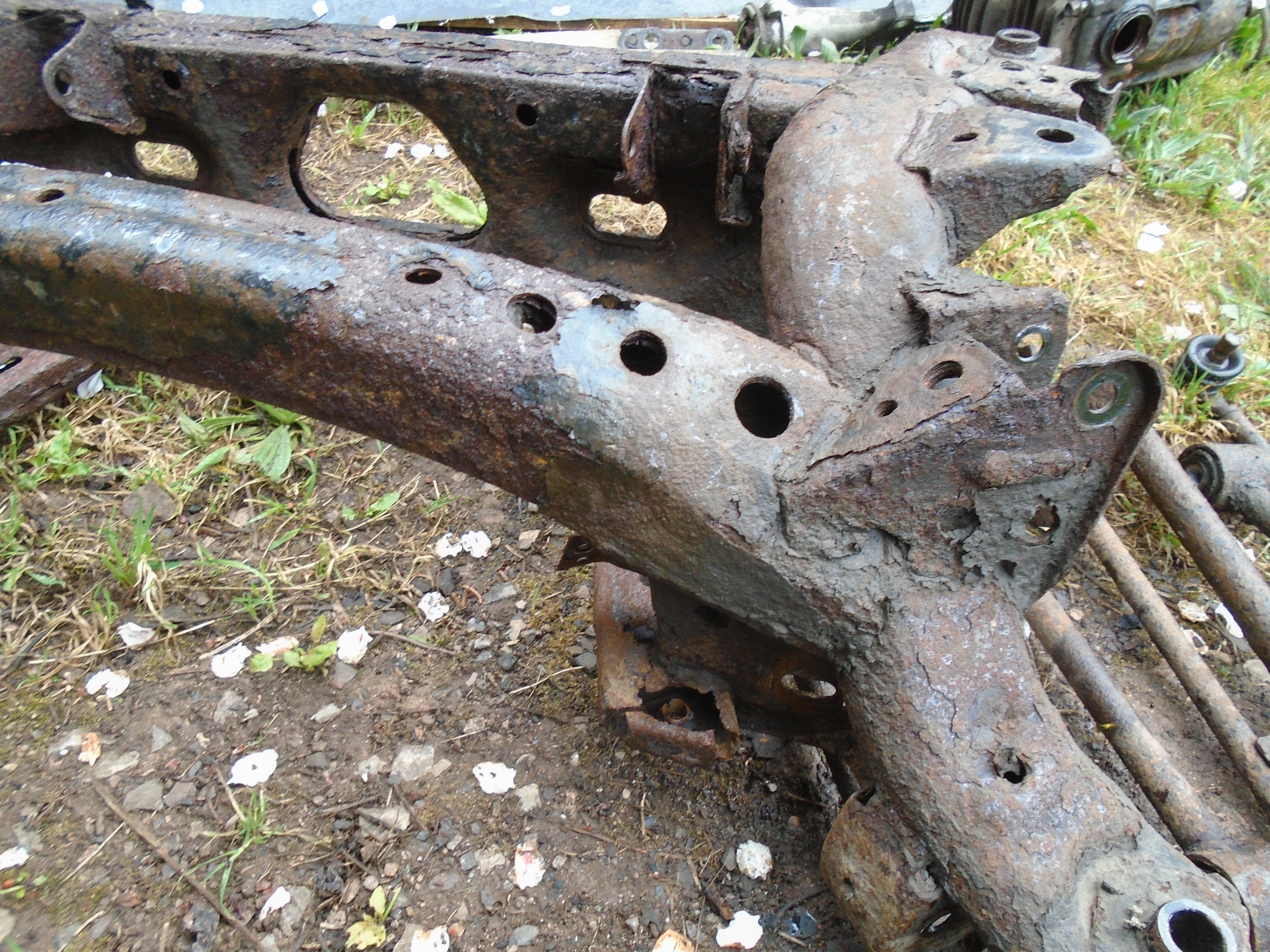

I recently dismantled an MoT failure and then refurbed a broken '07 and I was amazed at the reduction in strength of the components.

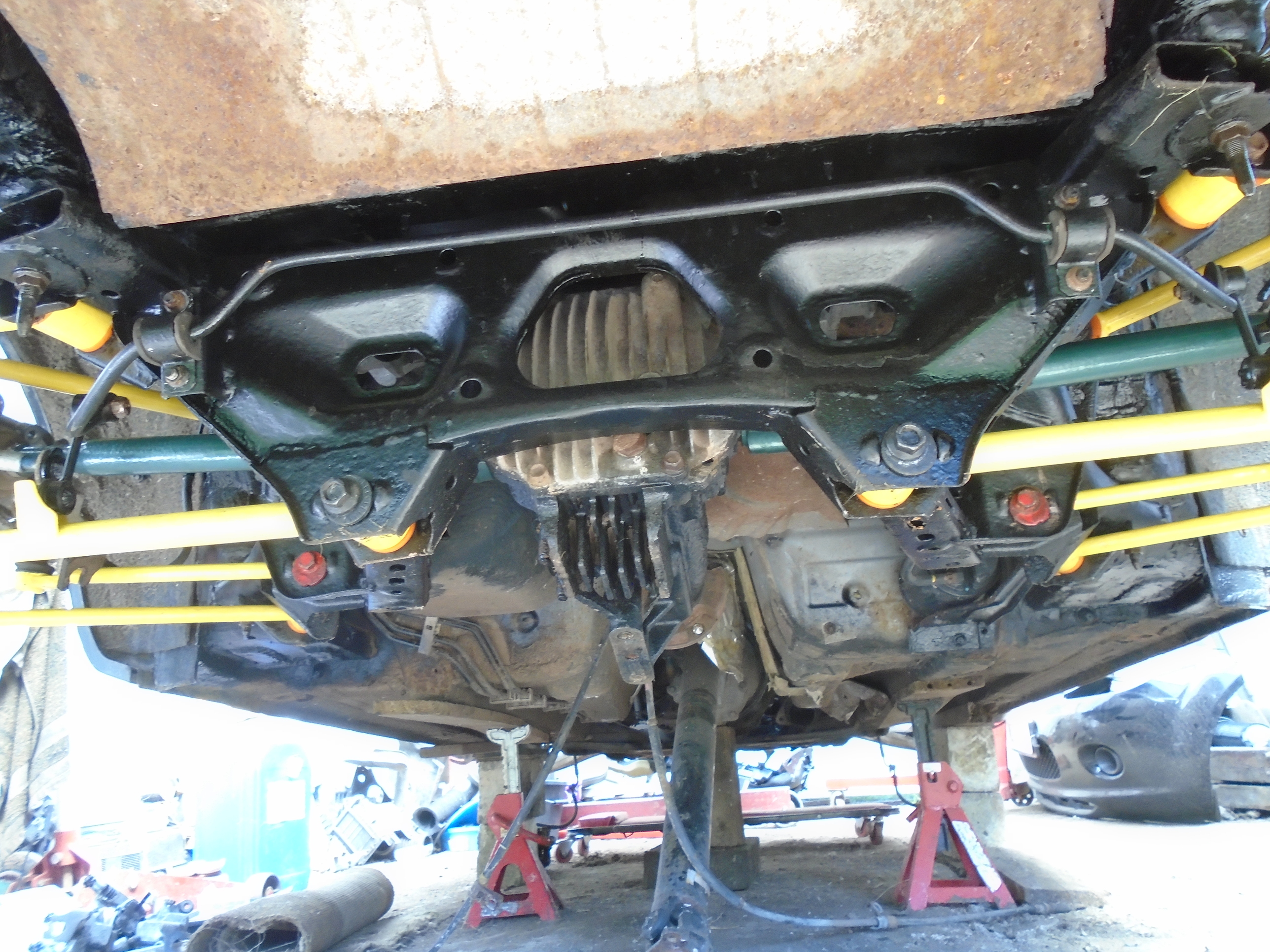

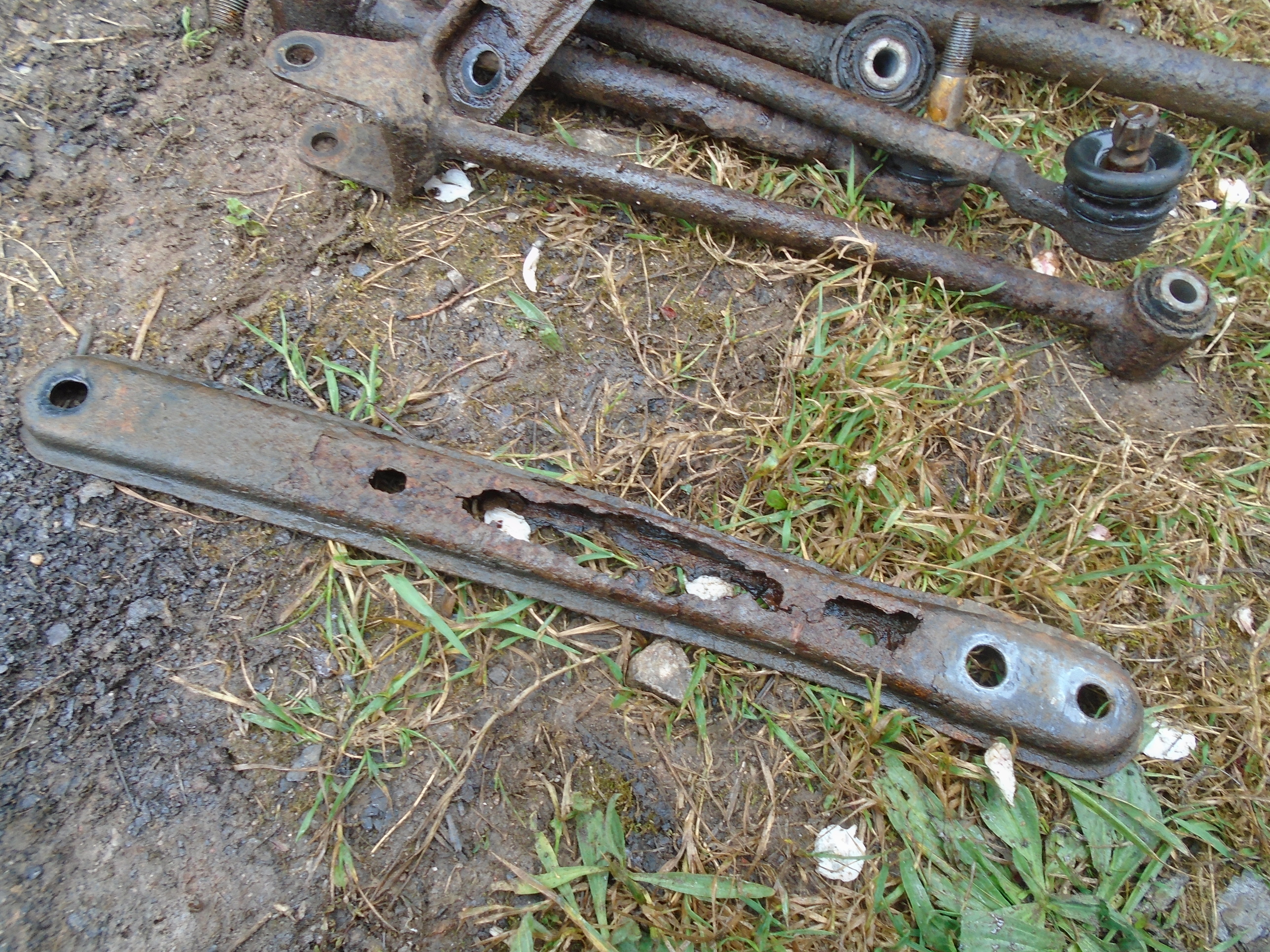

The suspension component mentioned is probable the body to subframe strut as its hollow and will be all rust. Third picture
However, if that strut is rusted out the subframe is likely 75% of the way with it.

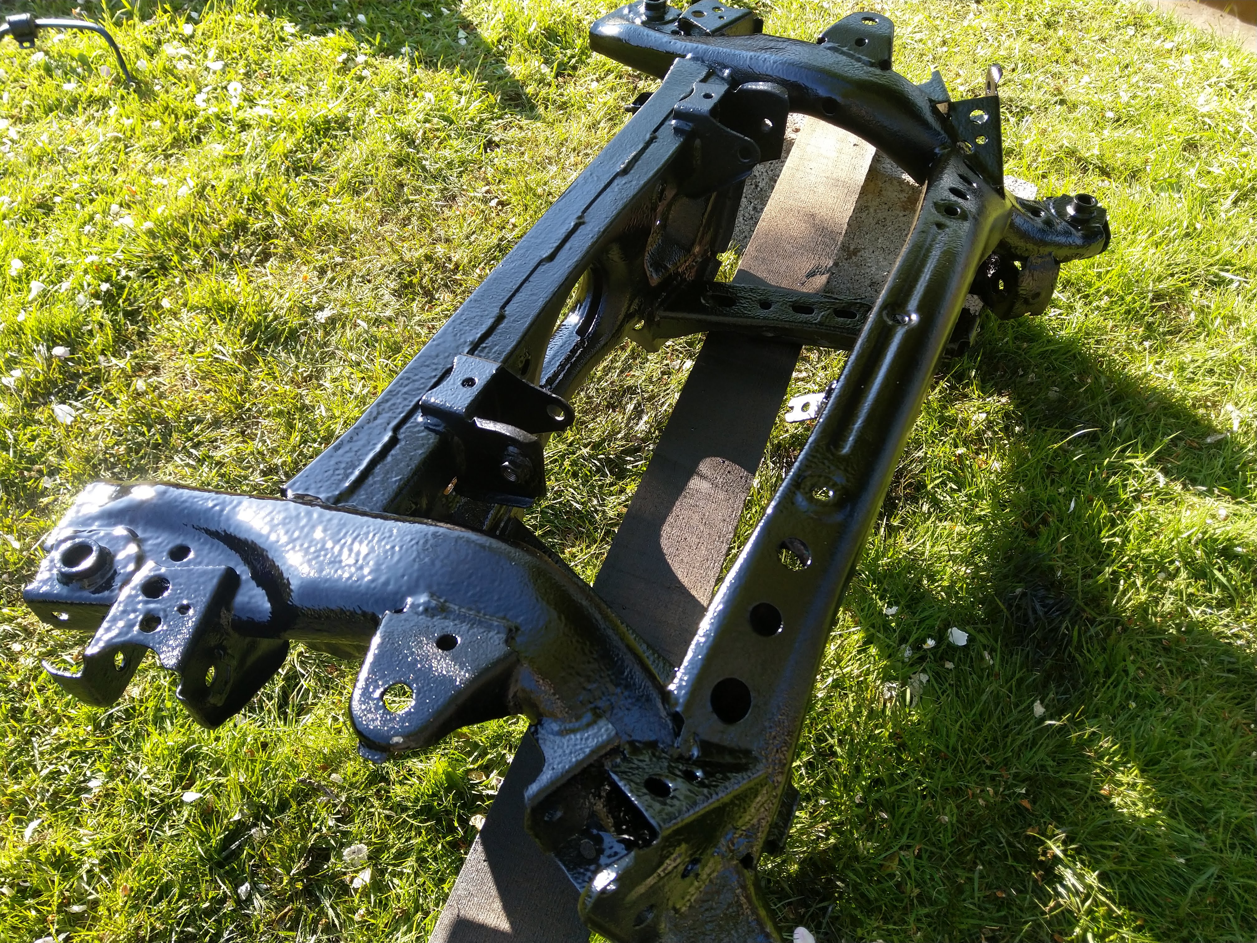

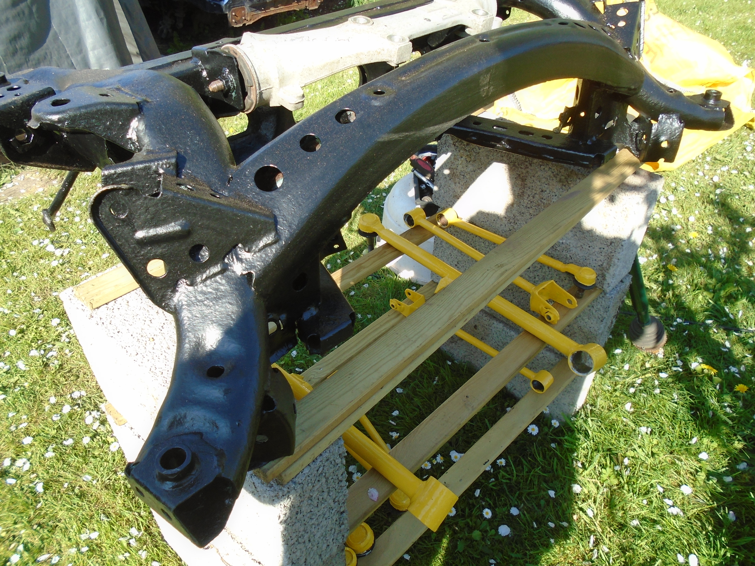

This sub was 3 weeks work during lockdown, five layers:- rust inhibitor, primer coats, heavy black and stone chip later… and all new bushes. The bush replacement was as much trouble as the rust, pig of a job!
the end result…
