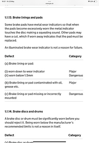

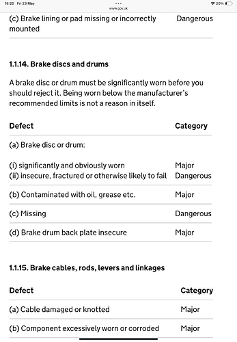

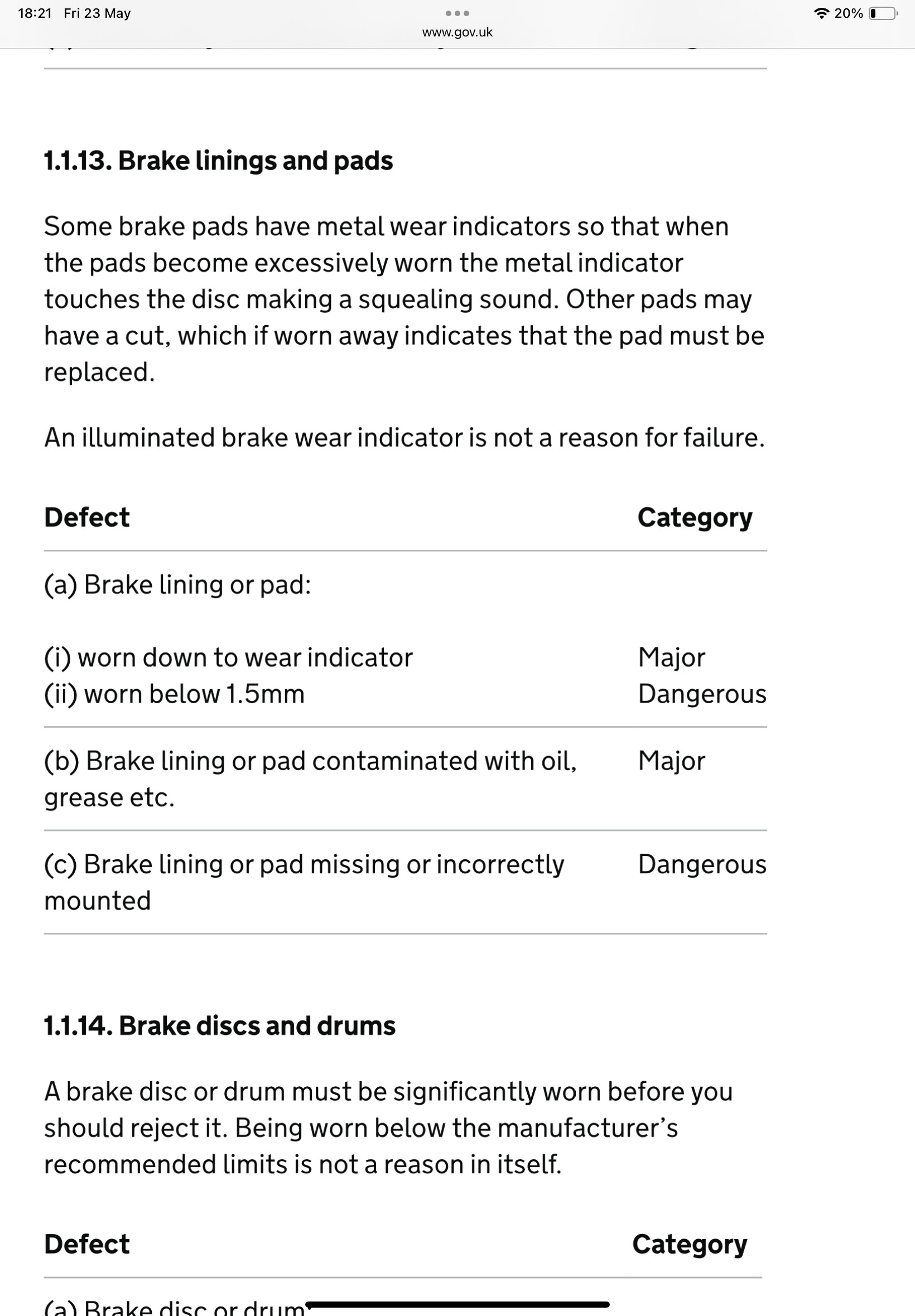

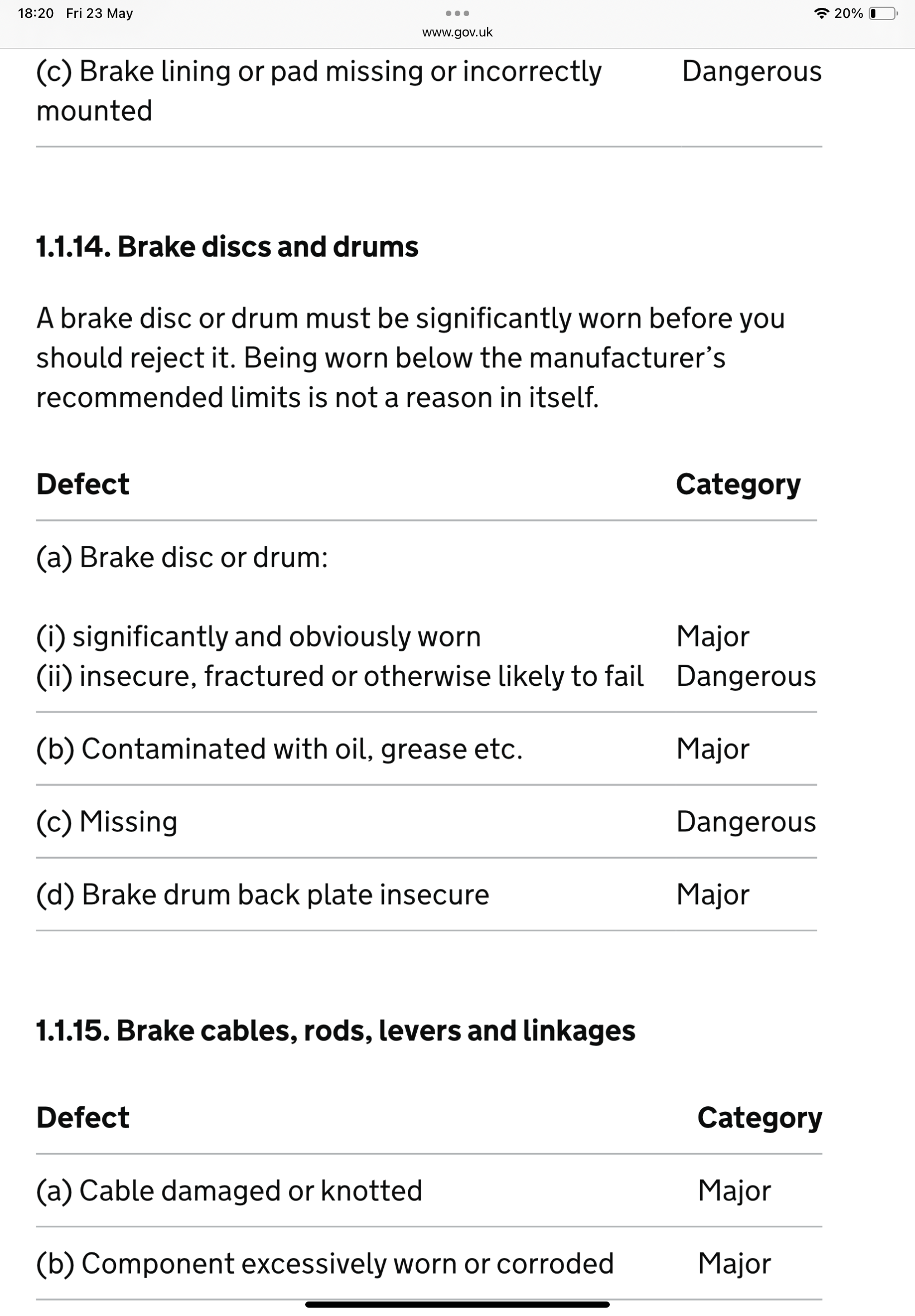

Just to clear up any confusion, here are the limits as prescribed on the gov.uk website for the MOT test.
Apparently if the pad is below 3mm it will be a minor fail so will still pass mot.
