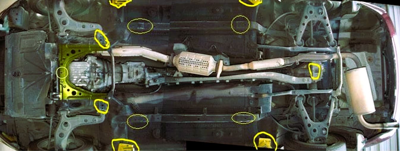

When undercoating, which parts need to remain uncoated
for example, so far i’ve read brakes, exhaust and heat shield above black box. i’ve attached the jacking points handy helper loads of people use because i am no expert, clearly. if you name a part that isn’t so well known, you can just say its next to … eg lower control arm, which i do know about.

to be honest you need to be a nutter to do it yourself = one who loves getting mucky. Hope you have a garage. To do properly some/many say that you MUST scrape off ALL of the underseal, treat with a rust preventer after you have scraped off any rust BEFORE you even think about adding Dinitrol or - heaven forbid - a lanolin based product. That’s my 2 penneth worth.
I try to avoid exhaust and brakes but dont worry too much about where else it goes, thats about it really. A bit on the heat shields wont hurt.
You can paint everything underneath except parts that move. Avoid also coating the diff, engine and gearbox, drive shafts and rubber gaiters, alignment adjust bolts. Obviously not wheels, brakes exhausts and heat shields.
I removed the back box and heat shield there to get to the boot floor better, mine was only riveted on.

I forgot to say in my post, I used Dinitrol black underseal everywhere. Before the actual coating I ground back any corrosion where I could to bare metal.
Rust converters are usually a painted on liquid that turn rust to a purple colour, let dry and if you want apply a zinc primer first to those areas or apply the Dinitrol straight on.
Some say those stop rust applications are not actually going to stop it, maybe just slow it down, which is correct. You’ll need to check the parts you’ve treated annually and treat again if you find rust poking through again.
I’ve had to do the above before, only in certain areas.
And just an observation that I’ve found, talking NC’s here. You won’t have to cover the whole of the car underneath in underseal, pick the areas that are prone to rust and treat those. They are covered in underseal from factory, just not very well in certain areas or not at all. I’d say look at everything underneath from the door B pillar backwards for bad corrosion/rot but also along each sill rear to front. Cross braces too can corrode anywhere on the car, some of these are hefty pieces of metal though, it maybe what they’re fixed to that corroded too.
