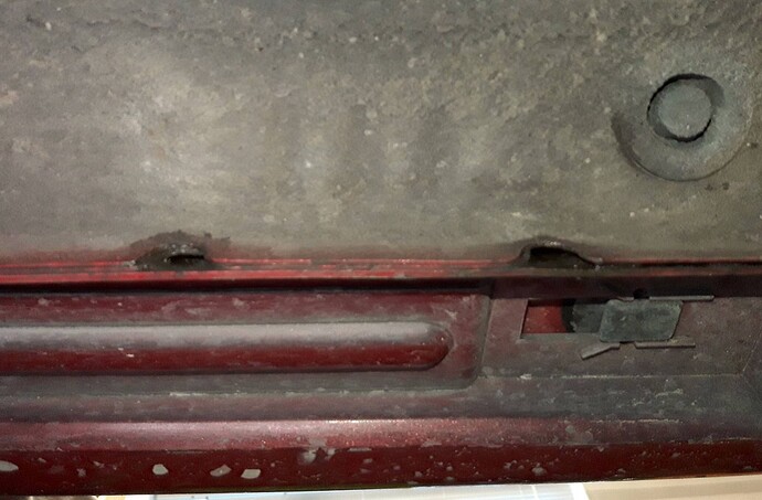

Sorry I am still struggling! Is it the 2 tiny holes on the left edge of this photo? I know this bit needs sorting out.
Yes! Well done, you found them! Now ram a screwdriver into them to make sure they’re clear!
Ah great thanks. Do you know what the other hole in the right of the photo is for? Presumably that lets water in underneath
It drains that little triangular cavity. But splash water can creep in there as well.
