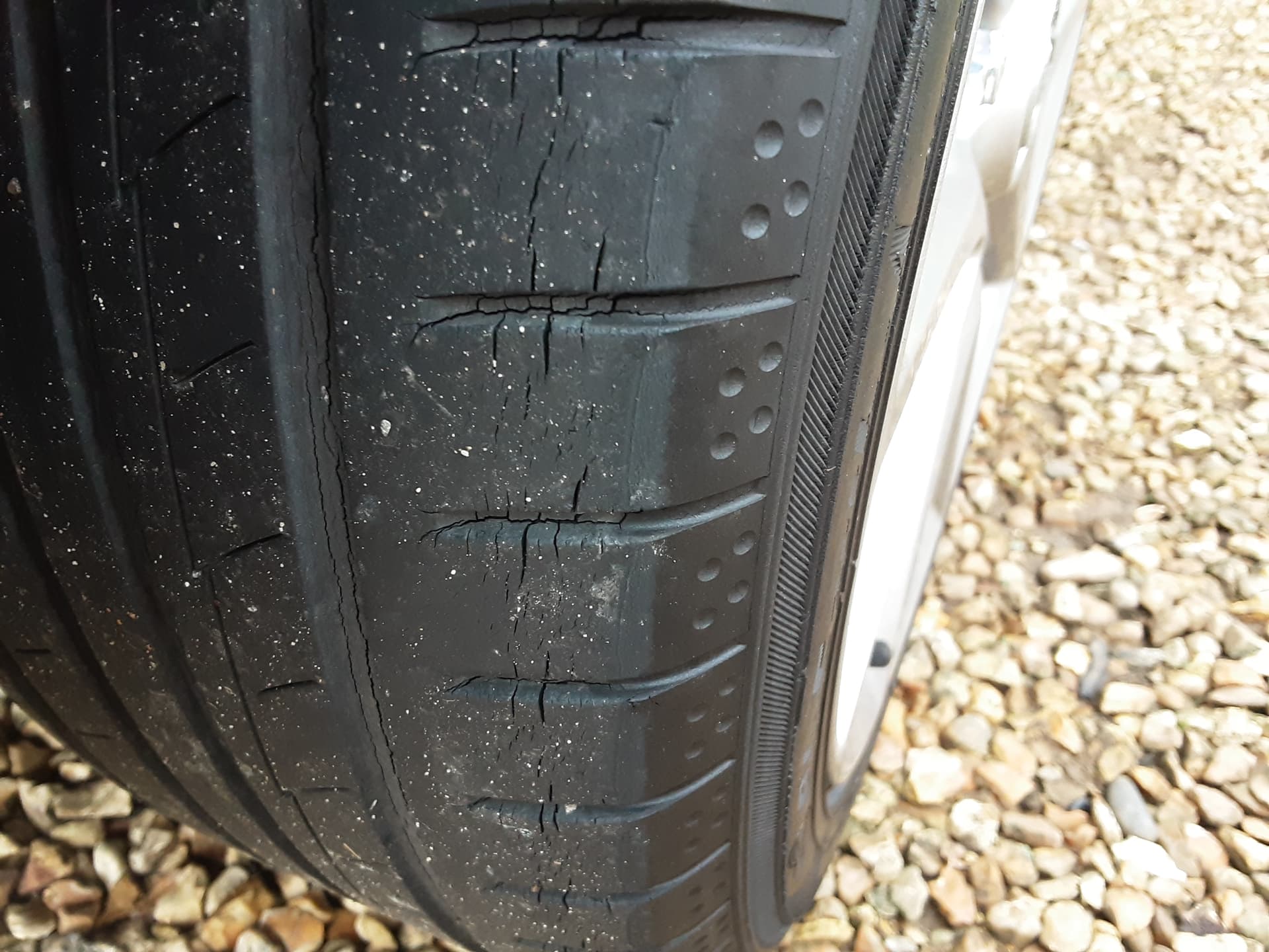

I bought my first MX5 2 days ago. I read up as much as I could about things to check, being particularly careful to look for rust. When I went for the initial look/test drive I noticed that the tyres had small cracks in them. I asked the dealer and they said they were nothing to worry about, that the MOT the month before had not mentioned them, and that it would have a pre-sale inspection and if there was a problem they would be changed. I put a deposit down and a week later collected it.

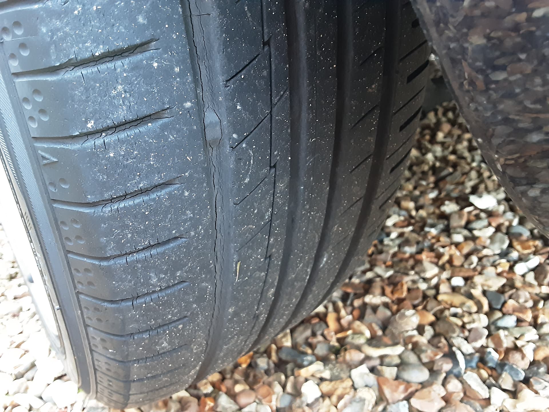

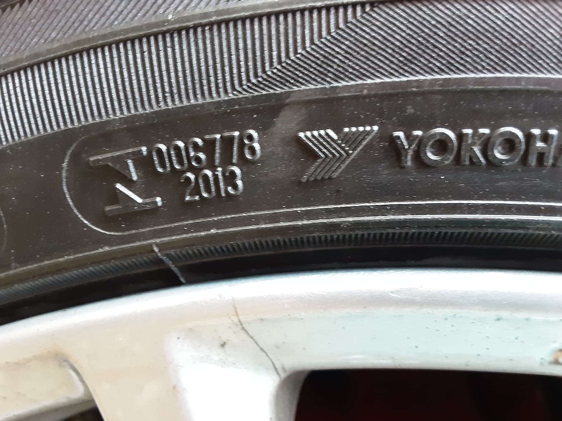

Looking at the tyres now, it seems from the stamp they were made in 2013, and have quite a bit of cracking. The tread is fine around 4-5mm which is presumably the main reason a dealer would change them. I don’t feel all that comfortable driving around on tyres that look like this that are 11 years old, but should the dealer bear any responsibility here? If they are technically legal and not flagged up in the MOT do I have any case that they tyres are not fit? Buying 4 new tyres days after shelling out for the car is not great!

This Yokohama web site (no idea if it’s official) says: “Yokohama recommends the replacement and disposal of all passenger and light truck tires whose D.O.T. production date is 10 or more years old, even if the tire appears to be undamaged and has not reached its tread wear limits”
It might be worth suggesting to the dealer who sold you the MX-5 that the tyres are outside of the manufacturer’s recommendations, and seeing whether they will at least partly recompense you for the cost of replacements?

Well dodgy if that tyre in the first picture passed a pre delivery inspection let alone an MOT the previous month.:open_mouth:

My local mot station would deffo have failed the car on those tyres ( or as a minimum - noted an advisory )

Tyres perish also on the insides. You cannot gauge what is going on there clearly. In my opinion. your tyres are potential blow outs waiting for a motorway to do it. So here we have 4 little footprints of rubber well past their sell buy. In addition, they “cure” over the years…they go harder…and it may be their grip left the building along while back. Youd not sell them on on Fleabay I’d wager…and you really ought not to have closed the deal with him/her. Come back? To quote you quoting him/her " if there was a problem" Well there sure is. for you though. The thing needs fresh rubber all round. I’d not even take it to Tesco like that. You could have a go at him and ask for a discount, but if he’s prepared to take chances with your life…he wont be too fussed opening his wallet. If he is an MOT station…well…they got roolz :wink:

No matter how rare the model I would not touch any vehicle with those tyres on, nor deal with anyone who thought they were okay because they passed an MOT. Those tyres are on a performance car for heavens sake and they are unlikely to be upto the performance of the rest of the car particlarly in the rain.
Sadly your only hope is the ‘so called dealer’ will make a contribution in light of Philips post re Yokohama recommending tyres be scrapped at 10 y.o. My recomendation particularly for a performance car would be Goodyear Assymetrics or Michelin PS regardless of cost.

The bottom line is that, while they may be acceptable for pootering around town, the tyres in the picture are the kiss of death for motorway driving at 70-80 mph, and I would not risk my life and that of others by driving on them at such speeds.

A crack in the sidewall will lead to structural failure, and is an MOT failure.
Cracks in the tread are not considered the same.
However the rubber will be hard and the handling poor.
