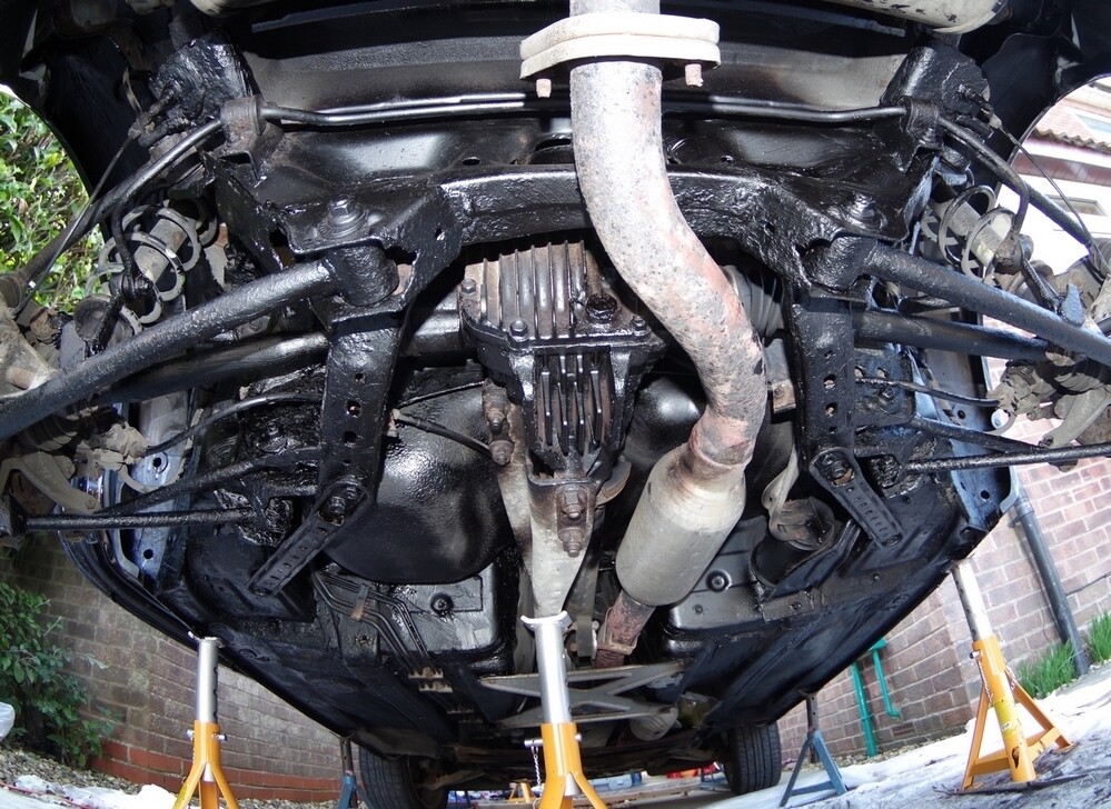

If you look along the sill (behind the plastic sill cover) towards the rear of the car you will see two raised pieces on the pinch weld, this is where you place your jack. Behind that lip it’s reinforced to take the jack (supplied car jack) or of course your trolley Jack head. I used a piece of timber on the trolley jack head and place it behind that lip to jack on. When high enough I get my axle stands under the rear part of the chassis rail just before the curve up, that part is reinforced so takes the weight. Then lower the car on to the stand, repeat for the other side if you want to get both sides up at the rear. Of course there is an easier way, jack on the diff, on the flat part of it, using a piece of timber again on the jack head. Caution though this method is not advised by some as it could crack the diff mounting brackets, I refrain from doing it by this method now after years of doing so previously with no mishaps.

Mick when you say place the stand under the chassis before it turns up do you mean in front of or behind the wheel ?
In the picture the two axle stands are placed just forward of the part that turn up at the rear, forward of the rear wheel.
It’s stronger there.:+1:
I’ve jacked on the diff in that picture, I don’t use that method now, jack on the sill.

If you look closely under the car that’s actually my Mk1 (now sold) same position though for the axle stands.:+1:
