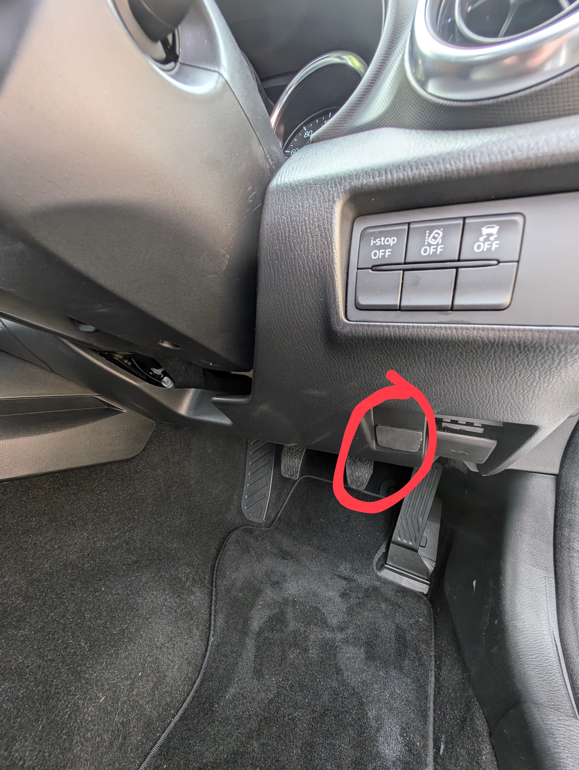

- I’m looking for technical help or recommendations on: __ODB2 port location
Is it here and if so, any trick to getting the cover off?!
No need to remove anything.
Look up behind the bonnet release - the obd port is vertical behind it.
Where is it on a NC2? Ive looked and can I find it? ![]()
Same place - behind the bonnet release - look up
