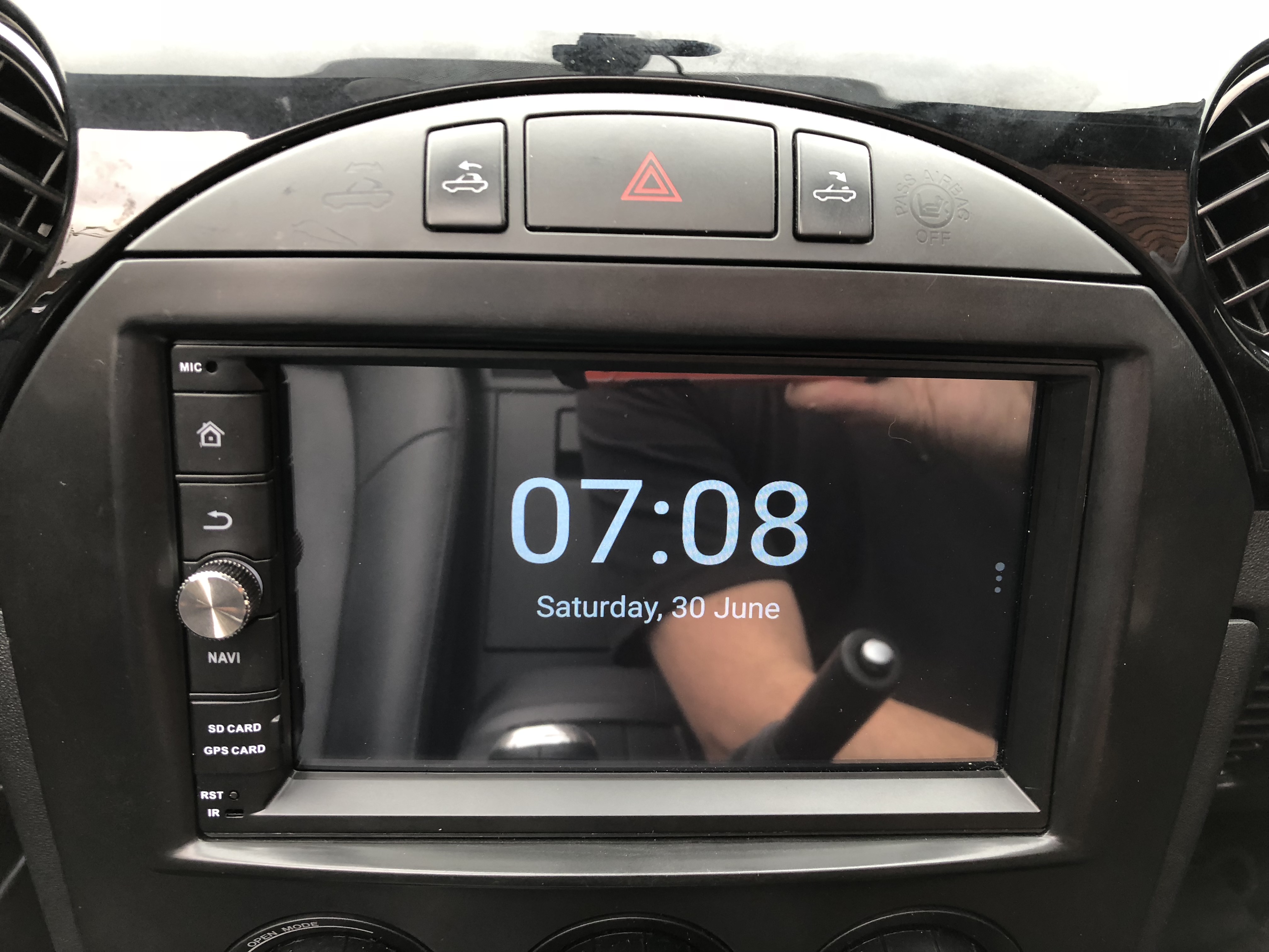

I fitted a Pumpkin universal 32gb/2gb head unit approx 2 months ago into my mk3.5 with Bose. I did quite a lot of research and put this off lots of times for various reasons…would it work with the Bose? Yes, just ensure you buy the right harness. Will it fit the fascia? Not straight out of the box, amost every Chinese head unit needs a mod to the fascia trim but wasn’t difficult and looks perfect. Would it sound ok? Yes, no hum or buzzing as I have read in other reports. Sound is actually noticeably better than the stock head unit.   I went for this model for a few reasons, main one was the interface and particularly the fm radio app, which is more up to date than most, inc the octocore units when I was looking at these. The unit I put in is RDS and displays the additional radio info in scro txt, eg art/song depending on the station. I also wanted a physical volume knob, the steering wheel buttons work ok, but I prefer a traditional control to turn vol up or down quickly. Unit is currently £174 +£17 shipping from Germany (4 days and no tax to pay) on AliExpres

Do they not fit flush.
I notice Natalies appears to be protruding a little.
Thing is, there’s a lot of wires to contend with, that can hinder getting the head units in flush. When I fitted my single din pumpkin with motorised screen, you have to get creative with all the wiring. From OEM harness plug, there is the adapter loom, from the other end of that to the head unit plug and loom, SWC adapter unit, external microphone lead, aerial lead, GPS lead, rear camera lead, USB Lead (possibly two) if you have ll that gubbins. Mine had a cubby under, in the double din slot so effectively double din. It took some routing of wires/plugs to get it to fit nicely. Once in properly, jobs done. AndyH aka b0builder made a great job of his, very neat and flush.

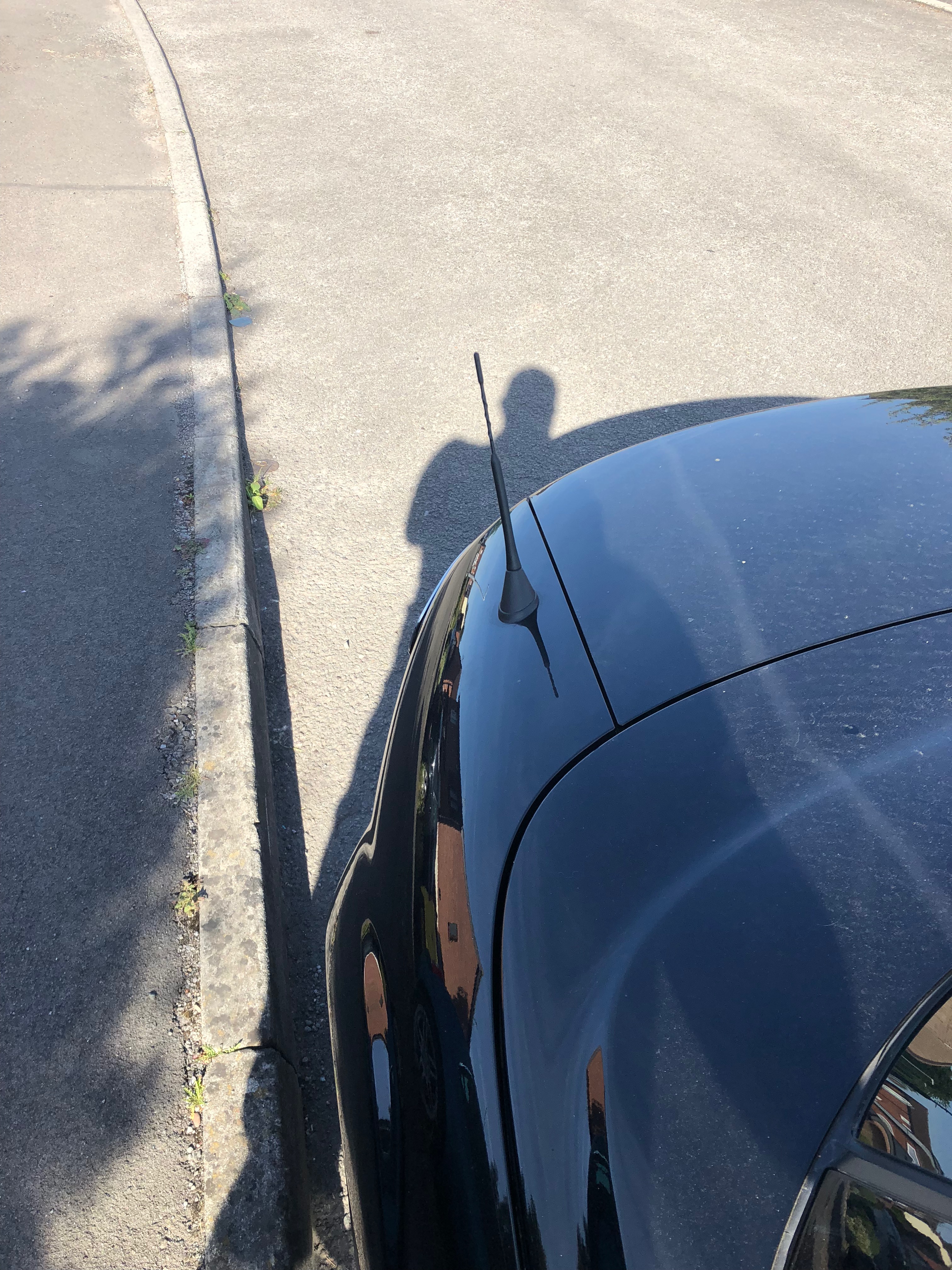

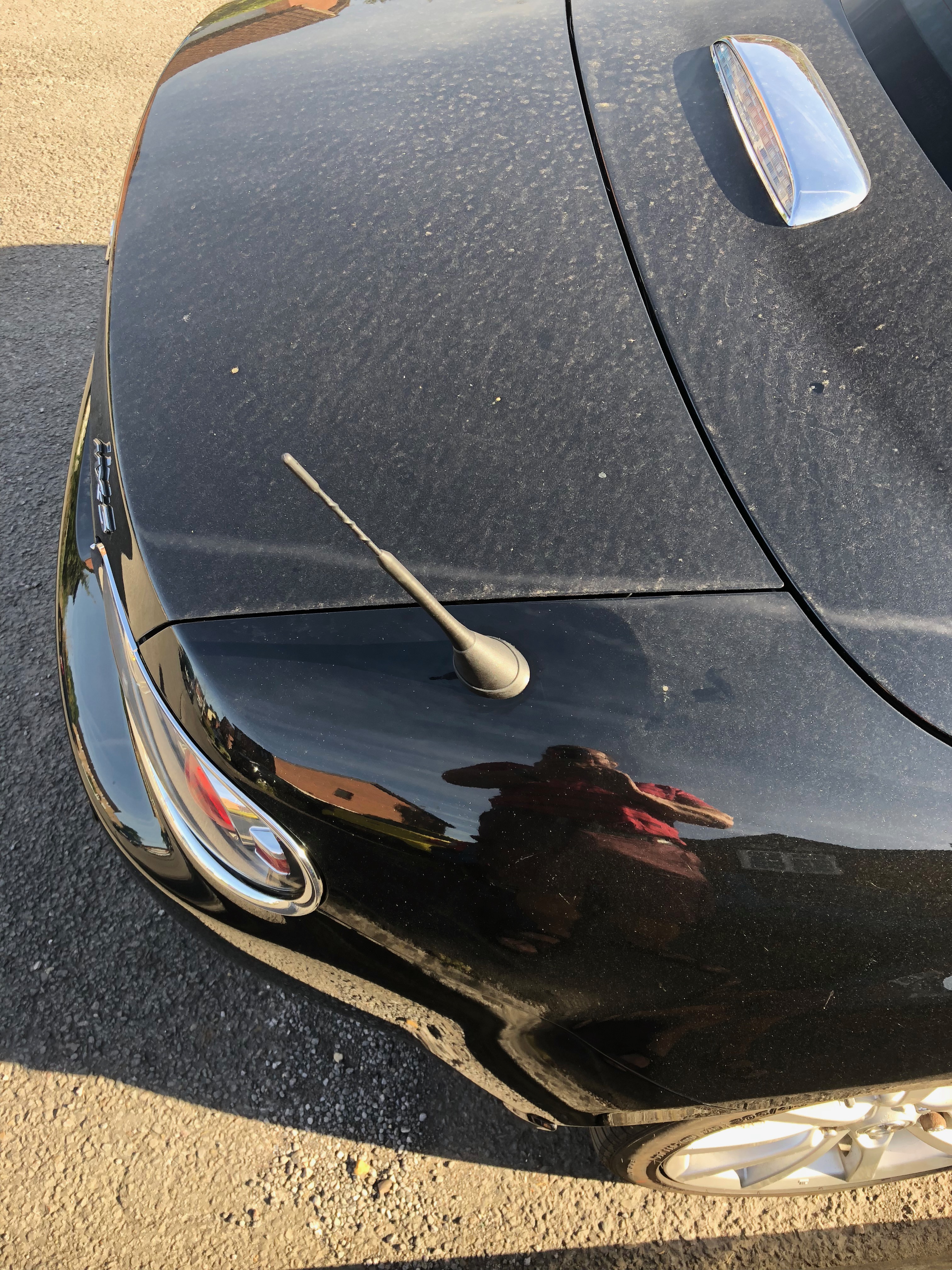

The combined DAB / FM Antenna installed (please excuse the dirt, it needed a wash…)
Looks good, those aftermarket aerials seem pretty much indistinguishable from the original (maybe a bit shorter, even? But that might just be the angle).
Its fractionally longer, and not as flexible. It’s angled back a little steeper, so I doesn’t look any taller than the original.
More aerodynamic then innit? Makes the car go faster
They can fit flush, see my photo above.
To help I actually made my own loom by solering the wires from the pumpkin iso adapter to the Mazda isoadapter I bought, thus removing 2 big chunky connectors, which helped a lot with the space behind the unit!
