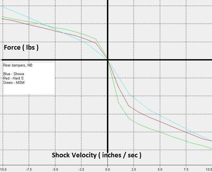

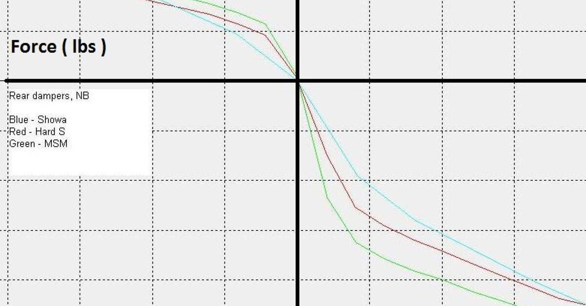

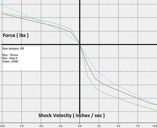

A very interesting article about these three different setups
The conclusion is that the Showa is better than the Hard S Bilstein, which was the standard Bilstein on NBs.
I wouldn’t be surprised if Mazda fitted the run out Sports with Mazdaspeed Miata (MSM) suspension. Not a lot of MSMs were made, probably too few for an order from Bilstein.

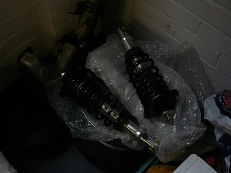

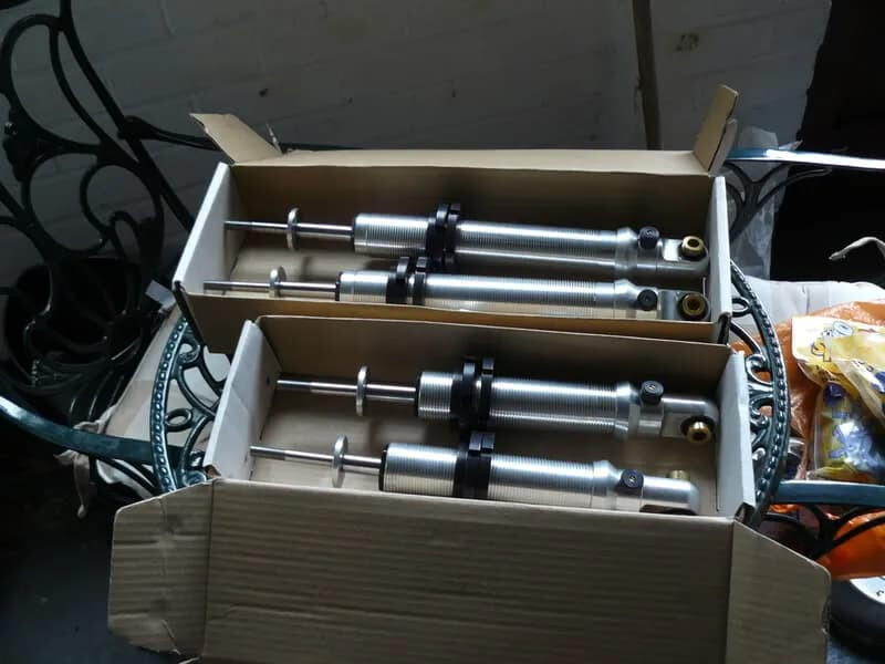

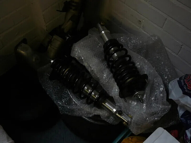

Well, its the Performance 5 Puredrive setup which used Protech shocks. Performance5 are no more (for reasons best not to go into), but Protech are listing shocks and springs for the MX5.

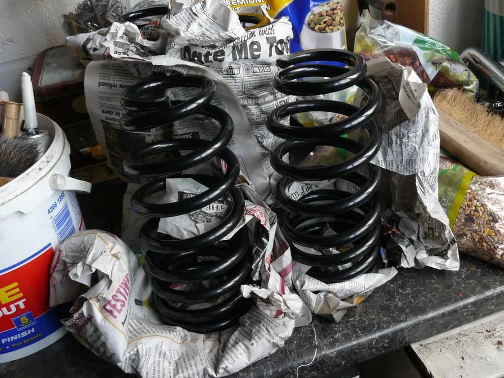

I’m not sure these are exactly the same; the Puredrives used the standard skinny spring perch Protech uses, with Mazda top hat hardware, so the spring was a pigtail (diameter bigger at the top than bottom.
When shiney and new in 2008
So fitted in 2008, so getting on for 100k kms now. I suspect they are not so shiney now, and the adjusters are seized. But I’ve haven’t felt the need to touch that in over a decade. Its on a mid setting, slightly stiffer up front by a click. The ride is lovely. Unlike Meisters which I had on anther car, it ripples over catseyes. In those 15 years, I’ve had to replace the rear bumps stops once, and the rear shocks needed a rebuild after one popped a seal during a trip to Cornwall. The paint on the springs is, not surprisingly, flaking off everywhere.
The USP of the Protechs is their alumnium construction, so very light. But brass adjusters and aluminium don’t mix.

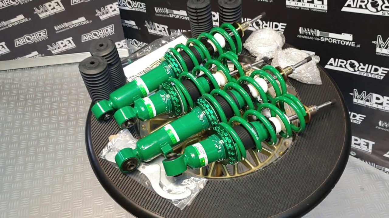

If one of the shocks pop now, I’ll likely look for a new set. Maybe Protechs, but also the Chinese Tein Street Advance Z kit; seems very well priced. Tein brought the price down of their shocks by setting up a factory in China, with Tein QC
