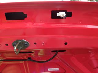

The black plastic blank can be prised out, here’s a picture of my boot lid after I removed it, gives you an idea how it fits, the hole on the left.

Your boot lid looks different from mine  -->> Boot Lid
^^^ Yes it does, mine doesn’t have the usual paint blisters.
Sorry, it should be the same under there blank plate two plate lights either side of it.
It looks like yours needs treatment, paint lifting around the plate
Ah, yes, closer look yours has not got the bulb holder attached.
My plate looks to be a full rectangle and yours has a tab/lip to one side ?
