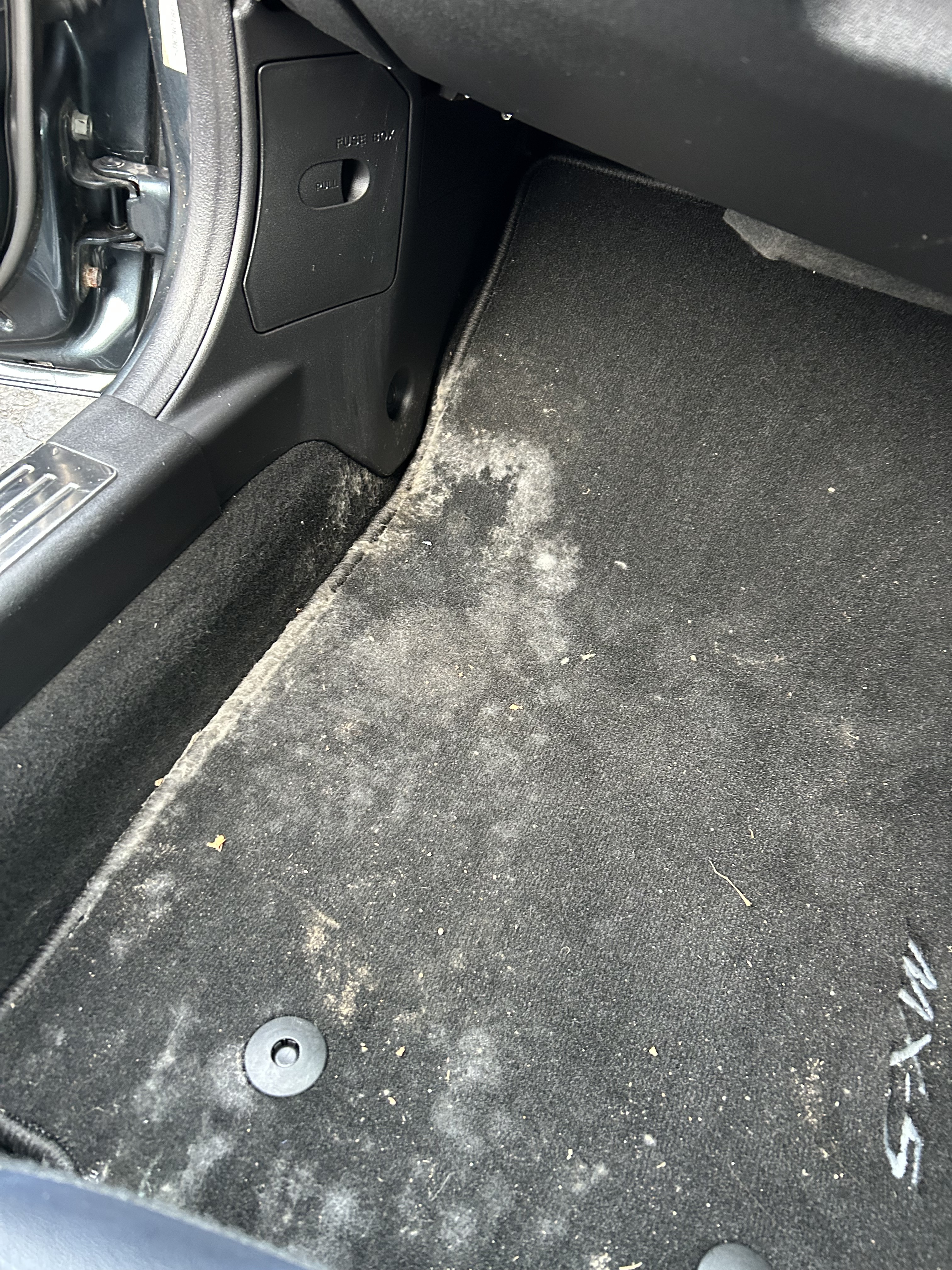

Just found N/s footwell wet and mouldy, not been in car for about 3 weeks. I’m guessing this will be the drains under scuttle panel from reading through the forum.
No water damage visible in fusebox but some horrendous white noise/ feedback coming through all speakers even if radio is off ?
Any ideas on where to start?
Nc 3 hardtop!
Thanks in advance
I would take out that fuse box cover panel ( not just the access door ) and look at the full fuse box.
There is a lot more behind that panel than the fuses you see through the door.
