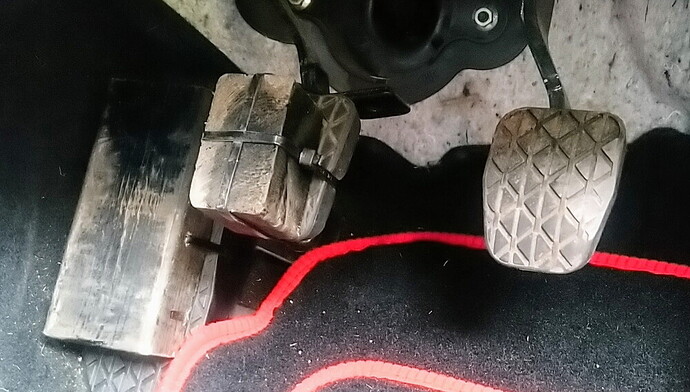

block of wood zip tied to the pedal - and the foot rest too if required
Cheap fix. I like it. Does it stay in place though ?
That’s what Short Round does in “Indiana Jones and the Temple of Doom”.
Hasnt moved a mm. As you can see - it’s tied in 2 directions
Mind you the zip ties are exceedingly tight and MOT tester hasnt noticed or challenged it in over 5 years
