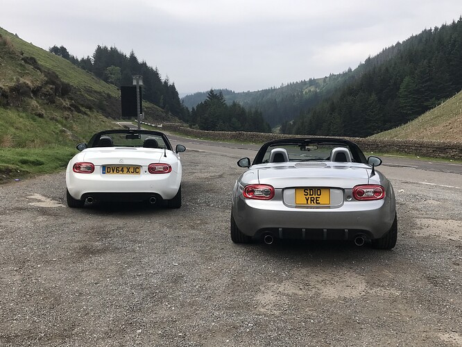

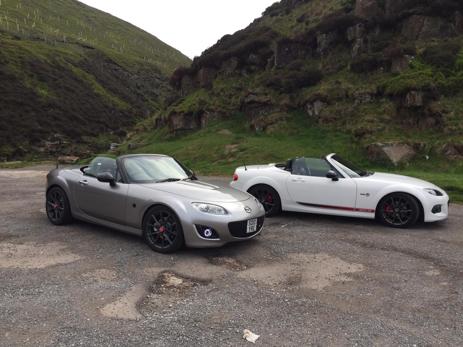

I have standard 17 x 7 rims (et55) with 205 tyres. Using 25mm spacers all round (et30 effectively) lowered on Meister club race. No rubbing at all. An extra 25mm on rim width, reduced slightly by the extra 5mm offset you propose, may be too much? Work may be required to prevent conflict between tyre and arch.
Not the best pics to illustrate where the wheels sit but should give an idea. They are right on the edge of the bodywork so still legal.
Mines the silver car.
