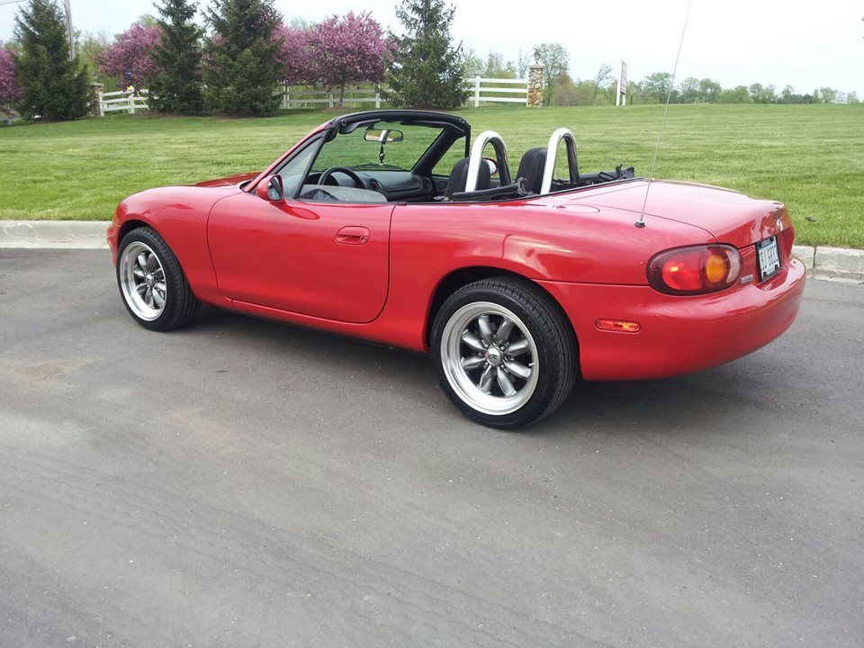

Anyone know which, if any, 15" wheels will give me that “deep dish” or “stanced” look without any modifications? Most wheels seem to be 8"x15" with a low offset of 0. Below are some that I like the look of.

8x15 will fit bodywork as long as they have about a 35 offset. 0 offset will require bodywork mods
It also depends on which 2.5 you have as not all 15" wheels fit over the bigger brakes of some of the Mk2.5
