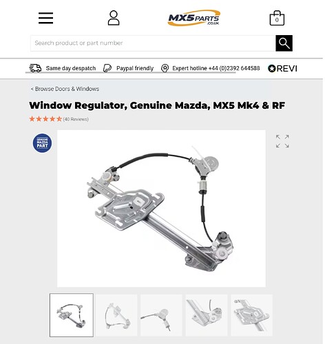

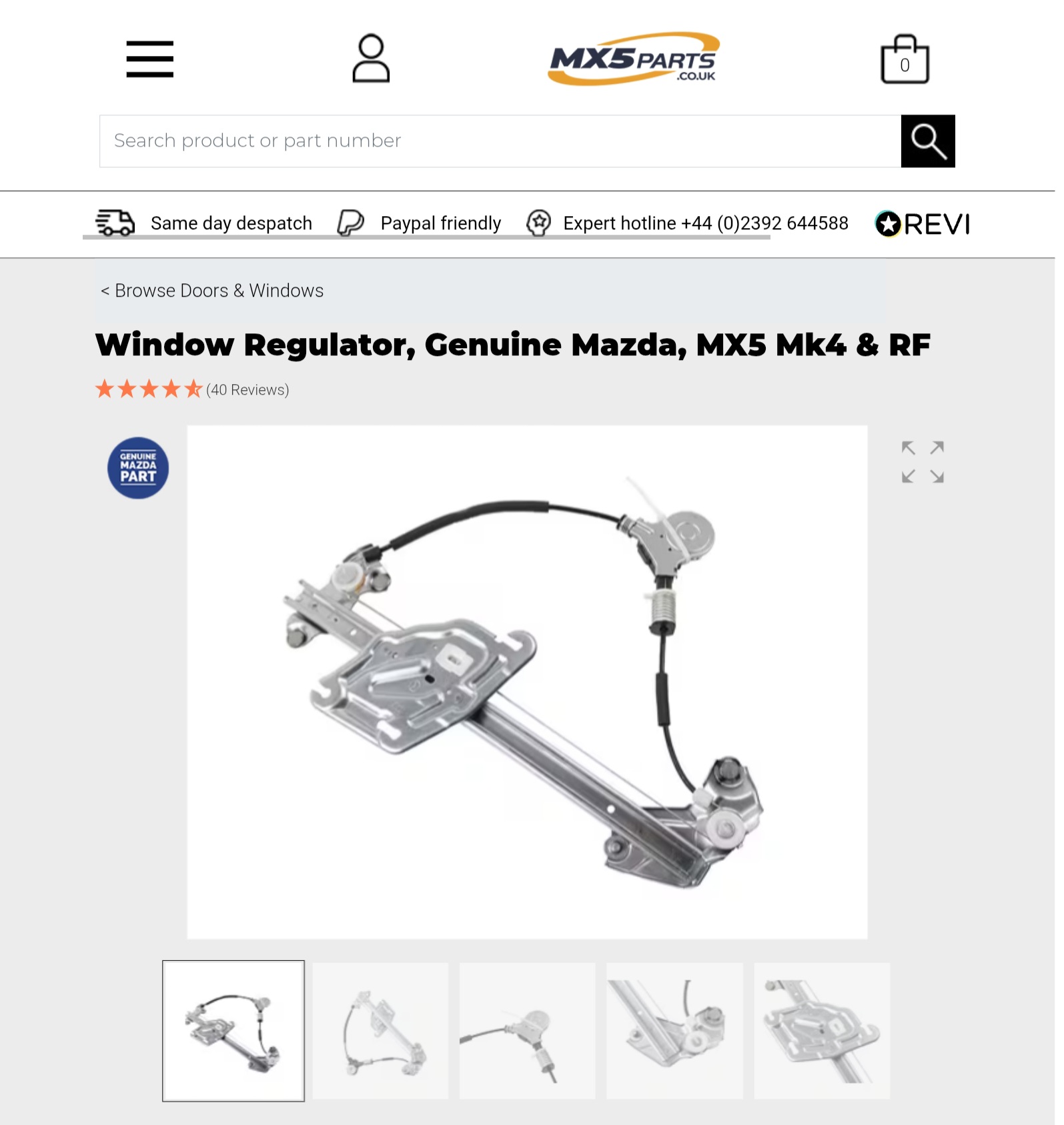

My MX-5 RT 2019 needs a new window regulator as cable is frayed. Any recommendations for who I can get to fix this part. I’m in north Cheshire.

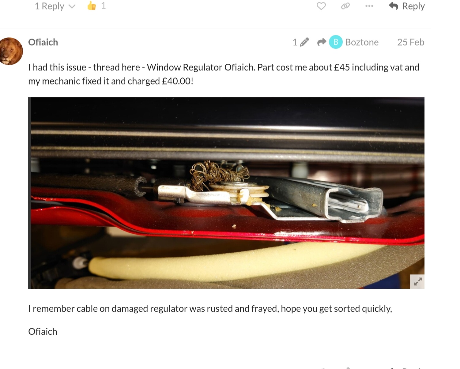

Hi! I had this issue on my 2017 RF!
