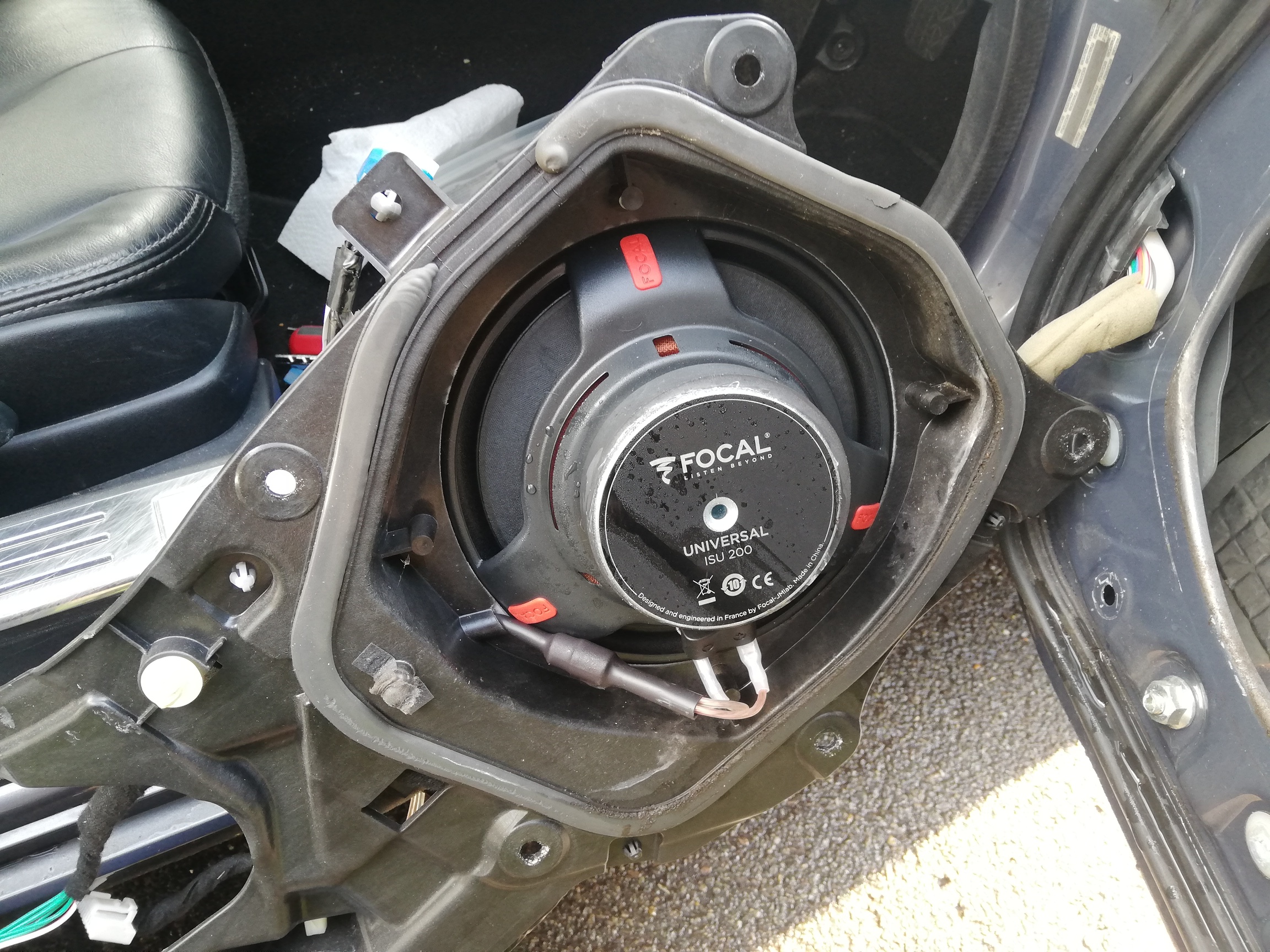

So door card is off and I see that my Focal speakers are catching drips that should end up in the bottom of the door and exit via drain holes.
This then pools in the bottom of the speaker housing and seeps through he seal allowing water to run inside the door and collects on the rubber seal until the door is opened and he water then drips out.
So I need ideas.
I can’t just stick on a sheet of heavy duty polythene or similar as the speaker will blow it off when cranking out Electric Six at motorway volume.
I am wondering if the top part of the seal is meant to be missing an inch or so (see picture above) - if not maybe the water is dripping in there? Anyone know?
I could take the seal out and replace it with a glued on P section of rubber.
I could cover the top half with heavy duty plastic sheet, and hope it doesn’t flap and distort the audio.

I’m trying to remember how the speakers went when doing mine, I fitted the JVC ones.
I definitely removed a water deflector from OEM speakers (it was stuck firmly in place) but I managed to part them and transfer to the new speakers.
I can’t see said parts on yours.
No, left the semi hard foam shields on the Bose when I sold them. Will have a think how to fabricate something similar.
Yeh, my speakers had a plastic shield on them, and I think I may have refitted them to the new speakers.
