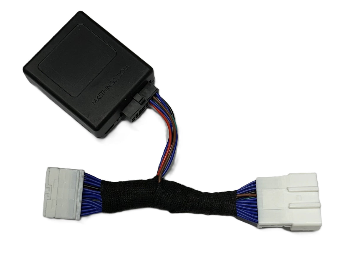

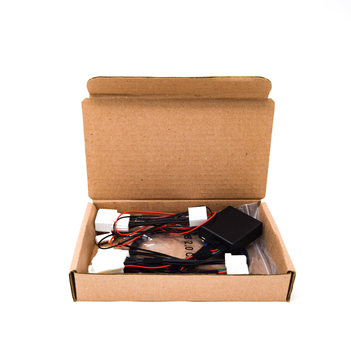

I know there is an aftermarket window and roof controller that allows for various additional functionality like operation by remote, but that’s as much as I know.

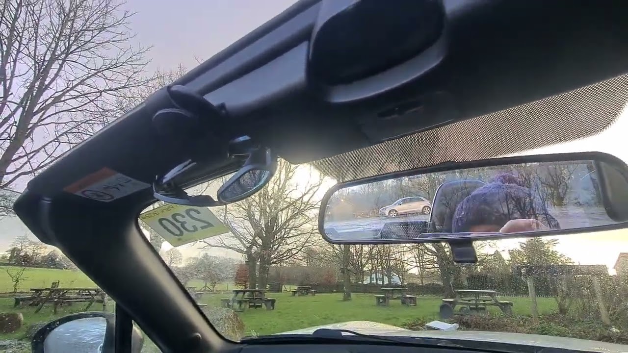

There is another workaround option, certainly cheaper than replacing SWMBO or the more advanced kits above :slight_smile:
Credit to @AdamR28 for this one:
Same answer.
Clever ! Thanks
What’s going to happen if I won’t open the door? Will the roof squeeze the seals ?
You need to allow some movement between the top of the window and the roof when it’s latching or unlatching.
Hence needing the door open, so the glass drops slightly.
The switch is also used for heating system, alarm and audio. Seems a bit extreme to jam it in the roof closed position to me.
