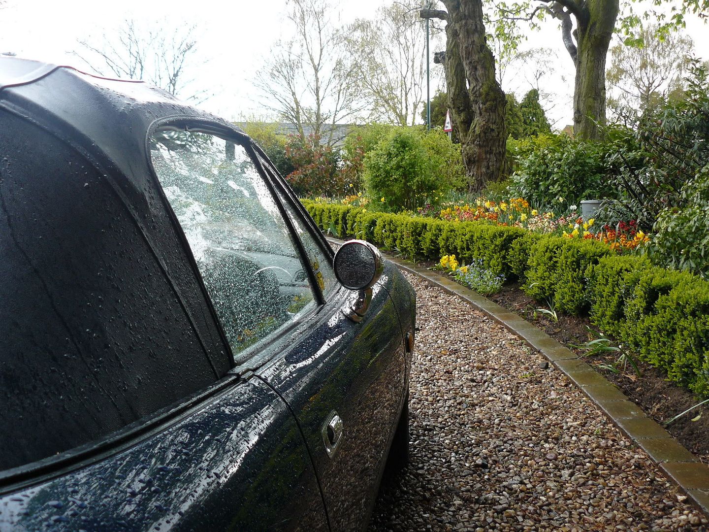

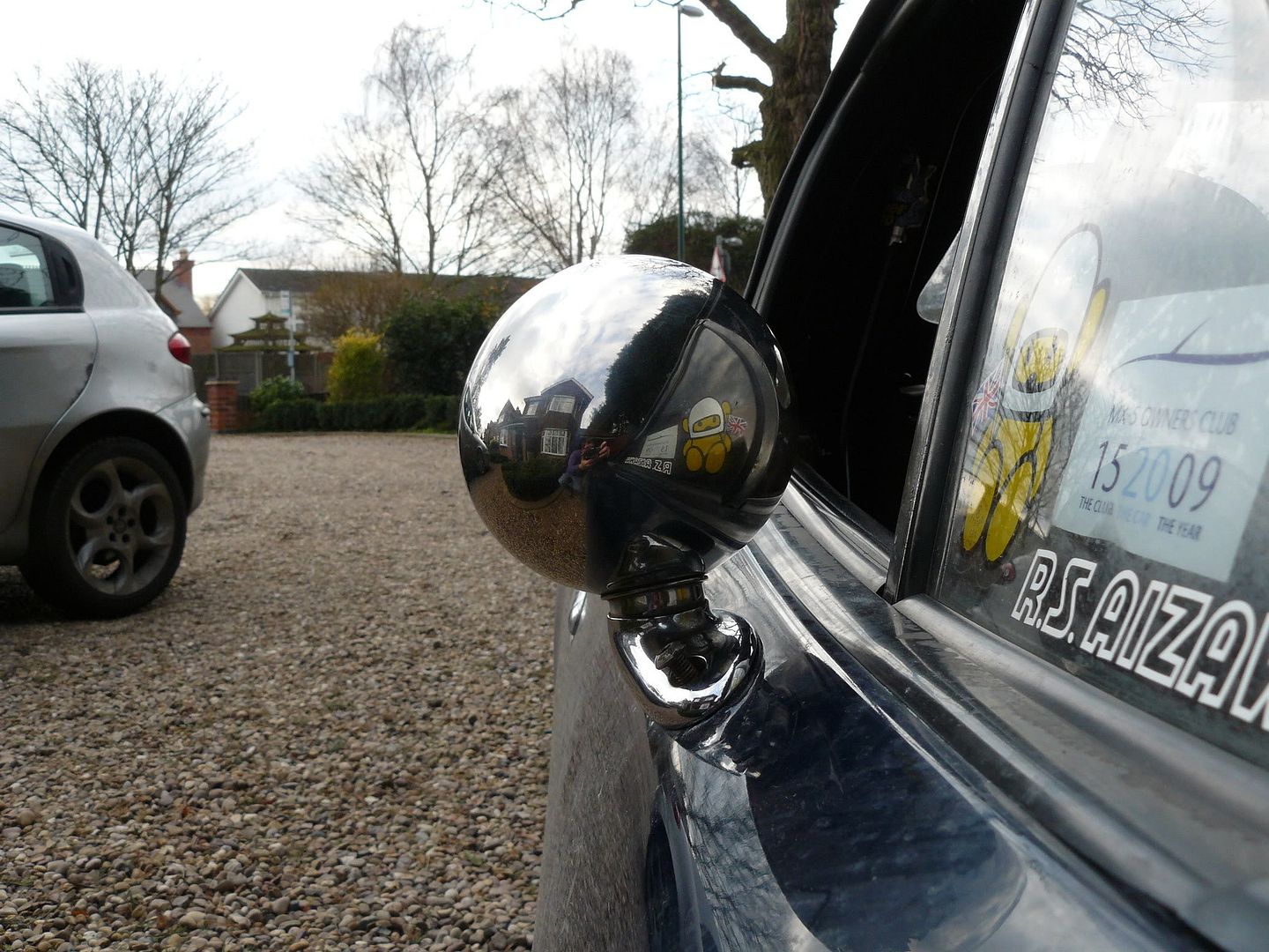

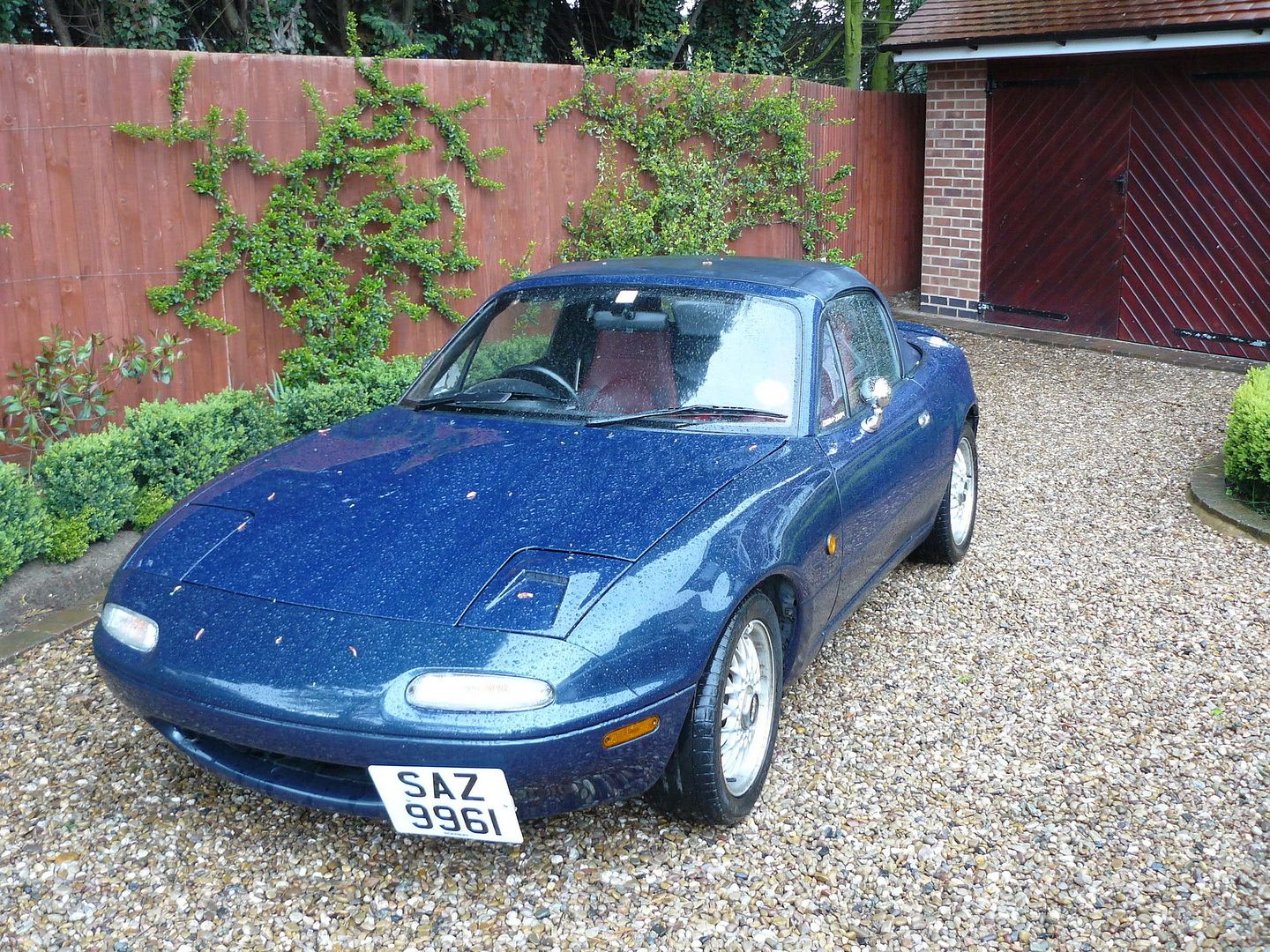

KG Works mirrors are like the rest; cheap £20 rusted, pitted generic mirrors on over priced adapters. For that reason, I made my own.
After a bit of research, I discovered that the much vaunted Runabout M2 mirrors were in fact supplied by Tex Automotive of Oxford, and are a variant of their “Evolution” mirror, which costs less than £50 a pair, rather than the £400 demanded by Runabout.
I made polished aluminium plinths, using a £5 block of aluminium, and a couple of weekends, to enable fitment of the Evolution mirror, which uses a Mini-fitment base.
Runabout M2 and Tex Evolution compared.
The Evolution has the swan-neck base.
Runabout M2:
Tex Evolution on custom plinth adapter
I had Runabout M2s on my M2-1002 roadster. The Evolutions are much the same; lousy as far as usefulness as mirrors go. All bullet chrome mirrors will lead to a restriction in view compared to factory mirrors. Obviously, a preferable solution would have been to persuade Tex that they would sell a lot more of their mirrors by providing proper MX5-fitment Evolutions to UK MX5 owners, rather than the chancers at Runabout in Japan.
