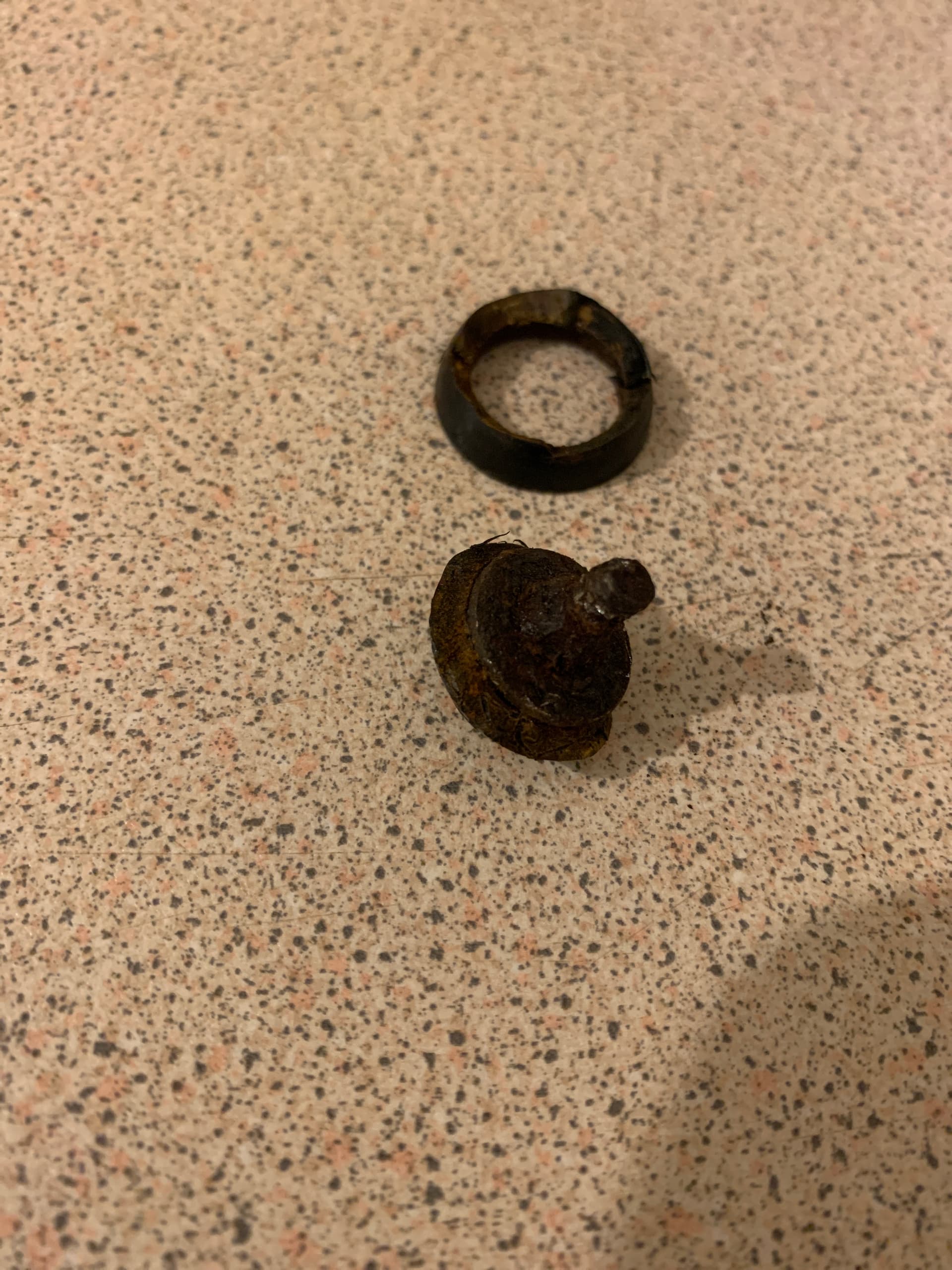

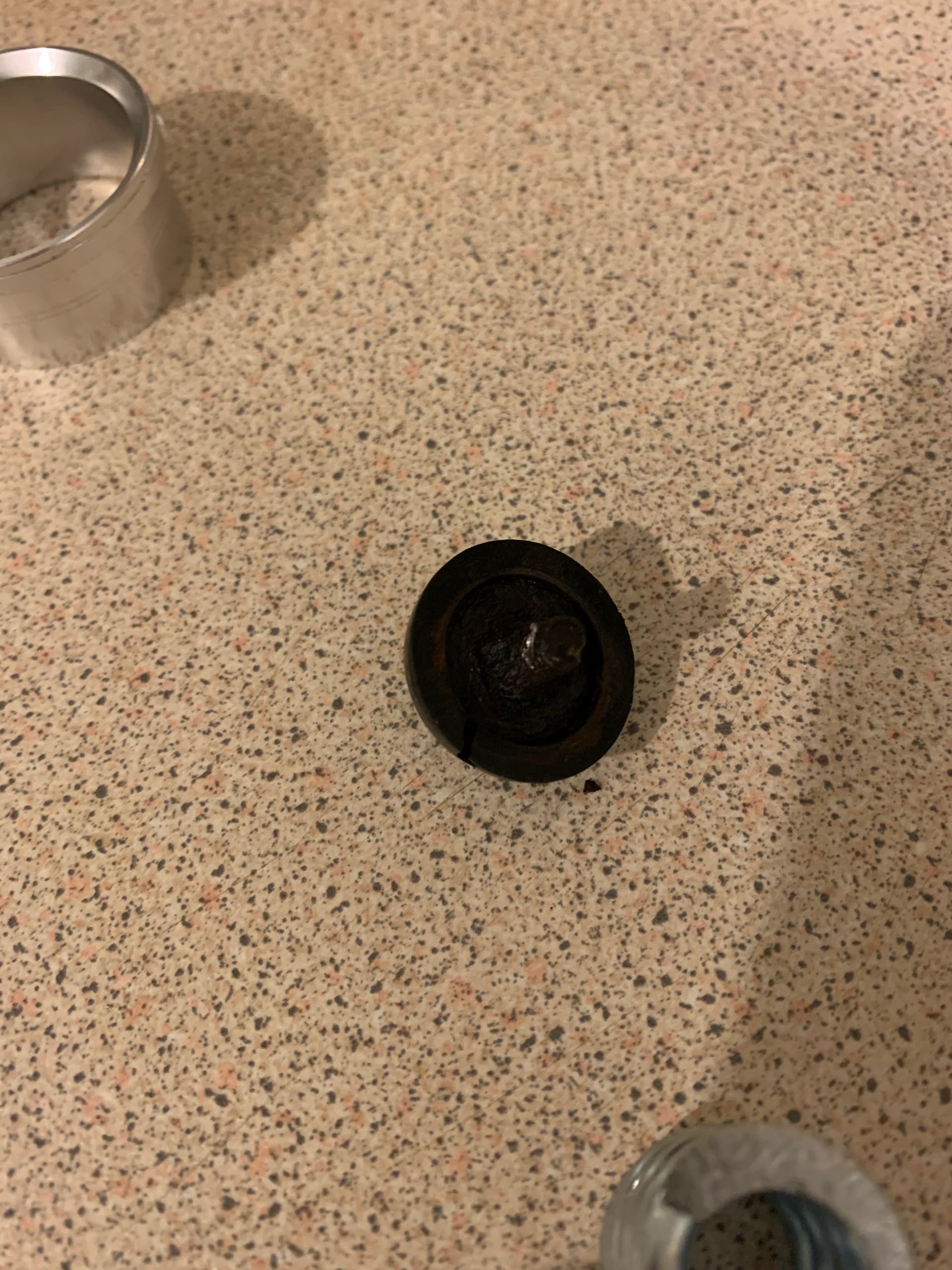

The domed piece has now been cracked by me trying to get the old bolt out - which I still haven’t managed to do - it’s rusted in solid!!
Any pictures.
M-m
Pictures of the dome bit a little further up the thread.

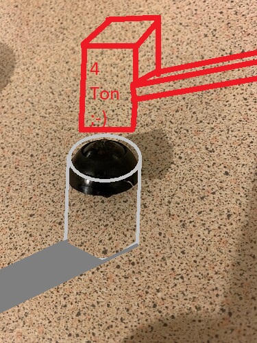

I’m afraid it’s several years ago now since I did them, but I think this was how I got mine out eventually and I know once I’d learnt how to do the first, the second mirrors’ dome was easier:
Jam them into a small enough socket so the lumpy part sticks out, and whack it with a hammer, or with the socket on a handle, against solid concrete driveway.
Yes it then jams inside the socket, but a narrow screwdriver from the other side of the socket releases it.

I’d also reckon that a dab of super glue will fix the cracked outer piece, in case you didn’t know that’s three pieces you have there, the metal thread, the plastic dome, and the outer (now cracked) retainer.
Unfortunately, trying to knock the old rusty bolt through is how I managed to crack the domed section - it really is rusted in solid.

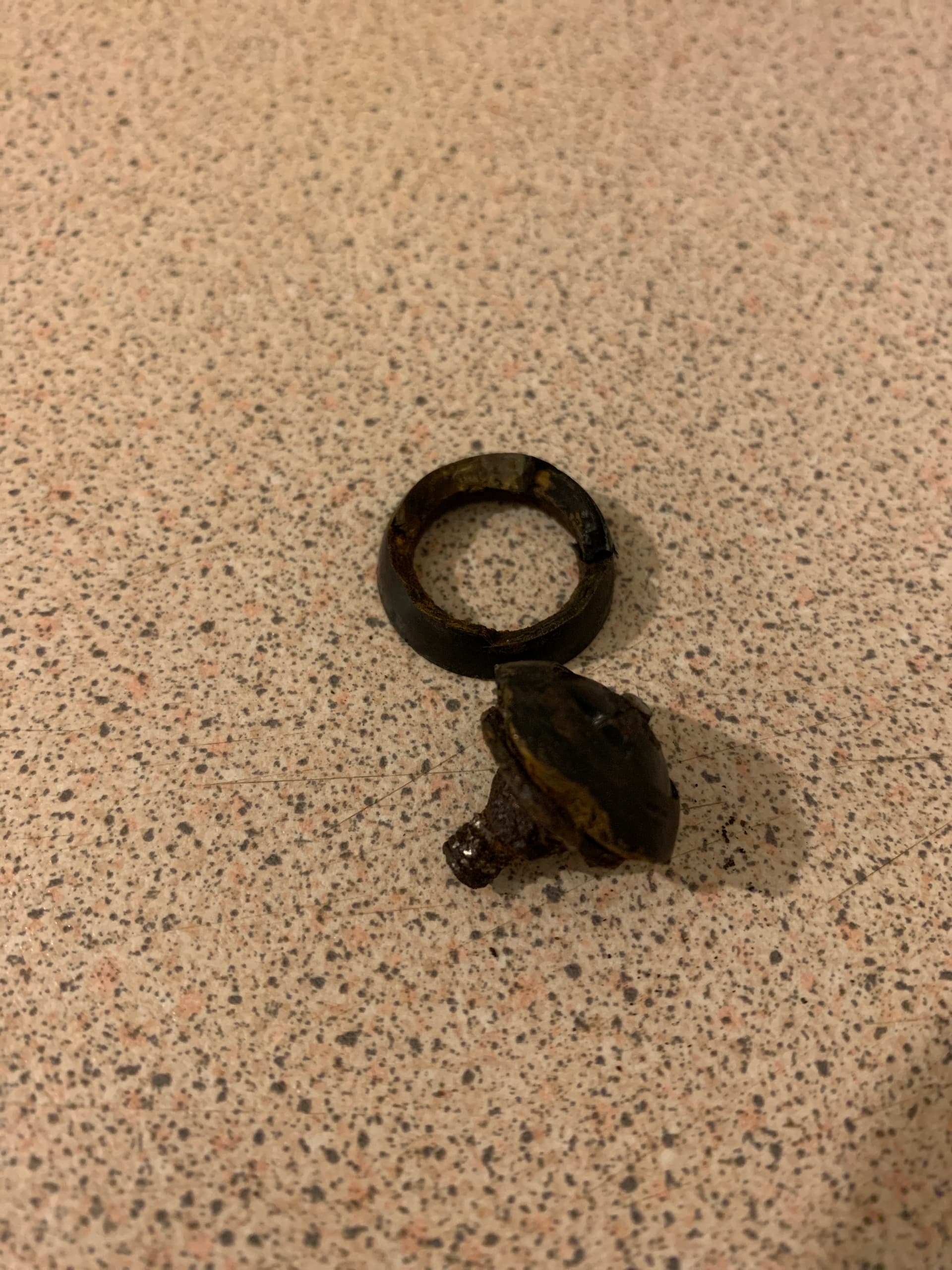

Since the part is cracked, could you prise it off the dome sideways so that you’re only left with the dome and bolt to contend with?
Unfortunately, as I thought, the outer section has completely broken and the inner piece is still seized solid!
