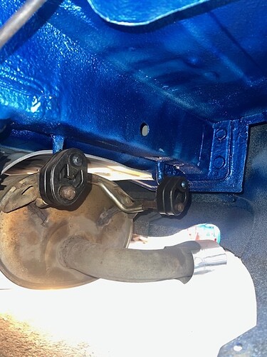

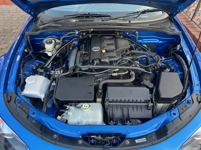

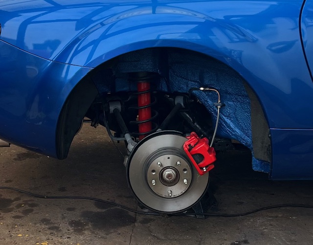

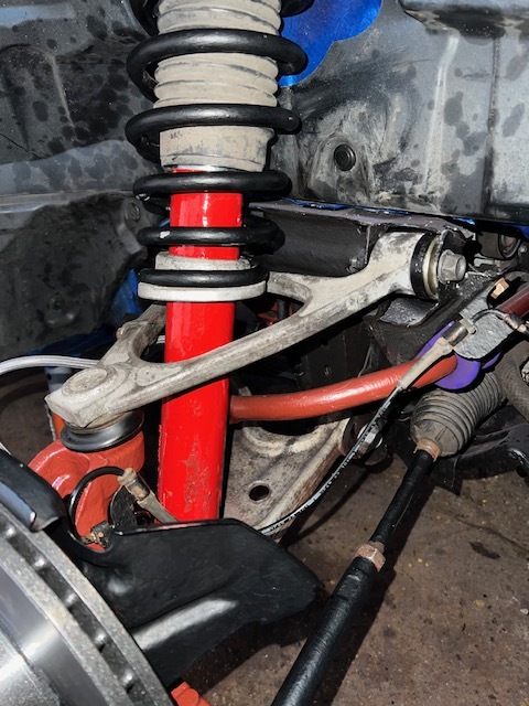

To get the car I wanted I carried out the following over the winter:

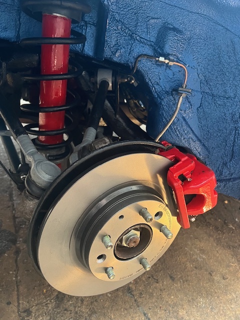

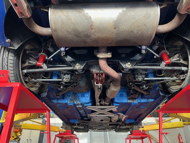

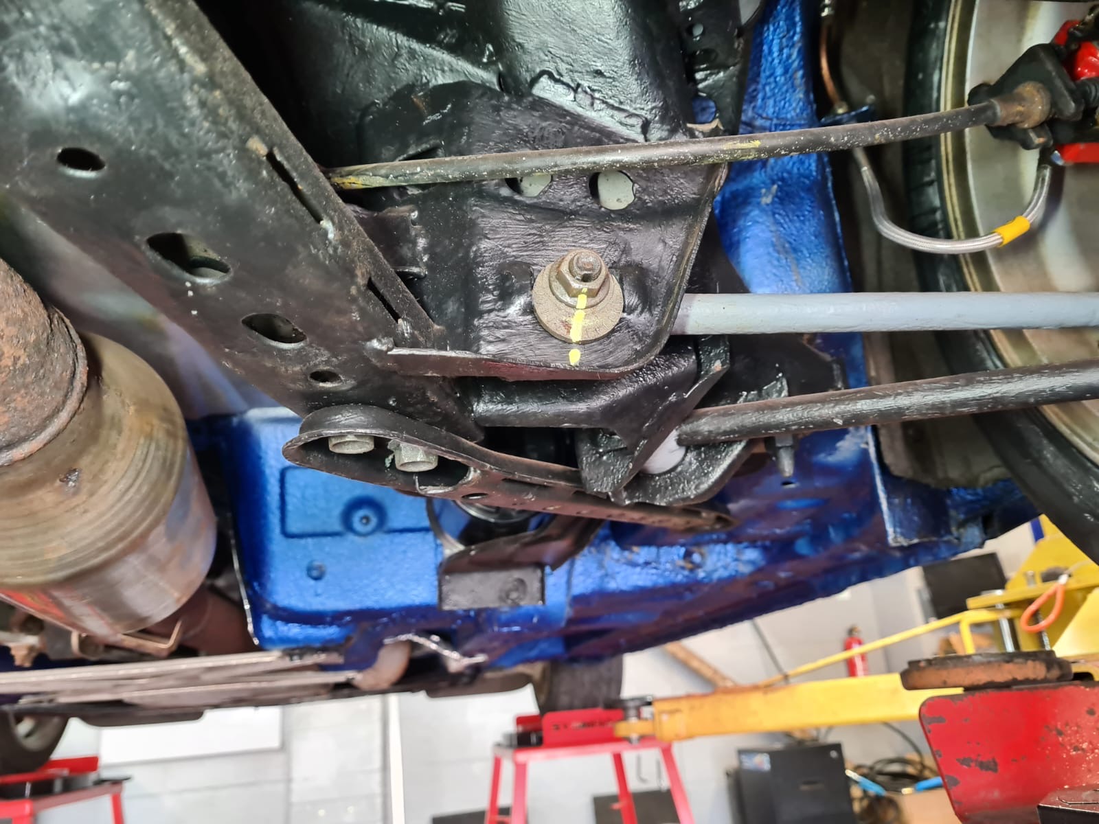

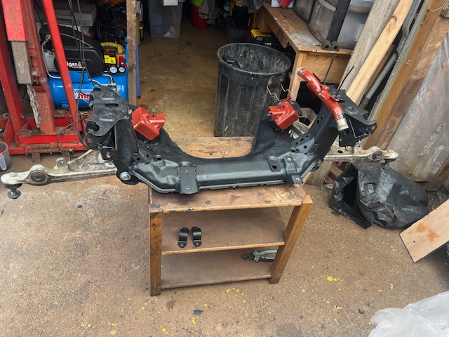

Renovation Activity
Front and Rear Sub-Frames and steel chassis braces media blasted, finished with 2 coats of epoxy steel renovation paint and internal cavities waxoiled.
Under body corrosion removed as far as possible, any remaining corrosion converted. Two repairs carried out to rotten sill closing returns at the front lower of the rear arches. No other rot found. All areas finished with 2 coats of epoxy steel renovation paint, seams sealed with Tiger seal (including seams not sealed from factory -why not??). Gravitex stone guard applied, finished with body colour. All cavities and external surfaces waxoiled.
All Steel suspension components media blasted and finished in two coats of epoxy paint.
Service Activities - Replacements
Engine coolant header tank and coolant
Engine oil and Filter
Gearbox oil and prop shaft seal
Differential oil and half shaft seals
Rear suspension arm ball joint dust covers
Brake and Clutch fluid
Rear light cluster seals
Anti Roll Bar Drop Links
Hankook V12 tyres
Upgrades
Powerflex Road Series Polyurethane suspension and diff carrier bushes
Eibach 30mm Lowering springs
Brembo discs and pads
Stainless steel braided flexible brake hoses
The result of the work is that I now have a “new” 2007 2.0 NC that drives superbly and should last me. The road feel and handling has been transformed, no more “floating” and, although I can feel every nuance of the road, it is not harsh at all. Just tight and controlled. The Powerflex bushes and Eibach springs are highly recommended. I am on rails and the car seems to turn in when I just think about the corner. I am nowhere near any driving limits yet, the brakes are still bedding in, but it feels like I would need to be teenager daft to get in to any real trouble.
All in all, for ÂŁ7.5k all in, I am now getting more smiles per pound and more smiles per gallon than I have ever achieved before. (my 3.0 capri may have come close though!)
I carried out the work on axle stands in a single width double length garage. At my age I don’t think I’ll be doing it again!
Apologies for the long diatribe but I am actually really proud/pleased with what I have achieved. Life feels good…
