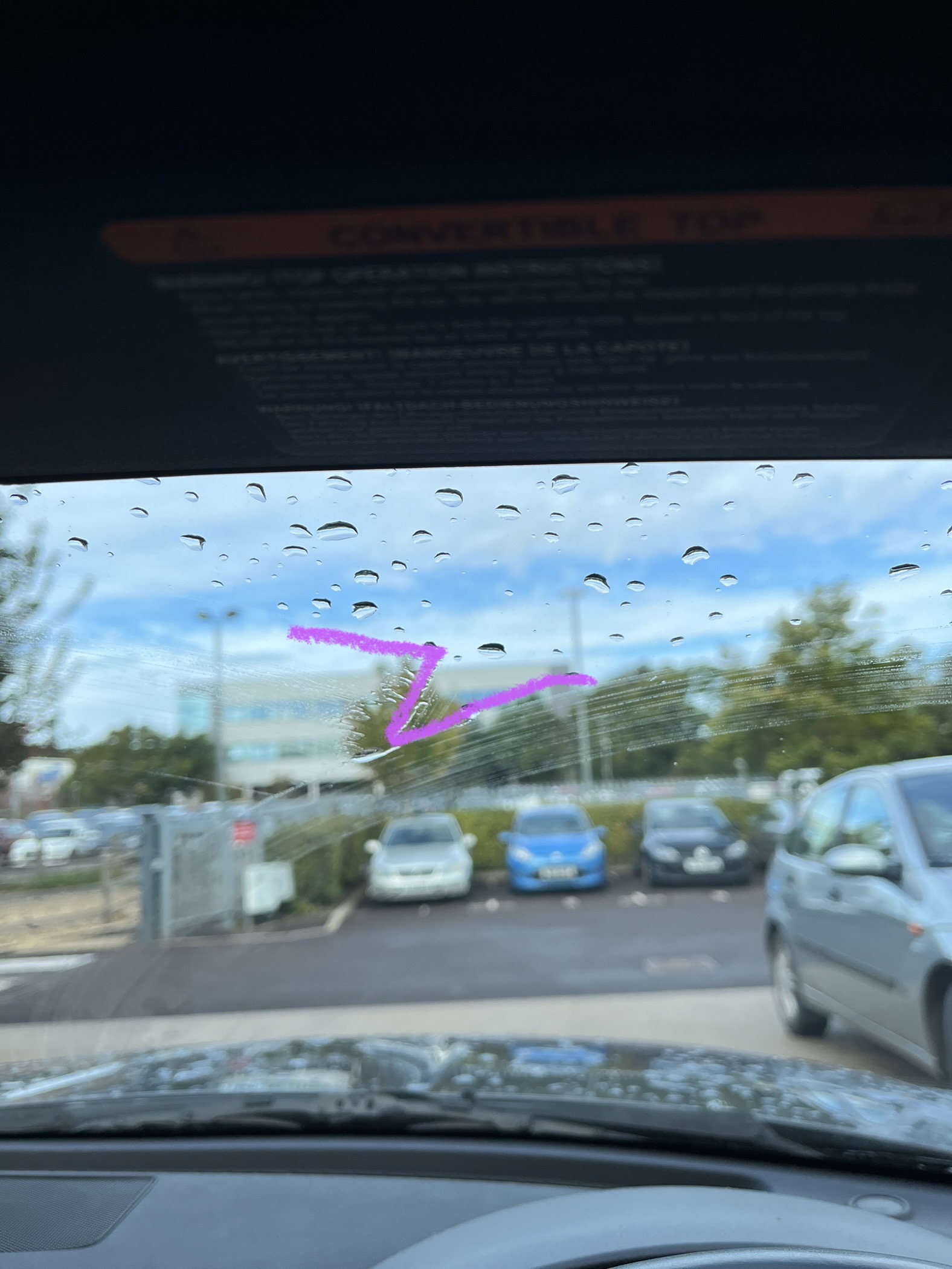

My wiper sweep has this weird V at the top, presumably just a matter of moving the left hand arm around a notch or two? I can’t imagine it came from the factory like this?

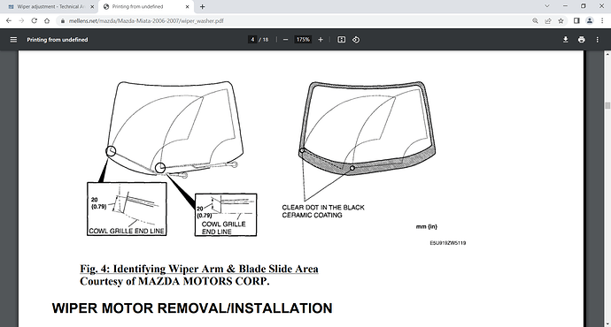

This is the workshop manual dimensions for setting the wipers.
Another thought - are the wipers the correct length ?
I’ll check their position before I measure them, this is brilliant, thank you :+1:
The triangle of doom.
Near side wiper was in the wrong place, all fixed :+1:
