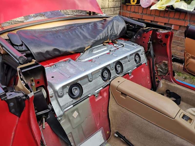

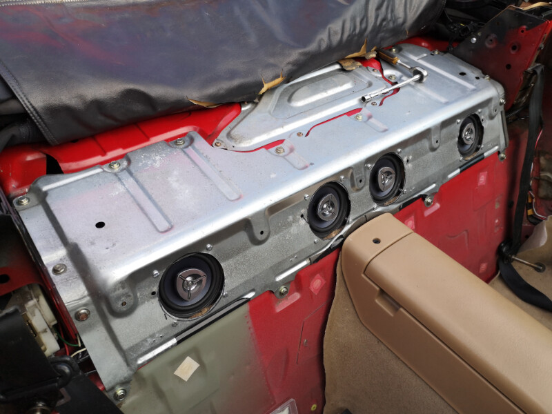

Evening folks! I’ll be replacing my almost knackered oem stereo soon with another double din unit (not fussed about having a touchscreen DAB one), and I want to utilise the rear speakers in the windbreaker (donated by a friend who was breaking his SVT). It has the female loom plug in situ but does anyone know where I can get the male plug with wiring harness to fit under the transmission tunnel to the head unit? Fleabay has not been any use unfortunately… TIA :upside_down_face:
You are going to need to run the wires from the head unit ISO lead, the wires will be on the ISO lead for rear speakers , and run them to the rear shelf for connection, no loom with plug can be bought, the only option is a breaker that will cut it out for you to be able to join up to,the speakers in the so called wind blocker are not that great , so don’t expect a great difference in quality in sound.

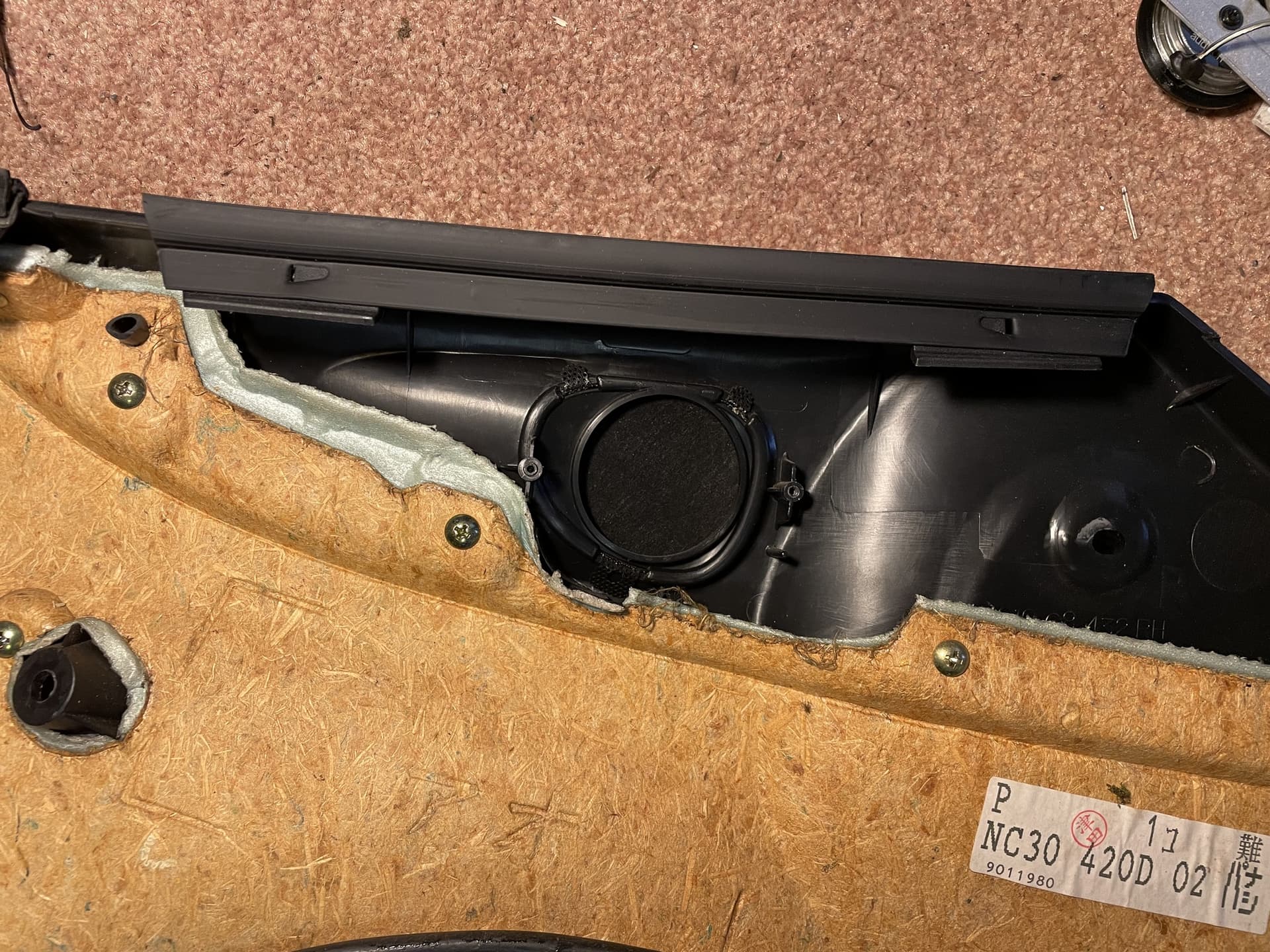

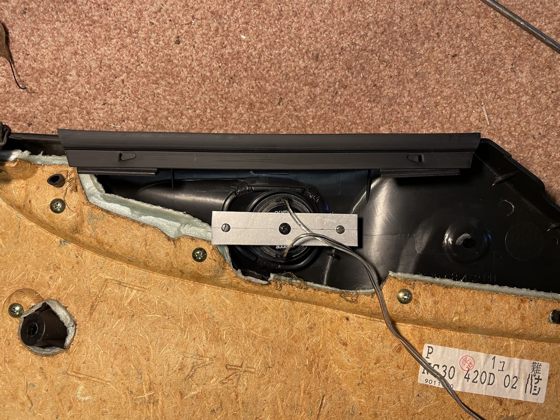

I replaced my door loudspeakers about three years ago. The OEM ones were getting a bit raspy and I settled on a pair of Audison 6.5" diameter speakers, with each kit tweeter in the area at the top front of the door card where the unused grill (in the case of my NB) is. The tweeters fitted snugly in the 45 mm recesses and I secured them using a piece of alloy strip across the mounting posts as shown in the photos below.
A similar high frequency upgrade with yours could perform surprisingly well as the purchased tweeters might include a series capacitor (for low frequency attenuation) for connection to the main loudspeaker wires.
