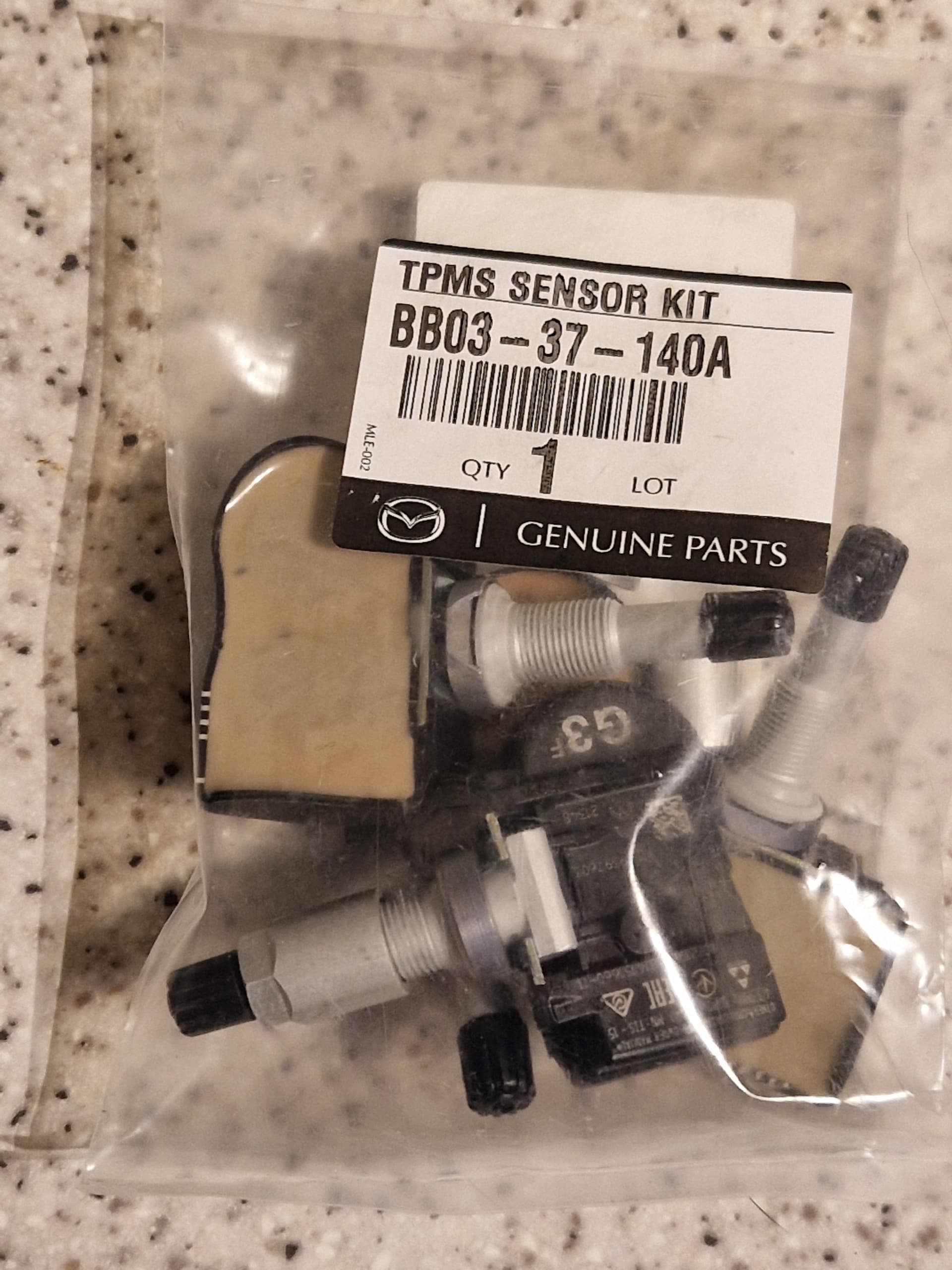

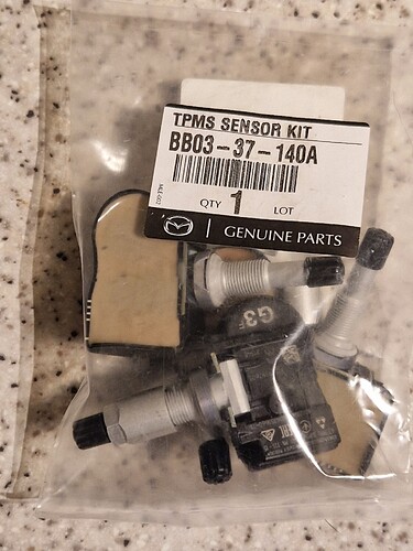

A replacement probably means a whole new TPMS valve. A set of four is about £120 from Mazda, and it’s cheaper than buying Schrader branded valves from a third party vendor. Stick to plastic dust caps.
Can you not just buy one?
My dealer fitted and charged for just one for my spare wheel !

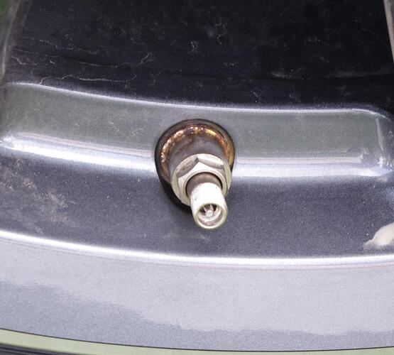

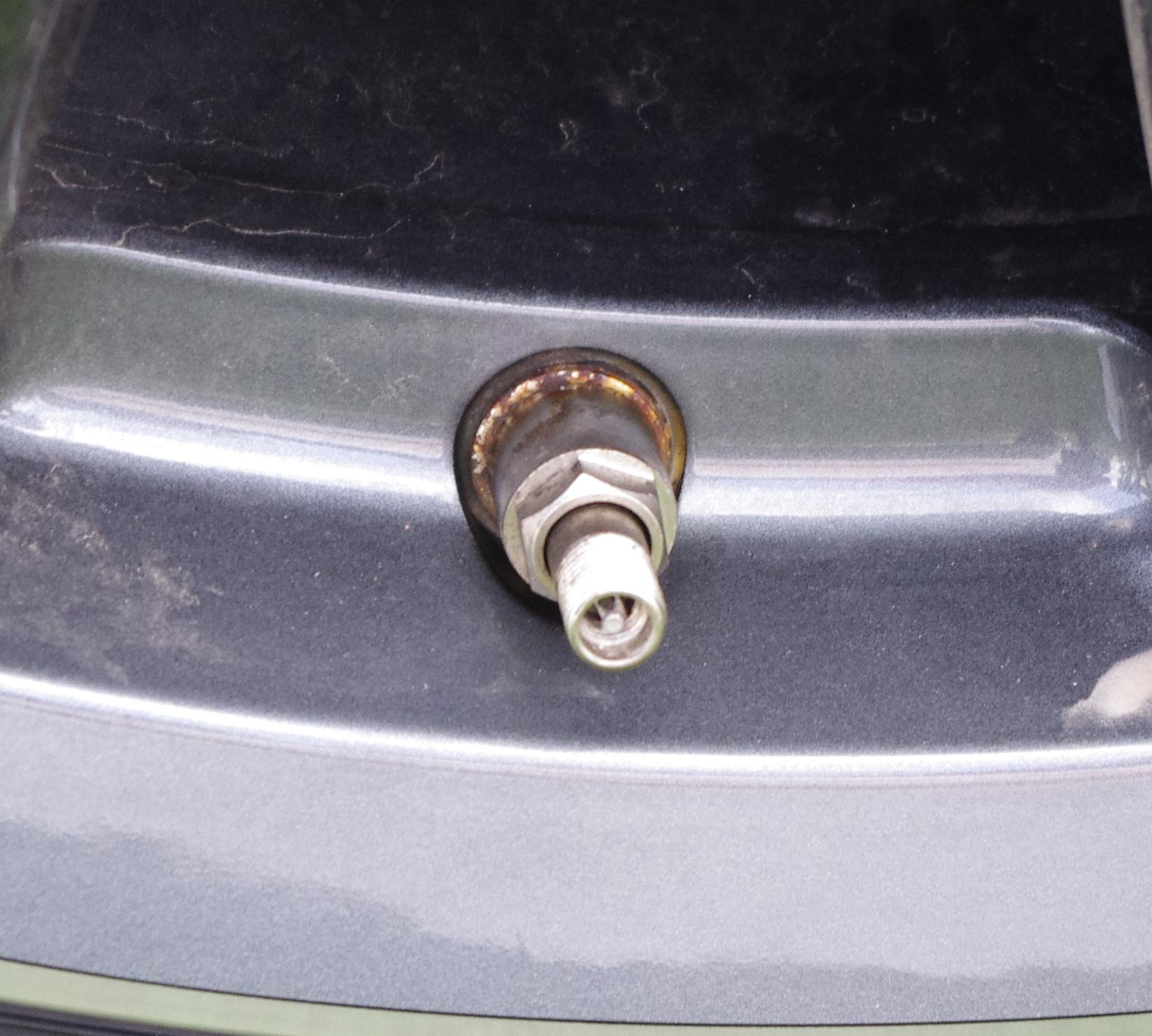

I noticed this rusty metal tyre valve on a brand new ND back in 24/04/2016 at the Spring Rally
All four much the same.
Never mind the dust caps, they are easy to change.
The valve is the seal. The cap is mearely a dust cap to keep out contaminants that can damage the valve. Even if the thread is corroded or partially stripped a plastic cap can still be fitted and is unlikely to come off. A pack of 20 can be had for 99p including delivery on eBay. Metal caps just aren’t worth the risk.

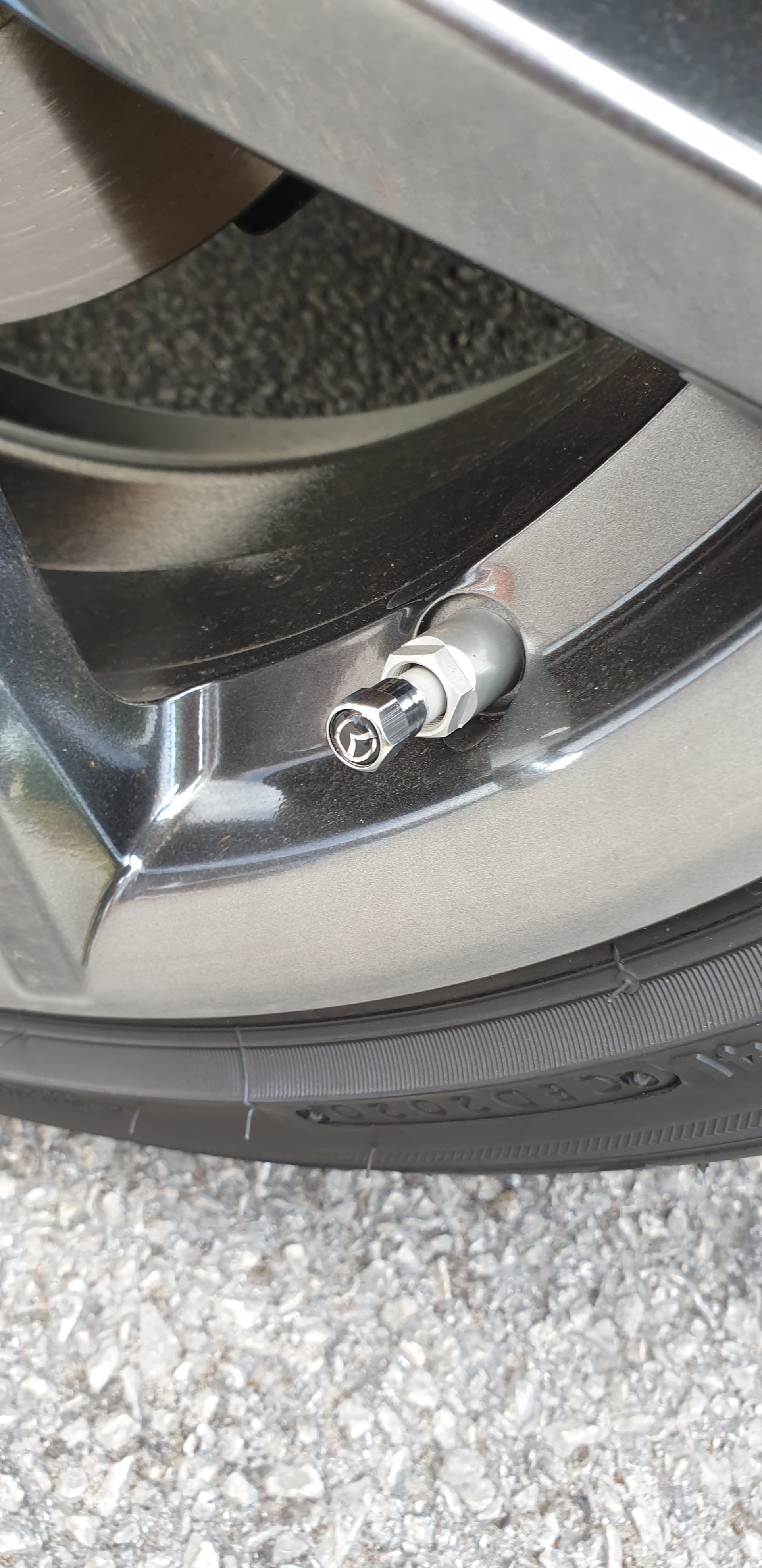

Same problem on my MB, I wrecked one valve and let the main dealer remove the rest which all felt just as corroded on. Plastic caps now rather than the MB logo stainless caps.
