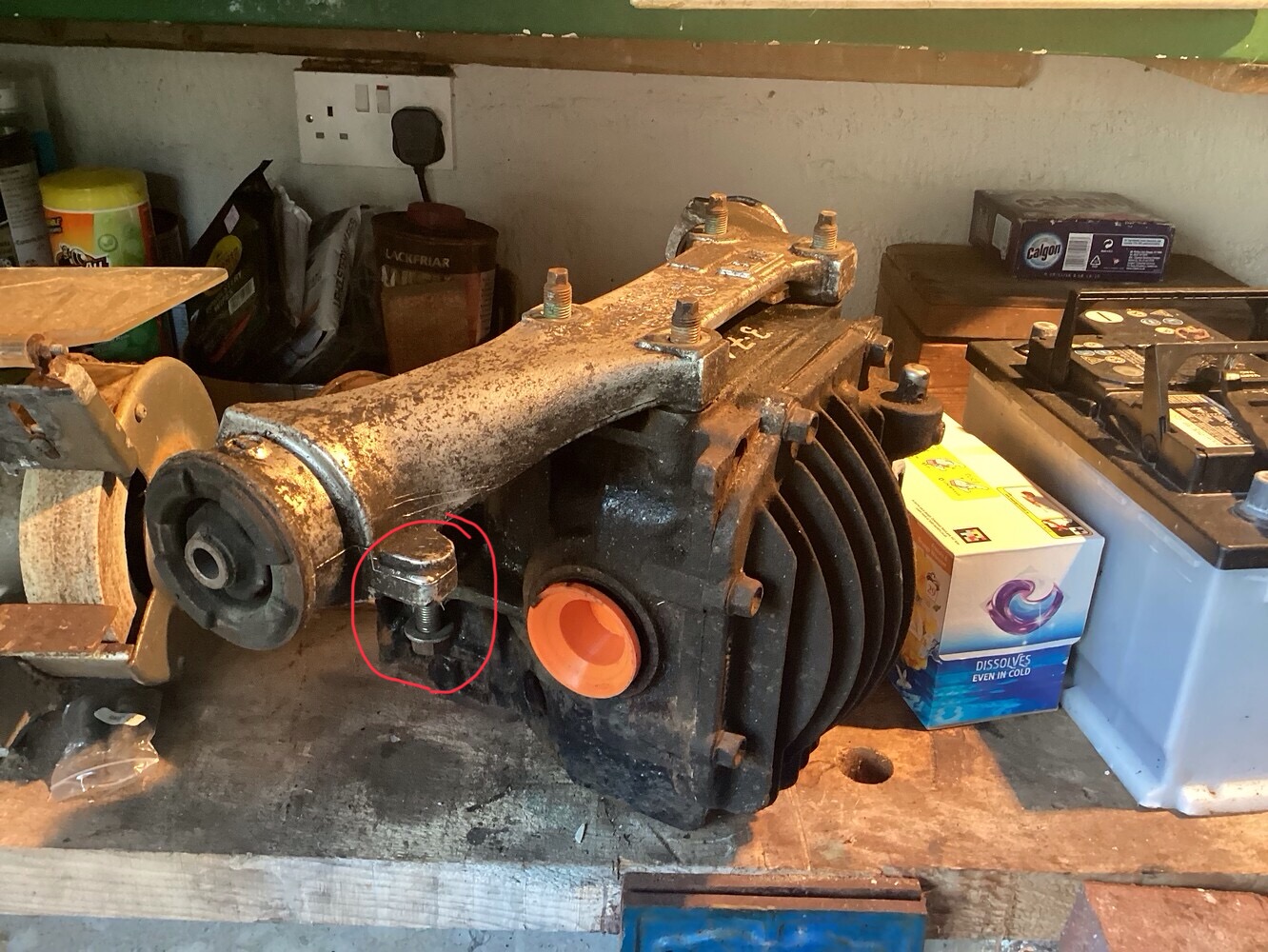

Well it arrived today. How you pack something that is hard to lift is a bit of a problem. The guy had wrapped it in a lot of wool and bubble wrap in a sturdy cardboard box but it’s a miracle it survived . I think it was mostly down to it was too heavy to throw!
Anyways it’s on the bench and just needs to be secured so I can work on it. It’s gross and heavy from the outside but once you get inside it will be all about finesse…

Good luck with your work , What are the additional bolts highlighted in red , not seen these before on a mk3 diff carrier ?
That’s just an accident of the pic. There is no bolt attached, it’s just a lug that’s integral to the casting.
